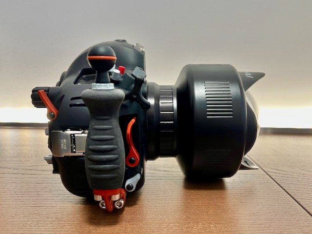

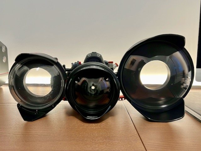

  3. Hi, I've adapted the WACP-C to my Hugyfot D850 housing with the (very well made!) SAGA adapter. The combination fits perfectly and the Nikon 28-70mm works in it's full zoom range, no vignetting observed from my land test shots. Very compact size for a full-frame setup, I'm very happy with it. Not tested in water yet.
    There goes some pictures of my setup:
    Note how small it is compared to the Zen 230mm glass domeport (right) and the Hugyfot 170mm acrylic fisheye port (left):
