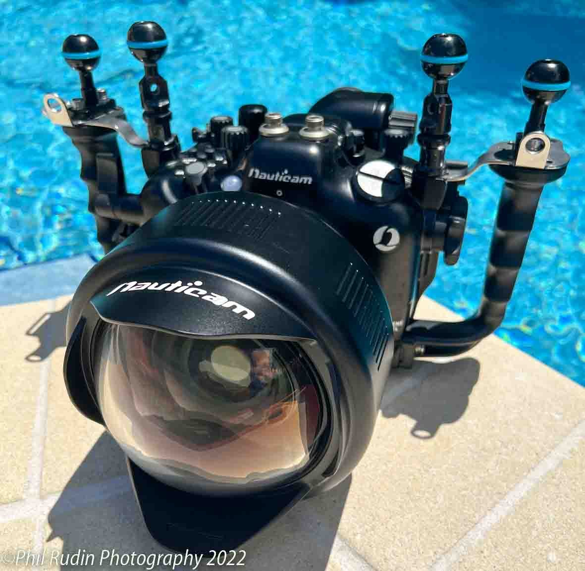

  2. This is WACP-C on the Nauticam NA-A1 housing for Sony A-1. As advertised it fills the gap size wise between the WWL-1B and WACP-1. For me the weight and size difference is noticeable over WACP-1.
    The big difference for me is better overall image quality at wider apertures over dome ports, a wider and longer AOV over any lens in a dome and price. The WACP-C weights almost a pound less than the typical 230mm glass port, uses a smaller port extension for the Sony 28-60mm zoom and covers a range from 130 degrees to 69 degrees.
    If you have not seen the latest Wetpixel interview with Edward Lai he mentions using the Sony FE 28-60mm lens and that they were "astonished" at how good the lens is. He also said that because it is so small it can be used with WWL-1, WACP-C and WACP-1.
    If you do the math I think the WACP-C makes much more sense than buying an expensive F/2.8 or F/4 zoom, then adding the S&S correction lens and a 230mm port to attempt to get better corners.
  3. Thanks @Phil Rudin! That looks like a nicely balanced overall setup on the A1. Like a few others in these forums I’ve used the Sony A1, 28-60mm lens and WWL-1 with great success. I’d be fascinated to see some comparison shots between the WWL-1 and the WACP-C, to see how much of a step up this provides in image quality. I know that the WACP’s corners will be sharper at wider apertures, but what would be particularly interesting is how much sharper/better the centre of the frame is. As Alex Mustard pointed out, any of the WACP’s should theoretically be slightly better than the WWL-1 because the light doesn’t have to pass through the Glass - Water - Glass boundaries of the wet lens. The real question is how noticeable this difference is. If it’s meaningful then I’d look to upgrade. Having said that, I absolutely love how compact the WWL-1 is for travel, so I’m loathe to add more weight and bulk to my kit!
    In previous forum threads, reviewers have shied away from comparisons between the WWL-1 and WACP-1 because it was such an apples vs. oranges comparison in terms of price and size. Now that there are three tiers of Nauticam water contact optics in close(r) proximity of each other, maybe this comparison would make more sense.
