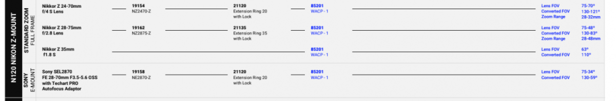

  1. I have a small question regarding Z-lens on the WACP-C
    As the Nikon Z  28-75 f2.8 are able to be used WACP-1 but it doesnt show up on the WACP-C port charts
    Will this be updated or is the Nikon Z  28-75 f2.8 unusable for the WACP-C
     Thank you
  2. The issue is the size of the lens. The Tamron 28-75mm F/2.8 for Sony also works with WACP-1 but not with WACP-C. The bigger issue is that neither of these lenses does a full zoom through. They got from Z-130 to 83 degrees T-130 to 90 degrees. The lens stops extending fully by hitting the rear of the WACP-1.
    Your best lens choice for Nikon Z is still Sony FE 28-70 with Tecart Pro AF adapter for WACP-1 which gives a full zoom through of 130 to 59 degrees.
    With the WACP-C the same Sony FE 28-70mm with the Megadap ETZ 21 Sony to Z adapter gives the same full 130 to 59 degree zoom through. This adapter is a new recommendation which should work with both WACP choices.
    The Z 24-70 F/4 also works at 28-32mm giving a 130 -121 zoom range perhaps the least expectable choice. The Sony lens is still the best choice and can be found widely in the used market.
