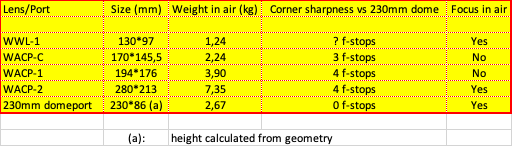

  7. We live in exciting times. I am also eager to read serious reviews about WACP-C. Below a table, where I have added WWL-1 and the regular 230mm domeport to the Nauticam table, for better comparison:
    #1.: I guess that the sharpness in the center is the same for all 5 options and depends on the lens (but is not much of relevance for UW)?
    #2.: Does somebody know, how much f-stops improvment in the corners the WWL-1 will bring (as mentioned above, the numbers provided by Nauticam may. however, not withstand rigorous physical testing on an optical bench)?
    #3.: According to Nauticam, the corner sharpness improvement is the same for WACP-1 and WACP-2. The optical advantage of WACP-2 over WACP-1 is then that WACP-2 provides less fisheye distortion than WACP-1 (and maybe WACP-C (and WWL-1) provide more?)?
    #4.: I could not find info for ability to focus in air for the WWL-1. Since several UW-photographers report that they are using (at a pinch) the WWL-1 for split shots, I guess that WWL-1 is able to focus in air?
    Wolfgang
    P.S.: Table corrected according to Phil Rudin...
    The WWL-1 is NOT able to do split shots properly but does somehow focus in air. It's not very sharp though
    Great summary table!
    Edited by waterpixel
    Wolfgang
    Your chart regarding WACP-2 is not correct. The reason the WACP-2 has a much larger dome is because it works in air as well as it does underwater. So it can for instance be used for splits (best with a pre set focus distance). Second it can be used with higher quality lenses like the Sony FE 14mm F/1.8 which gives an AOV of 140 degrees. Also as with dome ports and rectilinear lenses in general larger domes provide better corner sharpness. It would stand to reason that the WACP-2 at 280mm should have better corners than the WACP-1 at 194mm.
    Thank you Phil, I corrected the mistake...:good:
    Wolfgang
    P.S.: I do not have personal experience with WWL-1, but on several occasions I read that UW-photographers use an O-ring (even sold by a company) to prevent train out of water from the port/WWL-1 interface, in order to be able to make split shots. Seems to work, althgough probably not a very versatile solution...

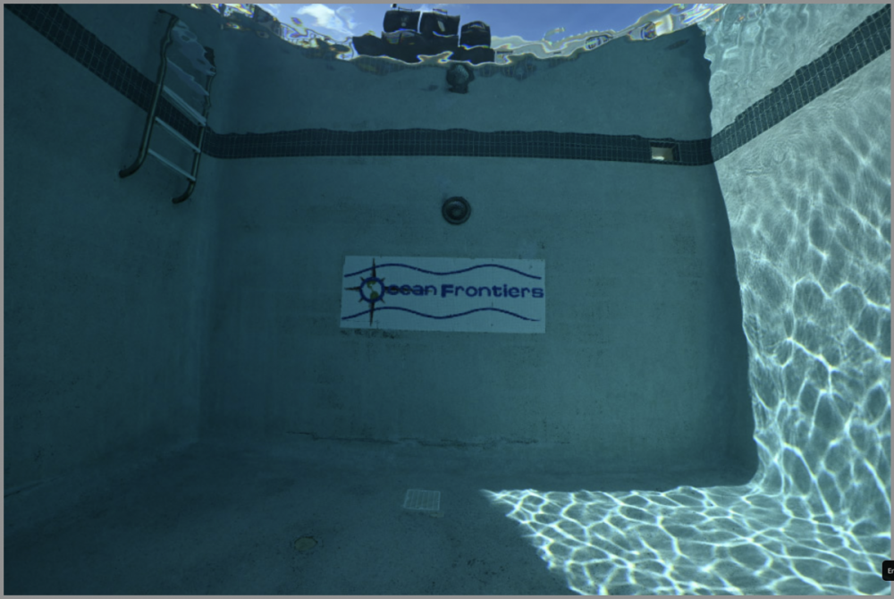

  14. 14 minutes ago, dreifish said:
    Some seem to perpetuate the narrative that the WACP-2 is somehow more linear on the edges than the WACP-1, but I haven't noticed such a difference in the sample images posted. The guys at Reef Photo & Video (who have shot both) also didn't see such a distinction. I believe the optical formula is the same for both the WACP-1 and WACP-2,  just scaled up. So it would be surprising indeed if one produced less barrel distortion than the other.
    I haven't shot the WACP-2 recently, but my memory is that the barrel distortion is a lot lower than the WACP-1. To the point of the WACP-2 feeling totally rectilinear on most subjects (that is, until you photograph swimming pool tiles and you see there is some barrel distortion).
    I have had three people bring WACP-2s on my workshops so far (trips have been rather reduced since the WACP was introduced in 2020!) and all seem very happy. And the pictures always have a noticeable rectilinear feel when they come up in the review sessions.
    Being one of the few who has shot all three in the ocean, my Goldilocks preference is for the WACP-1.The WACP-2 loosing on size/weight/cost, not performance. I find the WACP-1 is not a problem for travel, on the trips where it is needed. I can also see many more feeling that the WACP-C is better for them, their system and their needs. And the same with the WACP-2.
    Alex
    p.s. I'll see if I have any samples to share, to illustrate barrel distortion of WACP-2.
    [EDIT - found a pool shot with WACP-2, not an ideal test shot - but does have straight lines in it - shows minimal barrel distortion]
    Edited by Alex_Mustard
    Alex
    Hey Alex! Do you recall what focal length/angle of view this is at? The barrel distortion seems pretty limited. Course, it'd be nice to have A WACP-1/WACP-C/WWL-1 shot in the same place for comparison :)
  18. Nikon Z7 + 14-30mm @ 14mm (so 140˚ with WACP-2). Shot at f/11, 1/250th @ ISO 200. It was shot for my interest, not as a controlled conditions test.
    Alex
    There is definitely a good amount of distortion considering the wall is far. The proper test is to measure a grid at close range as the effect is amplified.
    I did it sometime ago with the WWL-1 that perceptually does not look bad at long range and the amount of distortion was colossal
