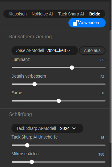

My personal “sweet spot” is to use both, NoNoise and TackSharp. For NoNoise, I set luminance to 65%, detail to 23% and color to 50%. Tack sharp is very aggressive and I only add it in to give a small “touch-up” at 15%. There is another slider called “microsharpen” and I tend to leave that at the default of 100. Like this:settings_On1.jpg
If the contrast is too crisp, I reduce the microsharpen value (to 50 or even 30). If I am disturbed by AI artifacts I first reduce the TackSharp to 10% and then if necessary the detail to 15 or 20%. Usually that is enough. I use either an Olympus E-PL5 or an EM-5 (the first model). Both cameras have the same sensor, so the IQ is the same. And they certainly benefit from modern processing software.

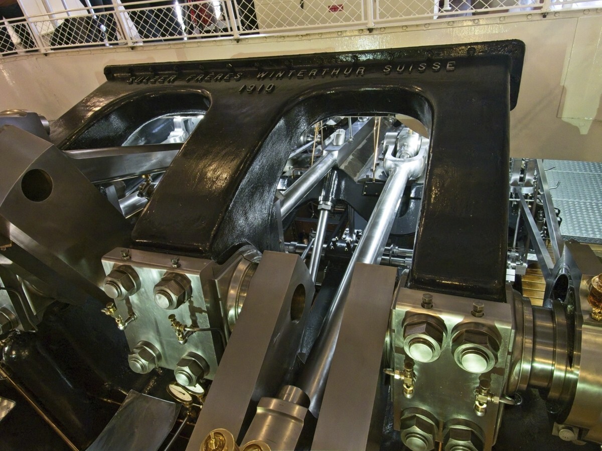

And now an image of the steam engine inside the boat, this was taken at ISO 6400 (full image is AI-processed):
Here’s a 100% crop with no noise reduction applied. Not bad at all, I think – considering it is a 13 year-old camera model.
