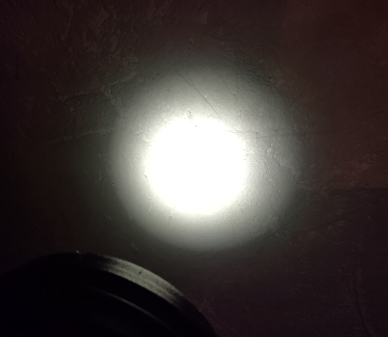

Some more infomation
The idea is to dispatch the light generate with the flash to avoid a hot point (circle with my retra) And for the Retra Maxi the 2 line (i'm still waiting for it ;) )
B ) a fresnel lens to concentrate all the light on a disk C
C ) a glas
D) a normal glas, or a lens test are not finished
C & D are all 50 mm diameter glas + lens
Between C and D I can put an try some diffrent lenses (focal lenght and type of lenses)

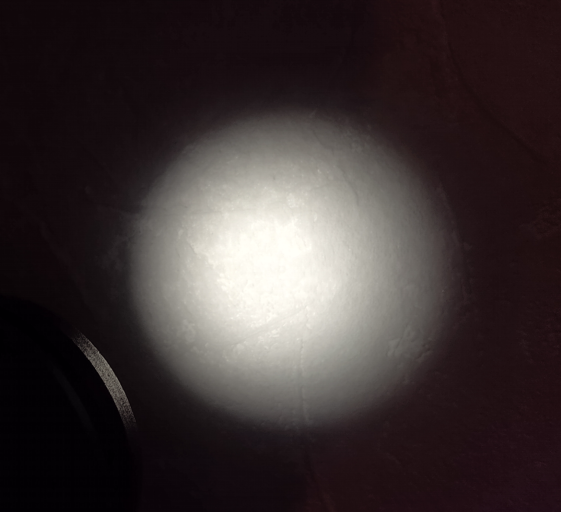

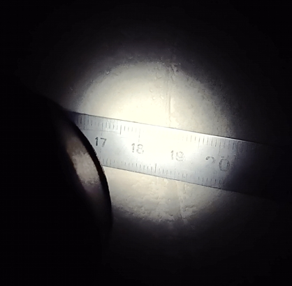

  • Author
20 cm from the wall diameter of the light 20 cm
10 cm -> +/- 10 cm
5 cm -> 7-8 cm
This picture are with the retra focus light first power level

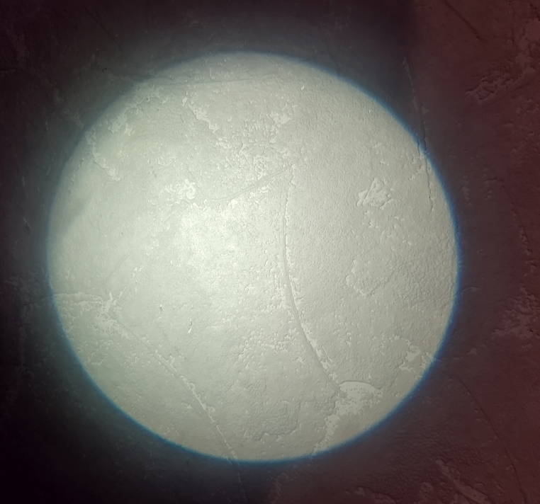

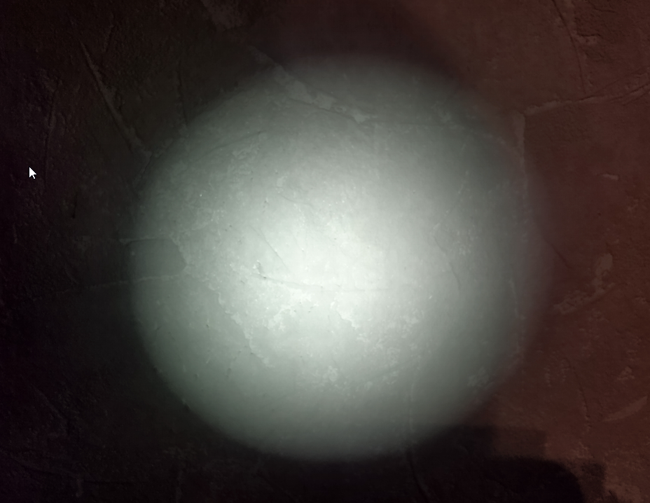

  • Author
With one extension and a lens in it (not strong magnification)
An other experimentation
Now I need to try other combination, make some small extension to find different size of light, edges, types
After that the step of mount all this part with silicon an epoxy before going to test it underwater.
  • Author
The snoot is shorter as the previous 15 cm and also lighter. With the volume it will be positive under waterand with a carabiner can be attached where it will float and did not disturb anything.
I will probably make in a second step a small extension with a diaphragm in it to have the possibility of changing the size of the light.
The main changes in the new snoot is to bring a maximum of the light from the strobe to the ouput the different lenses concentrate the light step by step in the midle.. This will reduce the power need of the strobe. and with more power I will be able to shoot at F22 to increase the deep of field on very small subject.

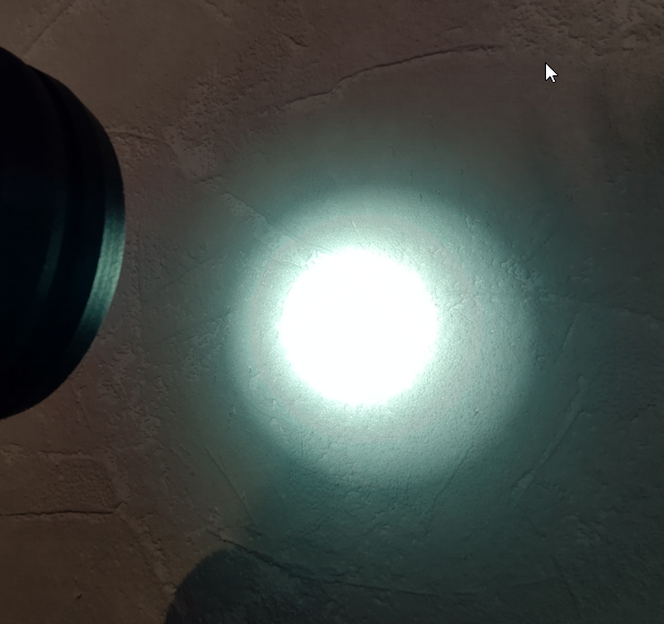

  • Author
Hi
The project is one step futher.
I sealed the lens and glass with silicon. After that I glued the pieces together with epoxy and cover it with epoxy to ensure that no water is going in the snoot.
I screwed the 2 part together.. there is an O-Ring. That is the result.
As you ca see there are no reflexion the circle is clean
