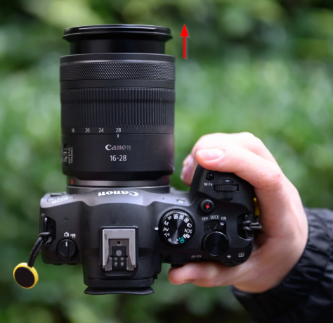

In fact, this new Canon RF lens retracts when zooming from 16mm to 28mm.
At 16mm:

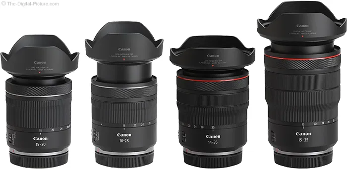

Mhhh,... the new RF 16-28 is not on Optical Bench Hub yet.
But I can tell you from testing and owning it, that the RF 15-30 IS STM is still the queen.
It moves it's entrance pupil by just 5,67mm while retracting backwards by 8,68mm when zooming from 15 to 30mm focal length.
The physical retraction on any lens is usually just a minor issue, as long as it will not hit your front dome.
It rarely does with wide angle zoom lenses.
The inner zooms also move their entrance pupil, they are just hiding the obvious from you.
