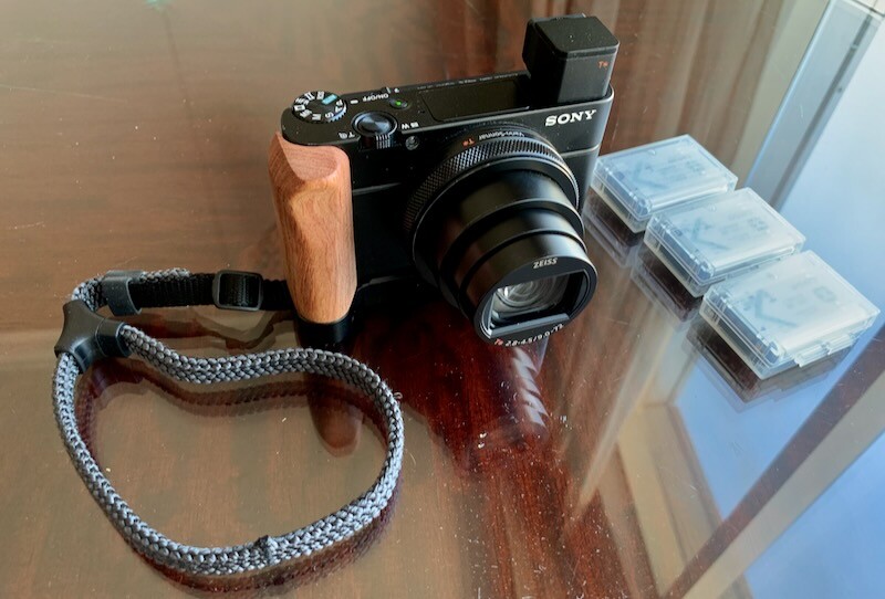

When I used compacts notably the Canon G7X II and especially the Sony RX100 VII one feature on these fixed lens 1" sensor cameras was their built in digital teleconverters.
The Canon G7X II allowed me to get a sequence of a humpback whale jumping at the max tele-converted range but the pics are only really usable for social media / online.
By contrast the small Sony RX100 VII has a built in teleconverter that doubles the optical 200mm long focal length to 400mm. It worked great partly owing to the AF in the Sony RX100 VII (being the same as the Sony A9 dSLR. I think.) It had limitations only applicable on JPEG format and Single Shot. But still in Africa I made pics I was really happy even making some large prints (13" X 19")
