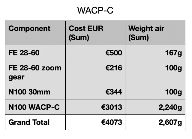

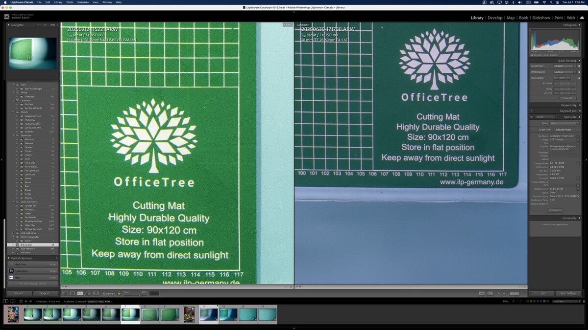

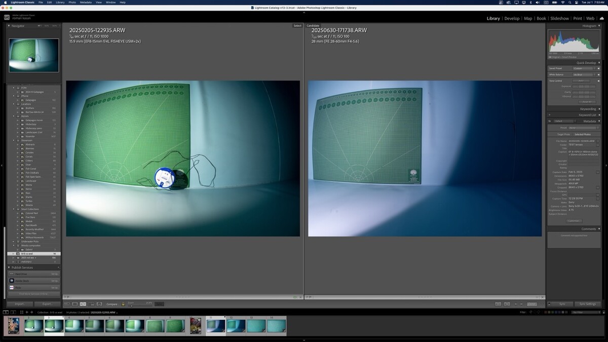

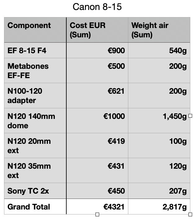

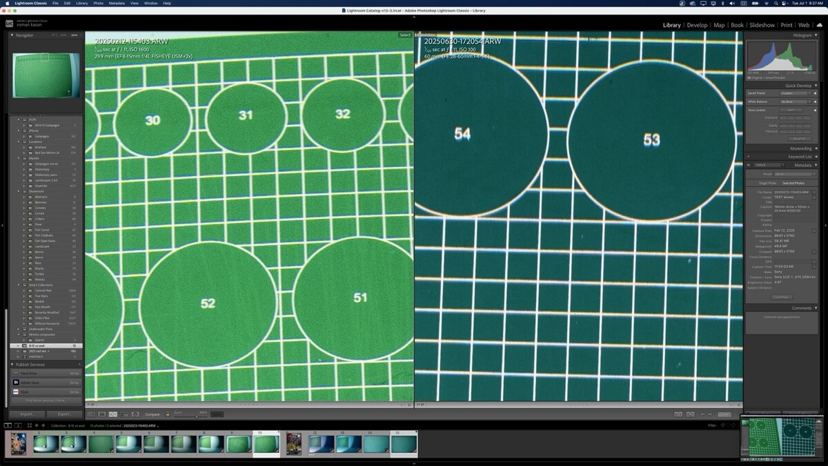

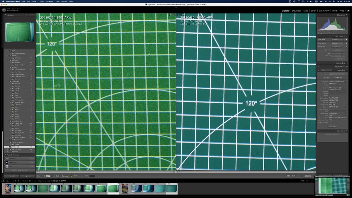

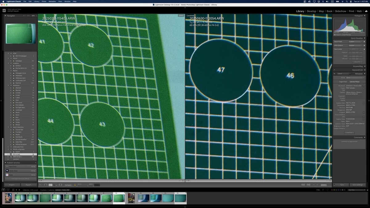

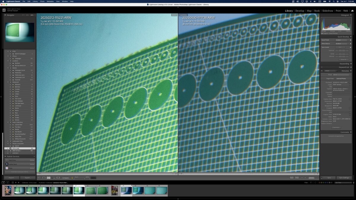

Before leaving for Indonesia tomorrow I was able to do a quick comparison between my new addition WACP-C and adapted 8-15 the photos of which I made back in spring. Disclaimer is that WACP samples were done with the strobe at ISO100 while for 8-15 I was using video light at higher ISO and so the results might not 100% comparable. Will reshoot when I have time.
First the costs and weights of both systems (8-15 quoted at used price level):
Screenshot 2025-07-01 at 7.17.31 AM.jpgScreenshot 2025-07-01 at 7.17.39 AM.jpg
Both systems are kind of neutral-ish buoyant in this configuration:

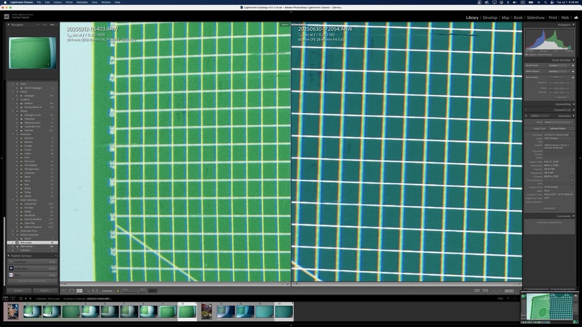

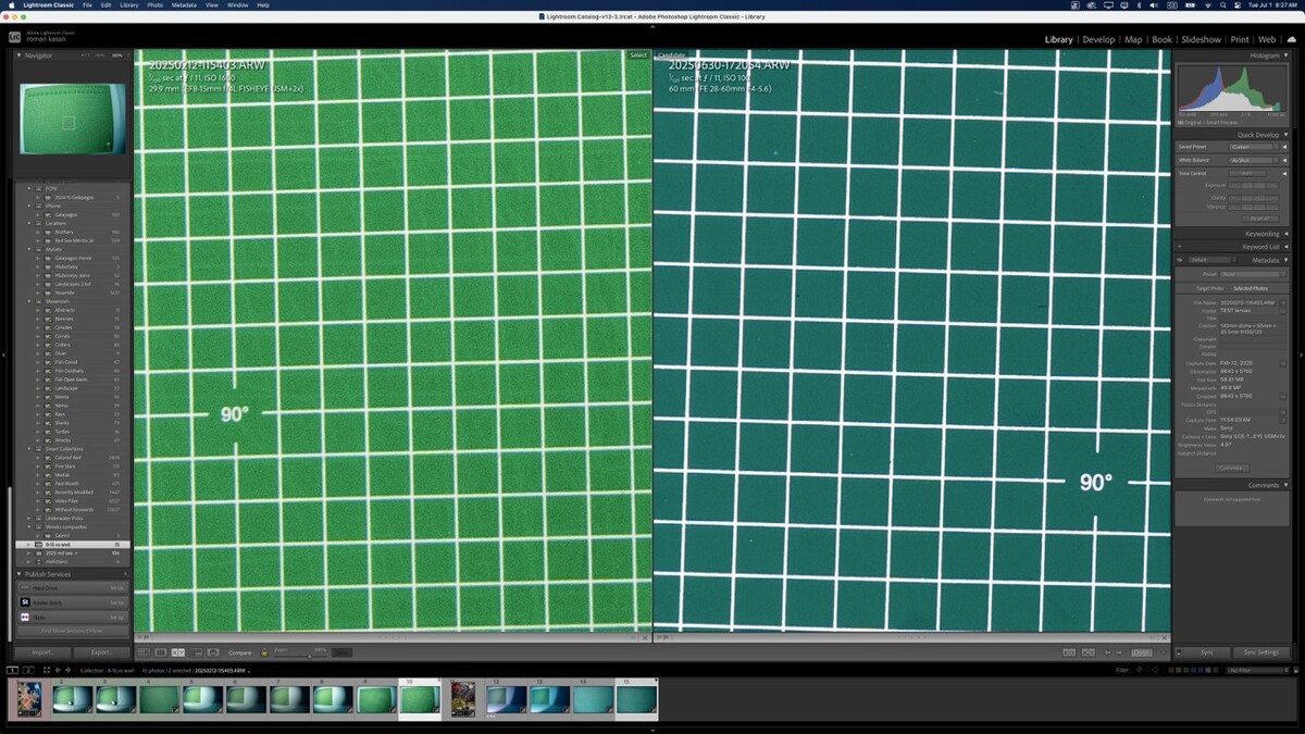

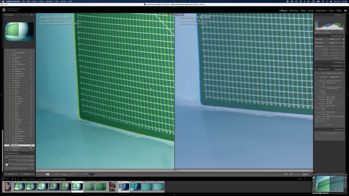

The following screenshots have this system: first Fit view followed by 300% comp view with rectangle at left upper corner showing the part of the frame compared.
As I stated earlier I picked up samples which showed good focus for 8-15 as weaker light and also shutter speed without flash sometimes produced unfocused images. But these I think were sharp in the center and so let's get on with these.
8-15 TC2x in 140mm dome 55mm+35.5mm N100/120 vs WACP-C both F11:

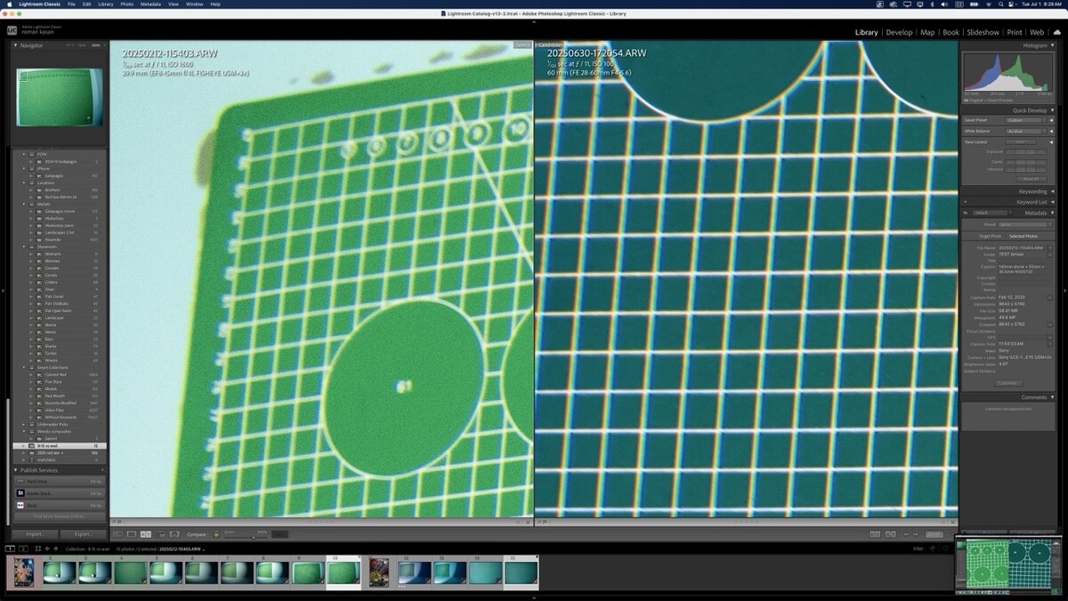

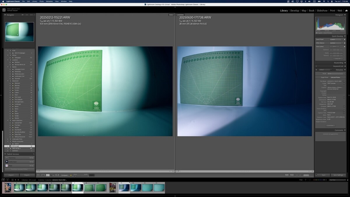

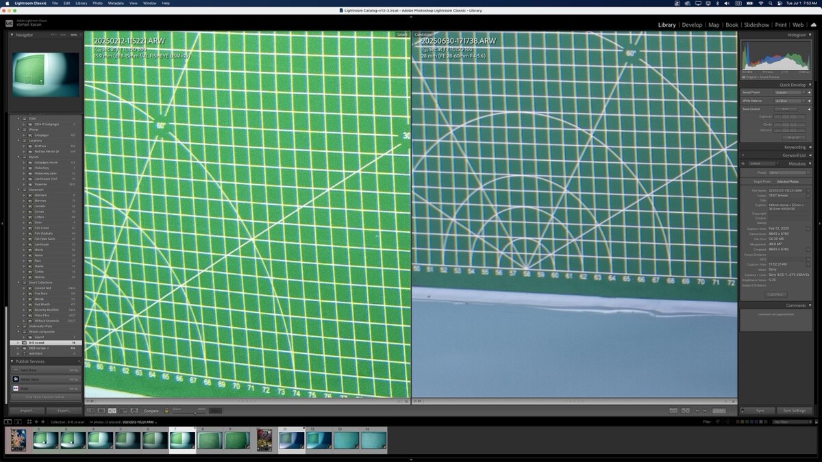

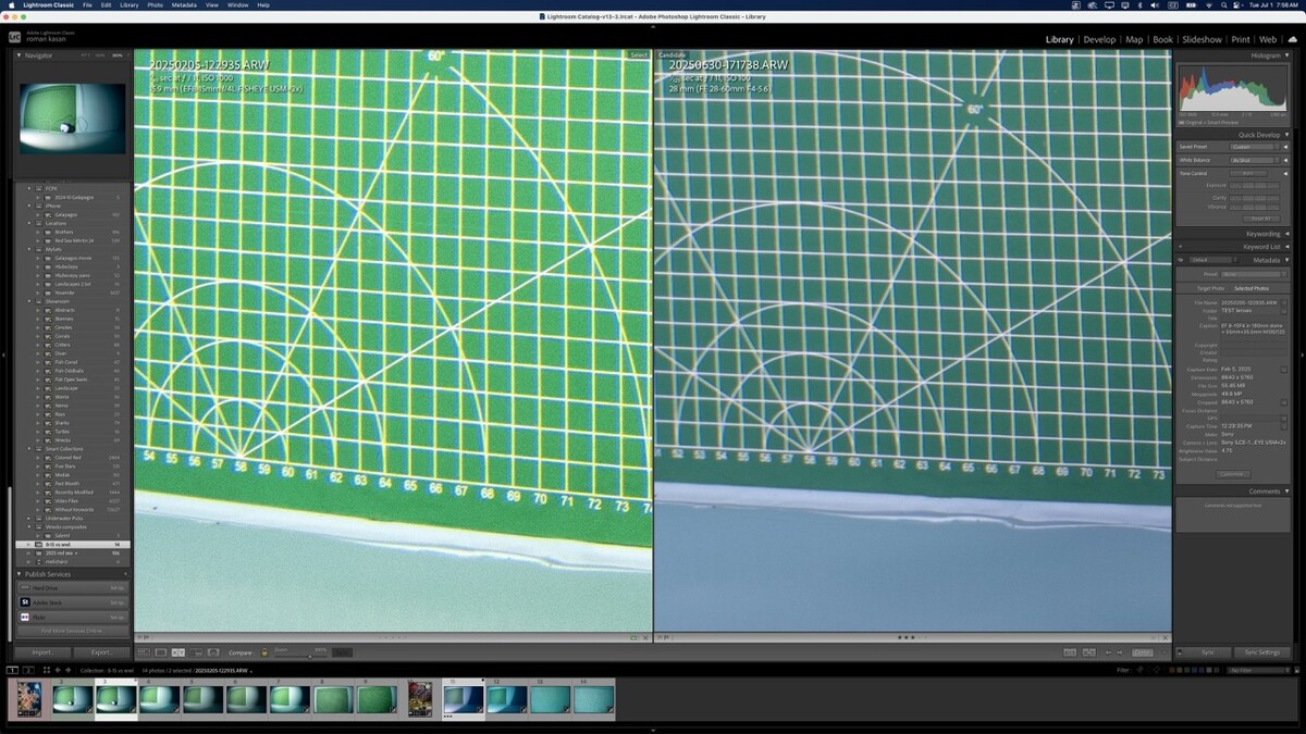

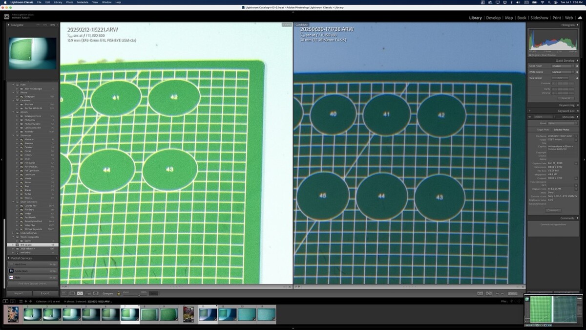

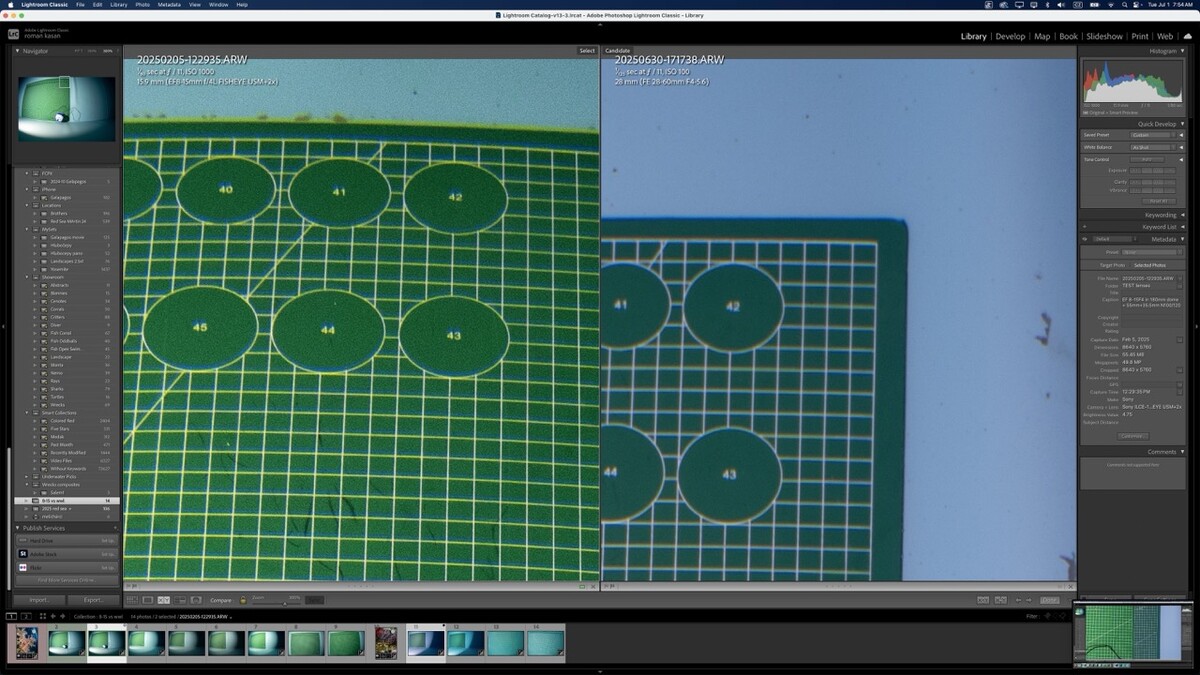

... and 8-15 TC2x 55+35.5 in 180mm dome vs. WACP-C 28mm:

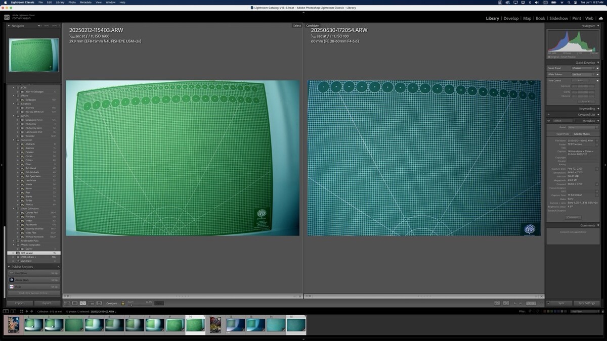

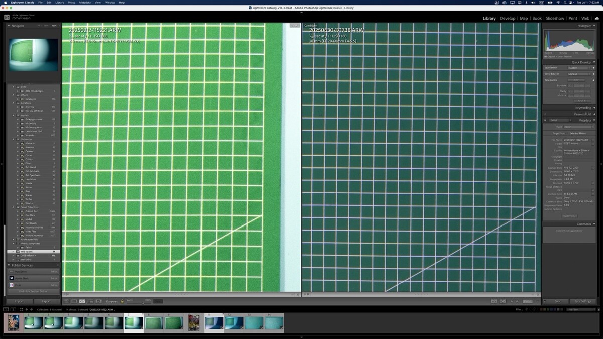

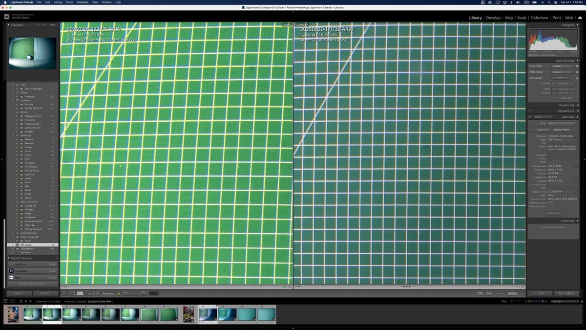

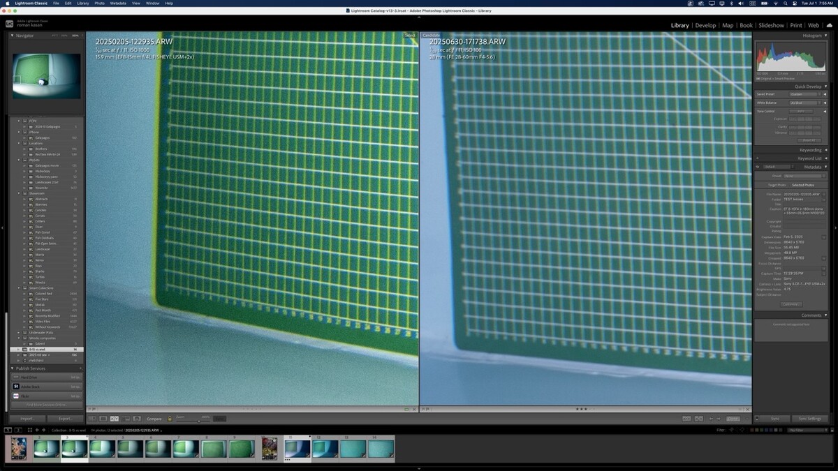

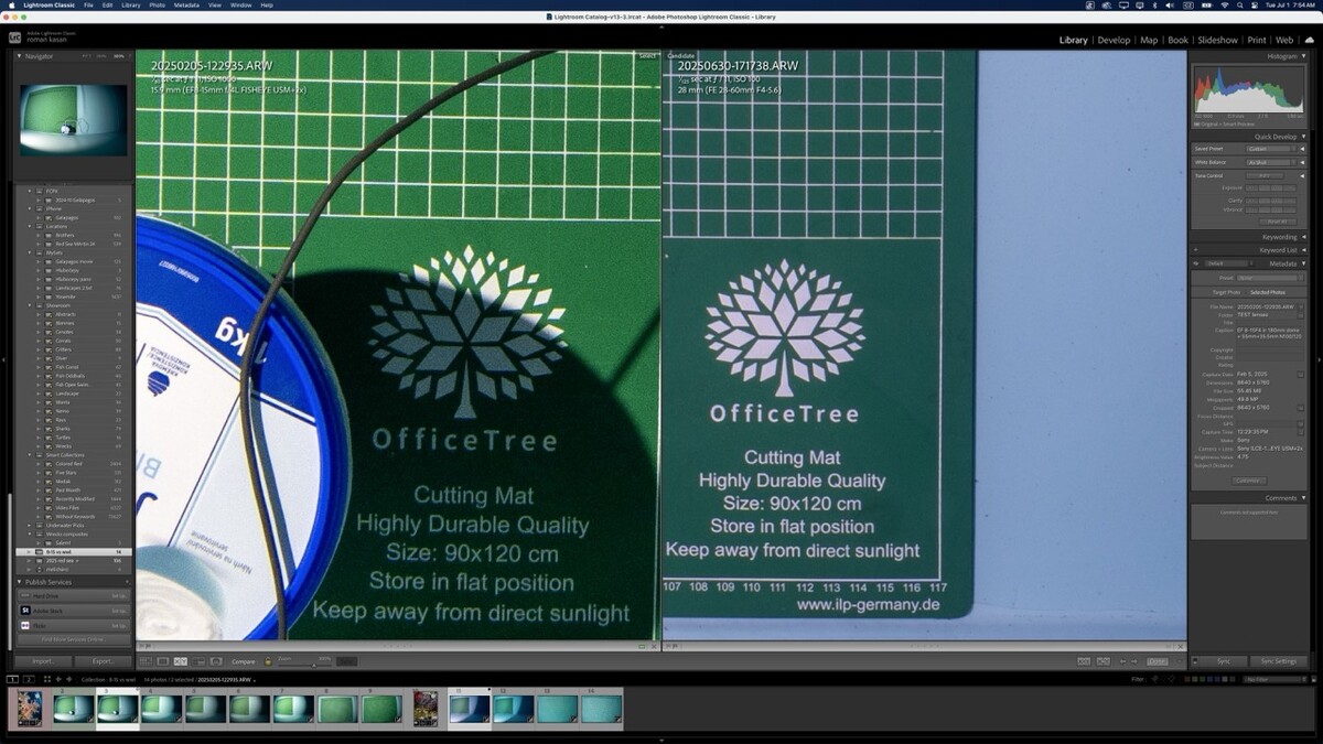

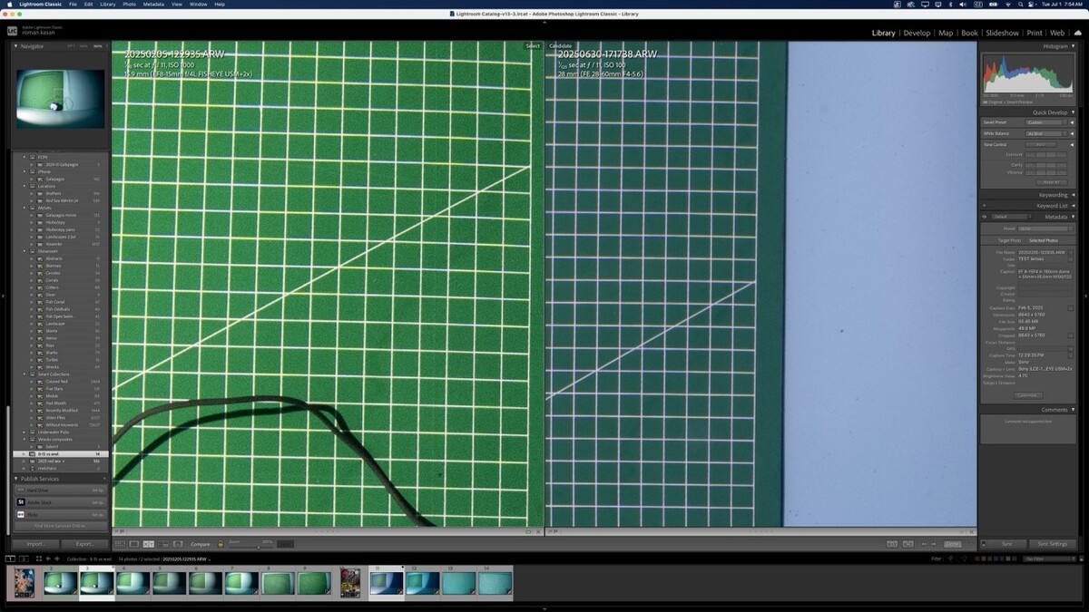

And finally 8-15 TC2x 55+35.5 in 140mm at 30mm vs WACP-C at 60mm
I am very happy with performance of WACP-C especially at 60mm as this is what I would be using for smaller subjects and crop heavily on 50Mpix image.
I will leave conclusions to yourselves :-). For me I realized that 180 degrees view is not as important as the DOF and native AF lens performance which doesn't mean I am going to sell 8-15 combo - yet. Cheers :-)
I think not exactly apples to apples comparison, this tests out the sharpness but does not consider the barrel distortion which tends to pull the subject forward in the frame in comparison to the edges. This effect becomes increasingly less obvious as you zoom in. @Alex_Mustard has chimed in when I have been comparing fields of view between fisheyes and other lenses with this observation on a number of occasions
Counting squares in the centre crop looks like the image scale is 1.16x for the WACP at 60 over the 8-15 @ 30mm which could be handy for some marginal objects but with MP available I think hardly noticeable in details captured. Interestingly my calculations say almost the same thing 1.16 vs 1.17 image scale factor.
To me the 8-15/2x combo has sharpness advantage in the corners at least at the wide end (just really looking at the 140mm - the 180mm as expected is a little worse).
  • Author
just a side note - the pad was not photographed from the same distance for presented scenarios so the number of squares in crops and their size is meaningless in comparisons. the purpose of this comp was sharpness and rendering, perhaps CA, - not distortions or magnifications.

Thank you for these industrious testings, RomiK... 👍
From your test photos under controlled environment, I conclude that the 8-15mm/2xTC/140mm combo is at least as good as 28-60mm/WACP-C, maybe even a tick better (you agree?). The differences are subtile, I am glad to see that the 8-15/2xTC combo can keep up with modern wetlens solutions...
I derived to similar conclusions based on my own photos, but these were just UW photos of different subjects at different times and conditions, by far no control...
#1.: Concerning your listing of costs and the Canon 8-15mm combo, I think it is fair to add that the N100/N120 adapter, 140mm dome, both N120 extensions and Sony 2x TC are universal and can be used for various other occasions, both UW and OW as well (even the Canon 8-15mm with Metabones is fun to use over the water)...
With the WACP-C combo, one is left with a bold chunk of optical glass that is dedicated to its purpose plus one universal N100 30mm extension and a mediocre 28-60mm lens (o.k. the charm of the 28-60mm lens for OW use is its size, but I personally prefer the Sony 20-70mm that is bigger, but still not excessive, and provides clearly better IQ, both OW and UW)
=> I would say one gets a lot more with the Canon 8-15mm combo (also the 180° diagonal FOV, what the WACP-C cannot deliver) for a simlar amount of money...
#2.: I am surprised to see that the Canon 8-15mm performs optically better behind the rectilinear 180mm domeport, compared to WACP-C, maybe even a tick better compared to 8-15mm behind hemispherical 140mm domeport. This is completely unexpected for me, but in line with my observations when I used the Canon 8-15mm behind 140mm and rectilinear 170mm domeports with MFT cameras, where the smaller sensor scans only the central 25% area within the image circle. IQ with 170mm domeport there was at least as good compared to the 140mm, if not better (just comparison of regular UW photos, no controlled environment)...

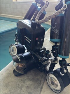

I use an Isotta housing with an 8 inch polycarbonate dome (about 500g lighter than the Nauticam 140mm and needing less floatation). I can use the same extension and dome for both the Sony 20-70mm and the 8-15mm with 1.4. It means I can swap the lenses out on a multi-dive day small boat without changing anything about the housing, extensions or port. For example in Palau, changing from the 20-70 for sharks, turtles, fish portraits and people photos, to fisheye for the big wall, reef scenes and schooling fish pictures. Very handy and a good travel combination. If the dome gets scratched there is a good chance I can polish it so not as nerve wracking when other people handle the housing.
I also like the versatility of the 8-15mm being able to use it without a teleconverter in a 4.5 inch fisheye dome for minimum housing size for freediving.

I would like to point out that this Calculation for a native Canon shooter and MARELUX target user runs much more affordable and lightweight:
Canon EF 8-15 FE: 600-750€ (used) / 540g
EF-RF Adapter: 89€ / 109g
Kenko 2.0x TC: 190€ (used) / 166g
Marelux 60229 Zoomgear: 209 € / 48g
Marelux 51406 Zoomgear: 209 € / 66g
MX 30mm Extension: 319 € / 250g
MX 50mm Extension: 339 € / 340g
MX 140mm Dome: 1369€ / 754g
= 3324 € / 2273g
Let‘s you run the system with and without Teleconverter.
Note that you cannot buy the 8-15 lens and Kenko Teleconverter new anymore. They can be found in the used item market. I have friends which were able to get their hands on a pristine Canon 8-15 fisheye for 550€.
You may even shrink this down by not buying the parts you need for running the lens natively with zoom to make it more comparable vs. the FCP or WCAP road.
So for Canon RF Users it’s actually a no-brainer to go and get this setup. And the sentence would go,..
