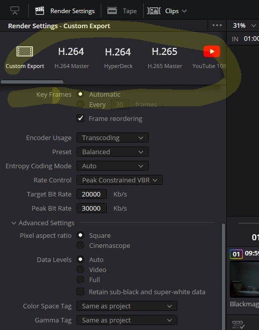

I'm struggling to figure out how to send videos via FB messenger. Sometimes it works and sometimes it doesn't - both from the messenger app on my phone and from my laptop (no app). MP4s seem to be the issue, mov files send but they are so big that creates another issue. Signal never has these issues 🙃
After trying to trouble shoot it, I thought it was because somehow I had created & exported a 60fps video but FB only supports 30. So I tried to redo it at 30 and 24, both by creating a whole new project with those settings and by just changing the setting from the 60 at export ... still won't send. This is the little video - it's tiny.
Can someone help me because googly isn't solving my issue!
  • Author
yes to da vinci. I'm not sure what you mean by preset? on export I choose mp4 (or quicktime for mov) H265? I wish I didn't need to use FBmsg but sadly most of my friends use it!
  • Author
Super, I'll try that, thanks!! In all my reading, I saw something about h265 and clearly did not understand it enough to consider it as the problem. So much to learn.
