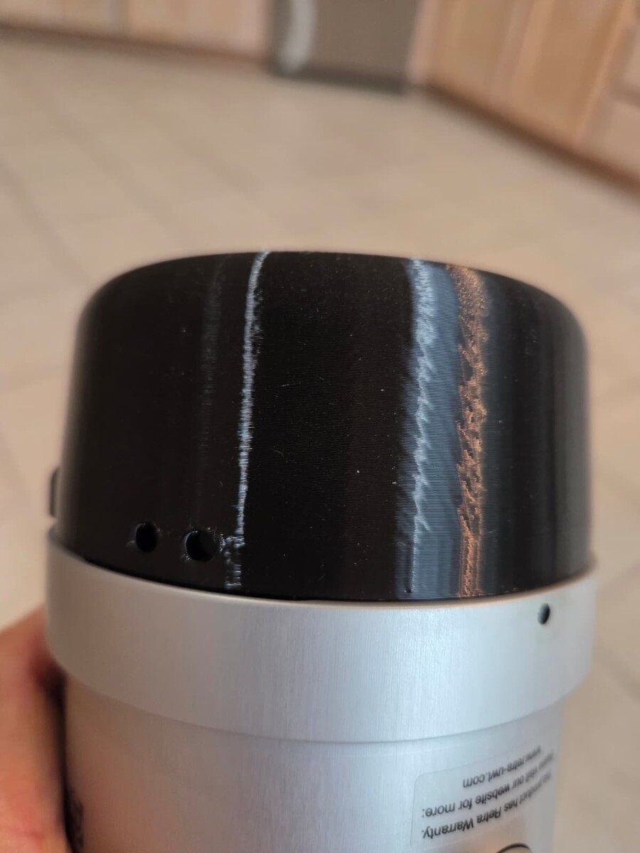

Like jjmochi, I just switched from Inon Z330 to Retro Pro MaxII. Caollla was kind enough to share with me his 3d print file for reduction rings. They fit perfectly and I found them great for blackwater diving.
If you can share the 3D files that would be amazing!

I have this part
It is a protection and with this I can put the Retra on a table without that the glas is touching. It's also large that's mean I can make wide angle without losing light on the side.
@Hiloboy ask me for a simple "snoot" I build one without testing it.
I'm right know make some test with an adaptation of this one..
That's a picture from @Hiloboy
and the model
and here the protection on my old retra pro
You see it's realy wide the beam is not restricted
the model I made and printed for testing is this one
Th e idea is putting some reduction in the tube and why not some extension with lens in it.
BUT there is a BUT with a lens when the distance is the focus length the light is like a donut because the tube of the retra a circular.
I need to but a diffusor on the retra side...
and one or more lens to focus the light on one point, small disk
I had some problerm with water comming in.. need to build a new one with some changes... but no time at the moment to many work.
The last "snoot" is for me a simple and light snoot that cost nothing other as a little bit time to print I will try it during the next trip.
