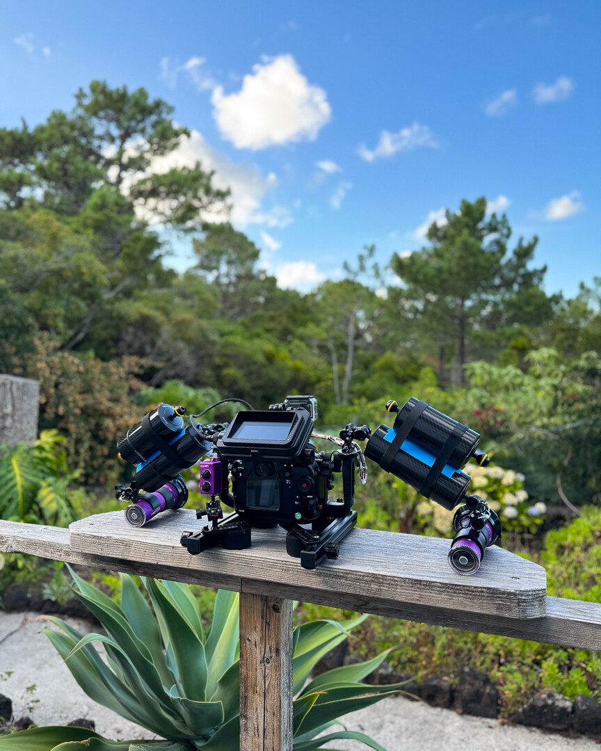

Hello,
I built myself a trim system for my Nautical Nikon Z8 housing. It consists out of two aluminum profiles and a few amazon aluminum cheese plates. The goal is to have neutral rig with adjustable trim (with small weights on a sled), so I can do some tilted shots against the sun and so on. The profiles are that long on the rear end, because of the 6inch monitor, so I have enough space to mount ist perfectly for alle my needs. An additional benefit is that I can put my camera down, without the hazard of scratching the housing. There is a rubber boot at the bottom of the profile. The products you can buy are too expensive and sometimes too small. I tried to keep everything as close to the housing as possible to mimic a bigger cine housing. What do you think?
Daniel
Edited by danka94
Wow, that looks very nice! I'm really curious as to how it will handle, especially with the photo-style flexitray handles close to port.
Do you mind linking to the material you've used, and the weight system that plan on using for trim?
cheers
Beautiful work. I am looking forward to hearing how it works once you get it in the water.
I am toying with ideas on how to mount my monitor. I looked at the Nauticam PN 17951 but they don't seem to have a version for the SmallHD monitor that I have, so I think that I will have to come up with my own. Right now, I am using a ball mount in the threaded hole at the right front, but it tends to loosen up, and isn't in a great spot.
  • Author
Hey, thank you for your nice comments, i try to answer everyone in this posting.
@bghazzal I used this:
2x400mm https://www.innovalu.at/de/30x30mm-schwarz-eloxiertes-aluprofil.html
10x
https://www.innovalu.at/de/nutenstein-M6-nut-8.html
2x https://www.innovalu.at/de/profilgummiauflage.html
4x https://www.innovalu.at/de/endkappe-30x30.html
I think the weight system are going to be trim weights from a small camera gimbal. They have like 20g each and a thread on one side, so I can directly screw it into the T-nuts.
@SwiftFF5 Yeah that‘s the next thing I have to consider. The monitor mount. I am thinking about a small profile, the same I used as the sleds and then a ball mount into the T-nut.
@Davide DB Thabk you :) The monitor mount is still a thing I have to think about. I bought a 6inch Fotocore monitor, which has a thread in the back. Maybe I find a sleek solution, as i mentioned a few sentences above.
The weights are going to be trim weights from a small camera gimbal. Something like this: https://www.smallrig.com/de/smallrig-counterweight-kit-for-dji-rs-2-rsc-2-selected-zhiyun-gimbals-3125.html?skuId=1517092352715550721&gad_source=1&gad_campaignid=21452025728&gbraid=0AAAAA9ksdxnnV3mUnnX4AgHUGDQ4xJUHd&gclid=Cj0KCQjw64jDBhDXARIsABkk8J7JMMawtmDLSQLNOzEJmcCwaDykZwWx--88QyH6l9RYFRgWSh2jWeYaAvEdEALw_wcB
Yes tripod legs, like I saw here in the DIY forum with ball mounts and carbon arms are possible on the inside of the profiles. If i use spacers on one side, I can flip them and store them perfectly below the housing.
@Tom Kline It may looks more elegant, but I still have to test it ;) But I love your pole cam setup!! It is really great. What do you use as a pole?
Looks like a great project, presumably the idea is to get the rig neutral and move the weights to change from horizontal trim to pointing up/down. It's an interesting 3-dimensional balance problem, the weights/housing want to stay at the bottom and the floats want to stay at the top so it takes increasingly more torque to twist the whole rig to point upwards. I discovered how much using about 1.4kg of floats on my strobe arms with my rig - it was close to neutral but did not want to point up. The point is if your angles are small then it won't take much to change the trim but pointing something like 30-45° up will be more of a challenge. If you increase the weight of the balance weights to assist you need more buoyancy up top which makes things worse.
I faced a similar issue balancing a fork-mount astronomical telescope - they work best if well balanced and you can point them anywhere in the sky and they will stay with only slight friction on the clutches when done properly. I had a smaller guide scope piggy-backed on top and to achieve balance I needed weights equivalent to the weight of the guide scope on the opposite side of the main scope and a much smaller sliding trim weight.

@Chris Ross Your input is very interesting. When I started with this project a few months back I thought about the difference in putting floats on the strobe arms or bowl the camera. I think there are a few kilos negative I have to balance. The space below the housing and between the rails is perfect for a custom flat foam block, to generate lift from below and not pulling from above.
Fortunately I have a glass dome, so it is a little front heavy and the monitor in the back is going to pull the whole rig back. Unfortunately I still don't have my lights yet and no time to really test is before the next trip to the Azores end of August.
But I am definitely going to follow your ideas. Balance the lights to neutral, the buoyancy still needed will be split between a bottom foam block and some buoyancy arms. With a little bit more on the top. Do you think it is better to leave it slightly positive and then add the trim weights or balance it with the weights and then the trim is easier to archive?

Hello everyone,
I posted my initial plan to build a Nauticam trim sled with aluminum profiles a while ago. In August/September I was on the Azores to test the final setup. It was heavily positive, but I could fix it during the first check dive. The 6inch monitor is honestly the best thing. You can see everything from every angle. During the shark dives it was great to have one eye on the monitor and the other one on the sharks.
The aluminum profiles worked great. We had some rough sea and the tray protected the housing from too hard bounces. I swapped the nuts to 3d printed ones, because they were rusting. Also the float situation is not great. I need to design and print an holder for the two buoyancy arms on each side. After some of you guys said that I should balance the floats, I put some of them below, but the bigger part on top. The weights on the sled were also a DIY quick and dirty project. This one needs proper lead weights with a proper screw, but the trim worked underwater.
All in all it is a great setup, it is still a little bit positive, but nothing a few lead weights couldn't fix ;) The Keldan wireless remote is a funny gimmick and keeps me radius small, so I don't have to reach that far to change the light output.
The dives in the Azores were absolutely great and almost 4TB of data wait to be edited haha
If you have any questions just write me a :)

The problem is the monitor. It is almost 1kg negative in water. I 3D printed a bridge for the floats a few days ago, so it looks nicer now, but I cannot get them closer to the rig. I am thinking about a custom float foam piece for the bottom of the rig, so I could split the load. What do you think?
The torque on the wrist were not that wild, the weights were a good support, especially when I am going to upgrade to heavier ones. I could archive a slight tilt with the small tire weights, so I am optimistic that heavier ones will work perfectly.

The ideal theoretical situation would be one where moving the lights does not change the trim at all. Unfortunately, cameras are small and have a form factor optimized for taking photos rather than shooting video like camcorders. As a result, we all end up with a sort of 'M-configuration' or something close to it.
The first approach would be to make the lights neutral or nearly neutral. Keldan offers very expensive floats for their lights 😃
Another way is to move the floats onto the housing itself, AKA place the foam as close as possible to the center of gravity. It is an almost impractical option for mirrorless cameras, but in your case, with the sled, you have plenty of space. If you can find some closed-cell PVC foam, you can cut and shape it however you like.
If you search the forum, we have discussed this quite a bit in the past.
Coming back to this, your sled really looks great.
To make a slight coming out, I will)be upgrading to a FF Sony A7SIII rig at some point in the not too distant future and I really like your approach.
I shoot a lot of macro/super macro video (and the rig will start of as a macro rig before I even consider wide angle), and would need to mount quadripod to the tray, and considering your design for the future rig.
Do you think it would be possible to mount 4 legs onto the rails? Maybe with moveable attachment points for increased flexibility?
Also how are you finding the length of rails you're using at the moment?
Edited by bghazzal
Looking at the rig I'm thinking one large buoyancy behind the monitor arm between the the two arm clamps, either using triple clamps or a system like this one:
If you add enough foam to the back of the monitor to make it neutral on it's own you can place it where you want it without worrying about trim too much and you could raise it a little to make room for a big arm there.
Then place about the same amount of buoyancy underneath between the two rails, maybe overall go for slightly positive on the housing/sled.
Next attach floats to your light to get them independently neutral and connect them up with plain arms. you could try to find a hollow ring type arrangement or I think even a "T" at the end of the arm with a float above and the light below , it could then be set so the clamp is not too tight and it will always have the float wanting to sit directly above the light. set the fore-aft position of the light attachment point so that it sits level and doesn't want to twist.
I did something similar with an astronomical telescope on a fork mount years back. A guide scope above and the same weight below the body of the scope plus a trim weight going back and forth. Fiddling with positions I could get it to sit anywhere it was pointed with minimal friction on the axes. In principle you are trying to achive the same thing with your rig, but using floats rather than weights for balancing and trim weights to adjust for aft trim. The scope only had two axes to worry about, you will have three, but the side to side is handled through symmetry.
