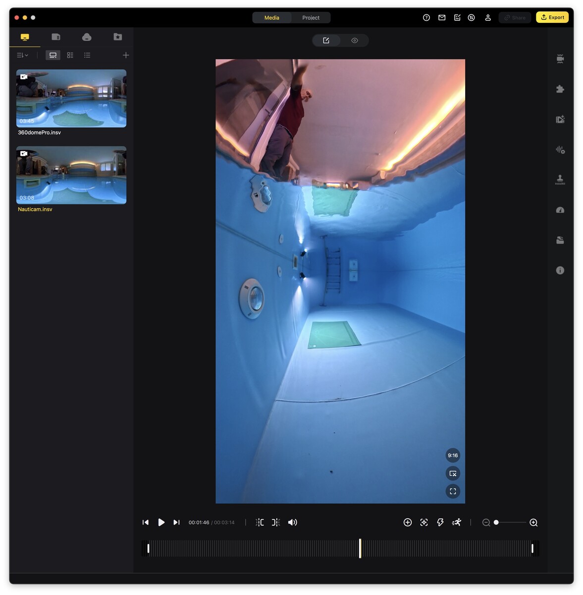

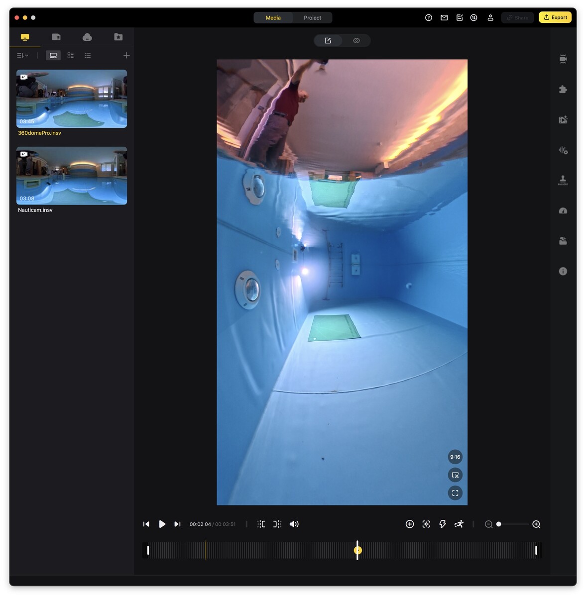

For like wide angle shots without close subject or in another words infinity shots I would say the results are comparable from what I see. Mind you this is a poorly lit pool so we shall see what results are we going to get from reef shots with abundance of light but it could be similar. So no big difference.

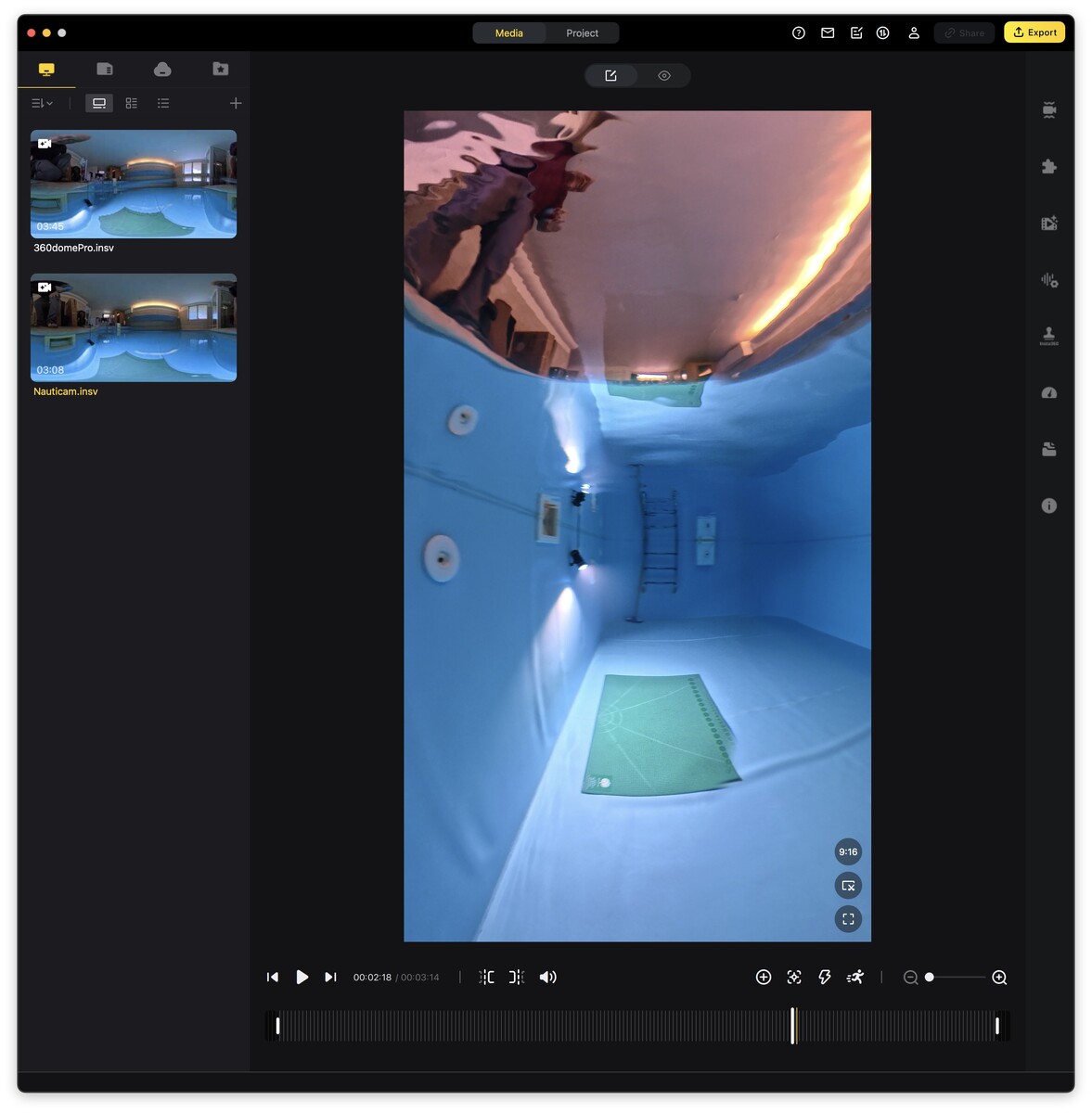

and the bad seam for subject 2m away you can judge yourselves...

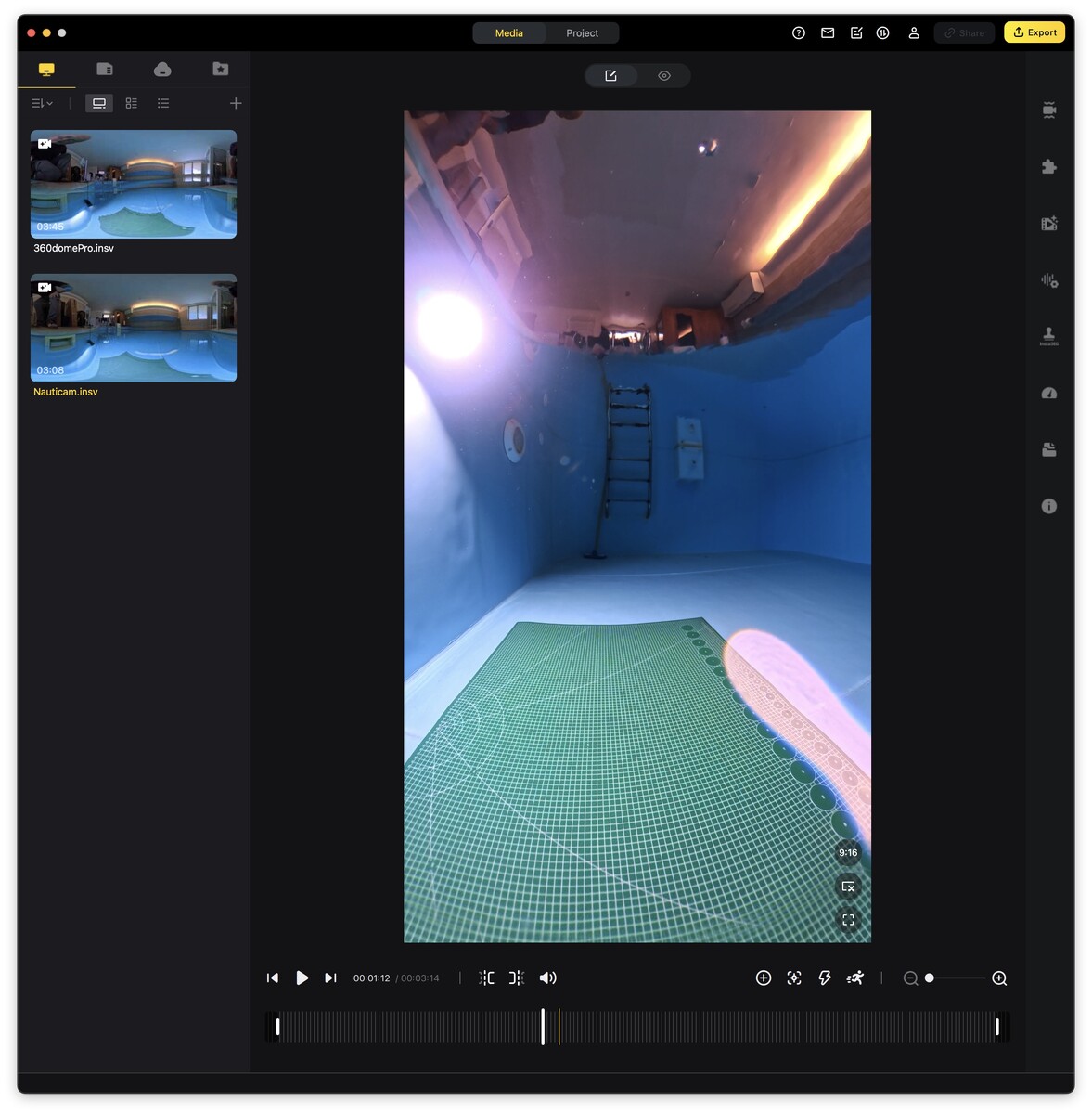

And lastly another ugly child is the lamp projection. You can see where my lamp was so do your own caculations as to where the housing was when it projected this

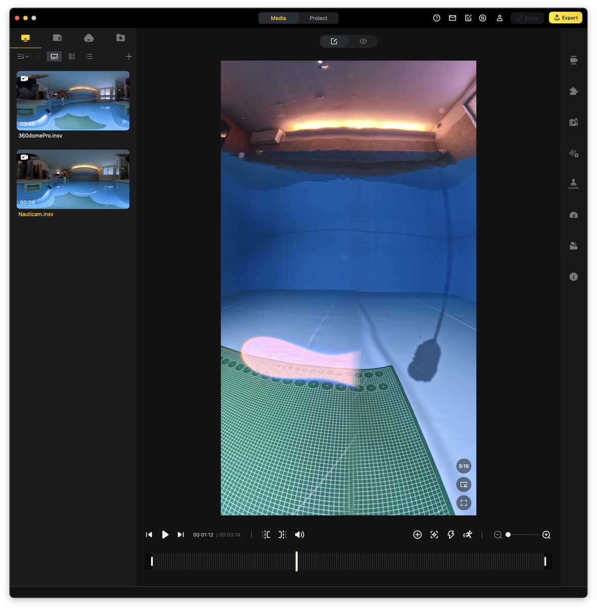

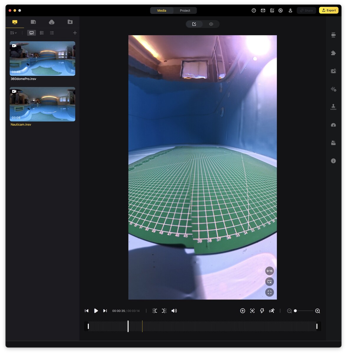

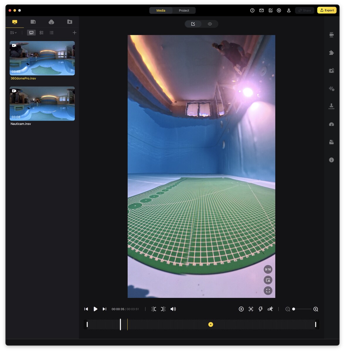

This is a follow up to report above which I am leaving as is for demonstration purposes even though I made mistake. Always read manuals :-). After adjusting 360Studio to recommended settings - which were Dive Case mode OFF (I already had AI stitching ON) I made another look at the test footage.
The stitching improved. It is not seamless by far but at least it is almost tolerable. Still Insta360 case Pro stitching is far more invisible mainly in the blue. At the close distance the stitchings are almost on par - simply they are visible.
The main problem with Nauticam stitching in the blue is a divide in exposure. This is going to be an issue in confined spaces with only one half of housing facing the lightened area.
What's definitely an issue with Nauticam is a nasty flare coming from spot light sources. Basically if you will be in the group with someone with lights on - beware.
Here is side by side test footage (adjusted as much as the amount of time I wanted to give it)
And some sample screenshots with updated settings
Screenshot 2026-04-19 at 12.07.04.jpegScreenshot 2026-04-19 at 12.05.27.jpegScreenshot 2026-04-19 at 12.09.17.jpegScreenshot 2026-04-19 at 12.08.51.jpegScreenshot 2026-04-19 at 12.07.40.jpeg
