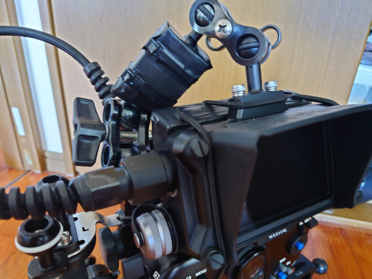

Your monitor has twin mounting options on both the top and bottom of the monitor, meaning you can just mount a standard ball mount (with dual screws) top or bottom, and then just use a long clamp or a small arm (5") to position it wherever you want.
I have a Weefine 5-HD pro with a dual mount point that I use with an NA-A1 housing (standard camera shape). I mounted the ball mount on top, and use a 5" arm, it's very flexible.

Ok sweet! That looks like a really good setup you have there @bghazzal ! Thank you so much for the picture, that helps a ton and I like the way it sits reasonably close to the top of the camera body. It never occurred to me to use the top as a mounting point 🤦‍♂️.
