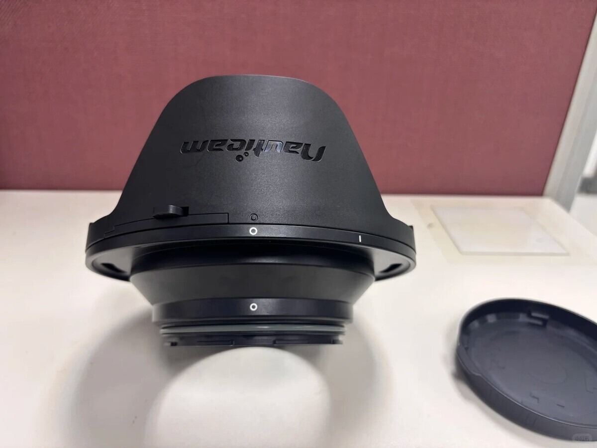

Confirmed: Sony Fisheye Zoom 8-14mm
I don't believe the extension is "built-in" it looks more like the #37306 N100 to N120 25mm port extension combined with the #18816 140mm port with removable shade II used for Canon RF 7-14mm fisheye. If not that extension something shorter than 35.5 rather than longer since the 8-14mm lens is shorter than the Canon 8-15 with adapter.
Nauticam already lists the old port using N100-N120 35.5 extension. The only difference is the port shade for the old 140 has four Allen screws to remove the shade and the new 140 port now has a bayonet mount to remove the shade. Both ports appear to be N120 and the new port just has a different N120 to N100 extension mounted on it. Two threads going on this topic, one here and one in general chat is making this a bit confusing.

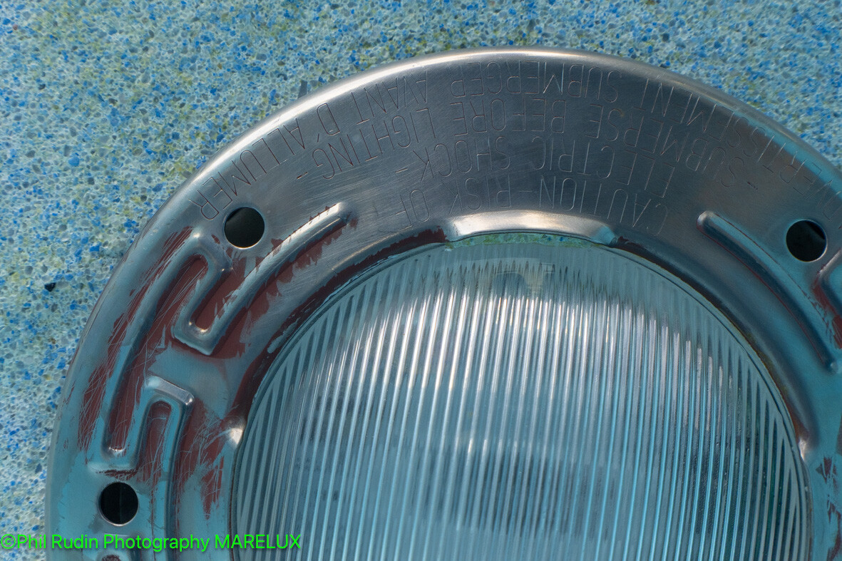

I don't wish to beat this to death Romik but I am sure my A7R VI with 66+ MP would expose flaws slightly more than the A1 50MP. I would expect F/8 to render slightly better images than the F/11 I was shouting due to refraction. I have attached a full frame image and a more than 200% crop at 70mm and F/11. The crop appears sharp to me.

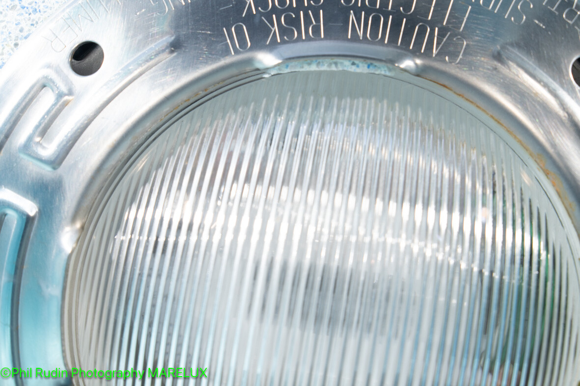

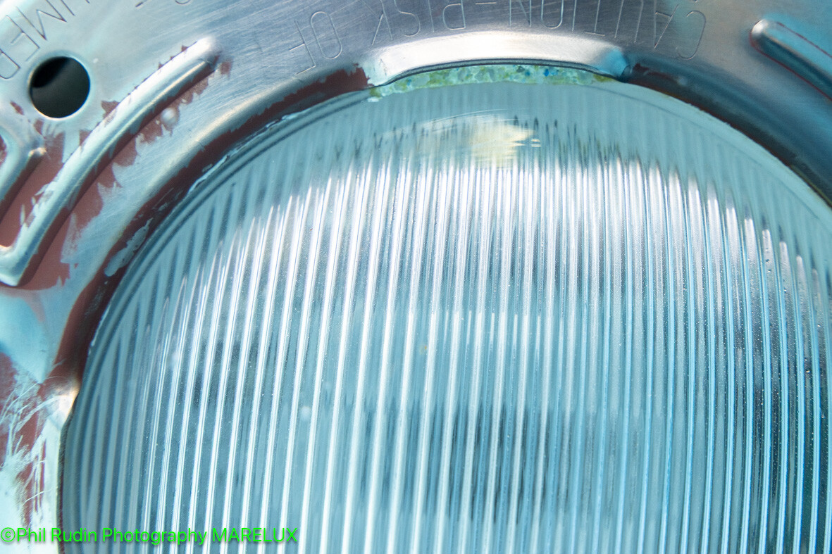

I am not sure your example makes sense. The 60mm end of the 28-60 has a max magnification of 1:6.25 while the 28-70 II at 70mm has a magnification of 1:5.5. It can also focus well beyond 30 FPS and unlike the 28-60 it also has in lens stabilization. If you are suggesting that the IQ at 70mm is worse than at 60mm or that the 28-60 has some other medical advantage I offer these images to compare. Like many of you I have look at terrestrial reviewers and flat charts to adnauseam over six decades. Everything in photography and even more so in underwater photography is a tradeoff. My opinions are based on years of U/W tests both my own and others I trust. The first image is the 28-60mm at 60mm with WACP-C and A7R v, shot at F/11, 1/160th sec at ISO-400. Second image is the FE 28-70mm II with MX 135D and A7R VI, shot at F/11, 1/250th at ISO-640. Both images un-cropped and both taken at same distance from the glass +/- a MM or two

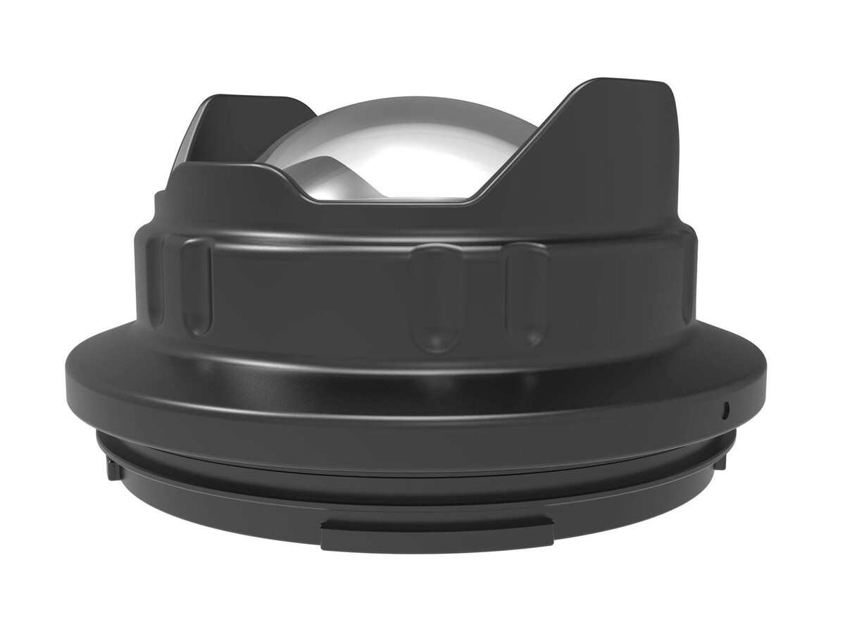

New Sony Fish Eye

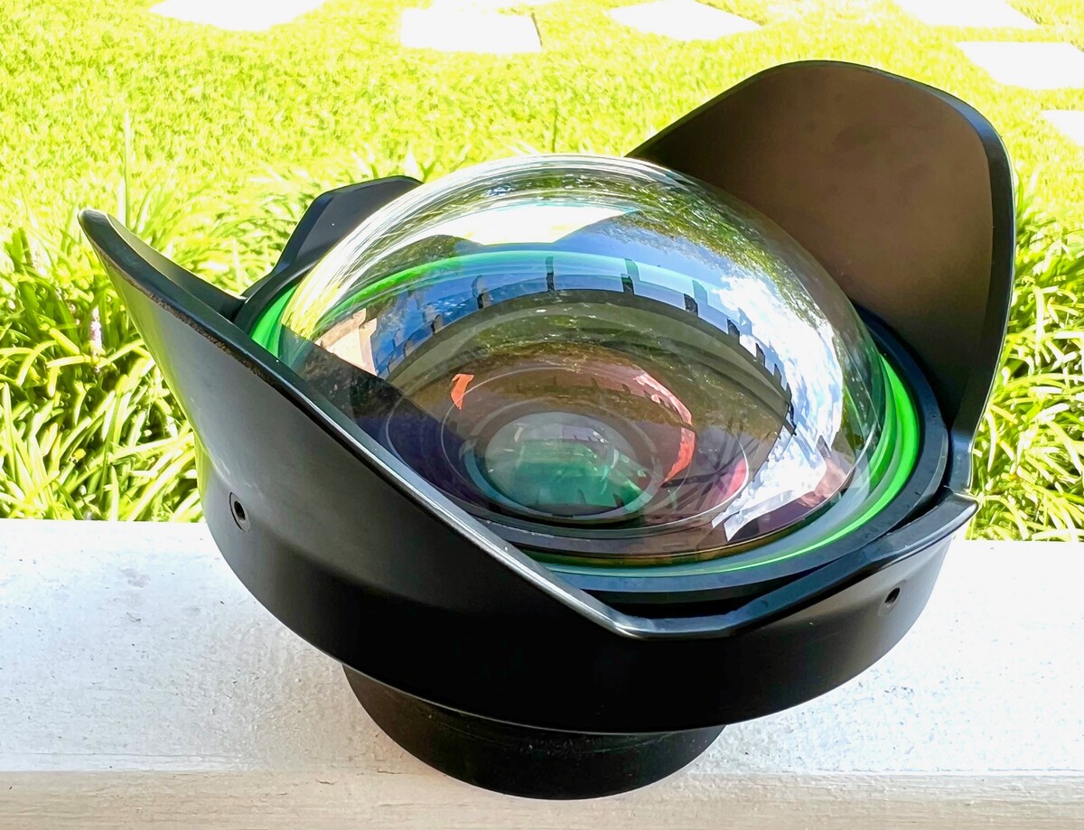

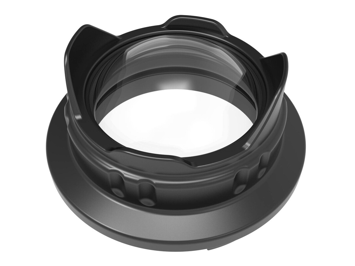

Regarding the new port chart the NEW N100 140mm II (#37188) with removable shade now appears to have a bayoneting shade while the older 140mm N120 has a shade where you loosen Allen screws to remove the shade. The new Sony N100 port appears to be the N120 140mm (#18816) II also with bayoneting shade for the Canon 7-14mm fisheye lens with a N100 to N120 adapter added. It will be interesting to see if the extension is fixed or removable and the same 35.5 mm length recommended for the old N120 140mm port with the Sony 8-14mm fisheye. Both ports, N120 and N100 (assuming the extension is included) retail for $1600.00.

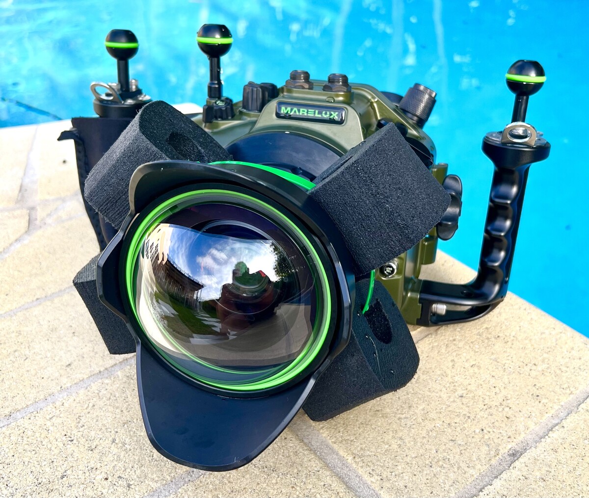

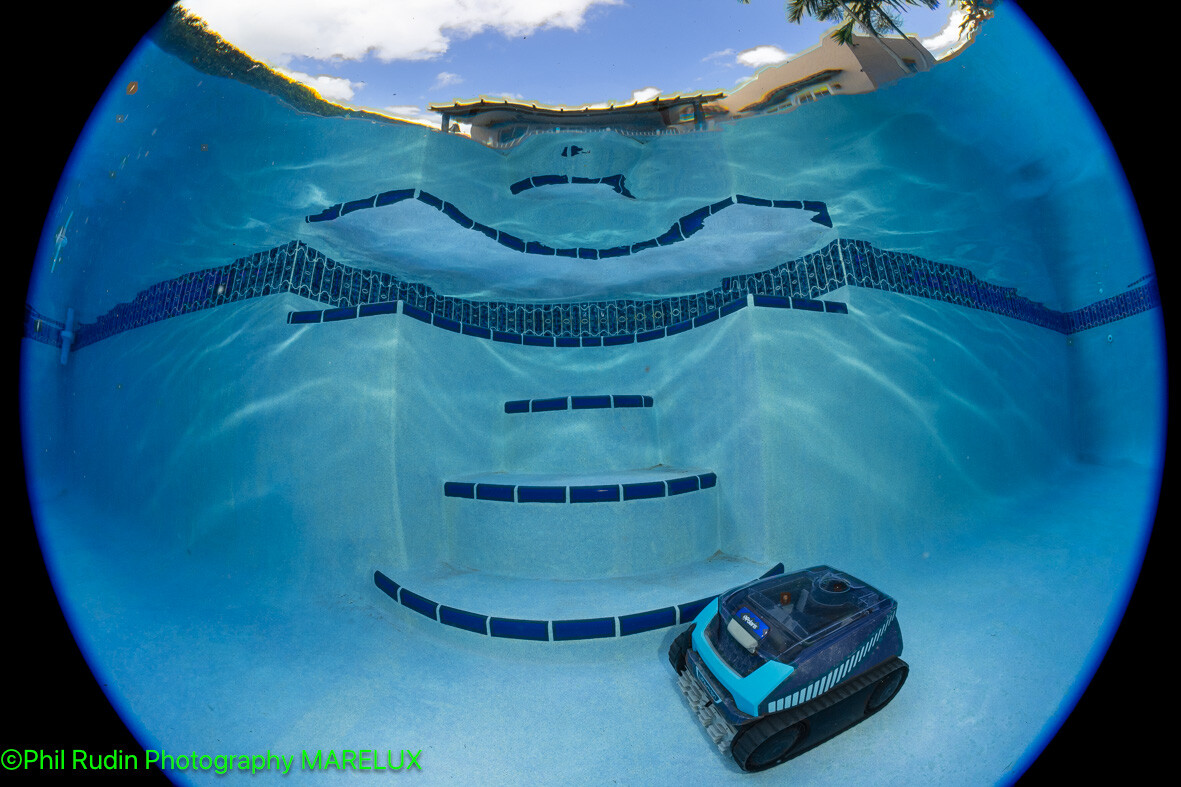

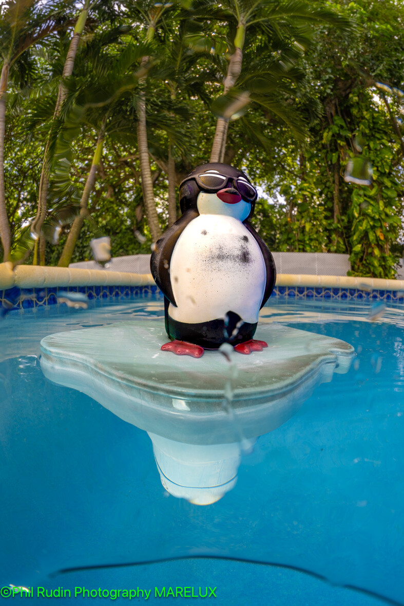

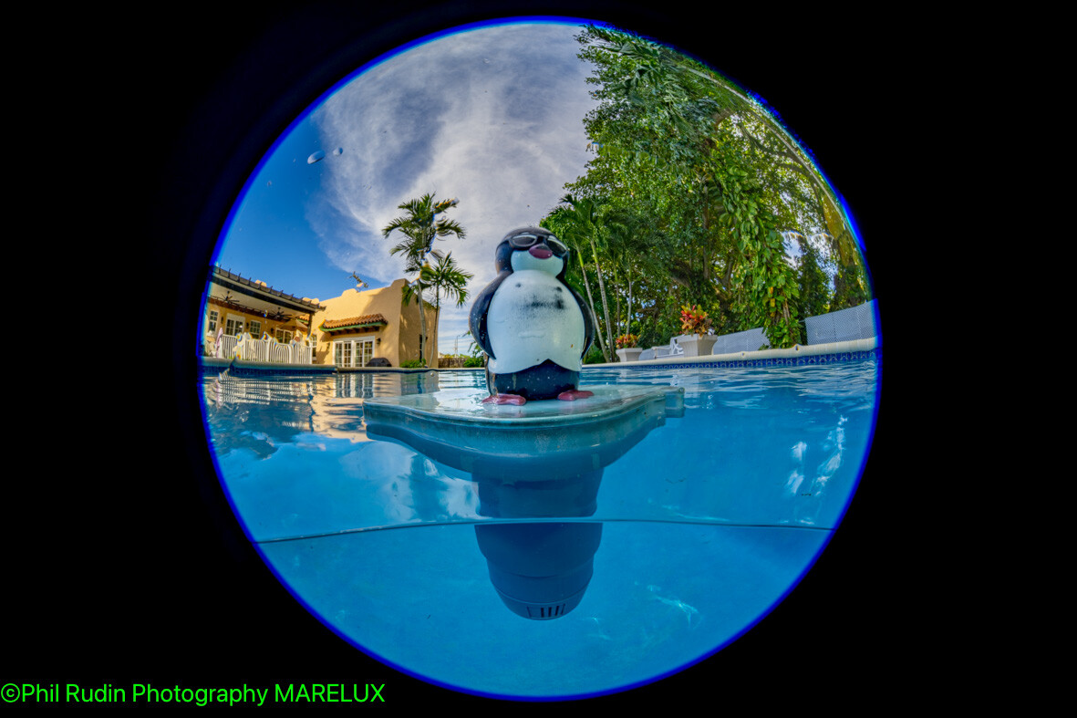

I had the new Sony FE 8-14mm F/3.5 G in the pool today and I will add some on my thoughts. As I am sure most of you know the lens is light and small for a 8-14mm fisheye 314g compared to 476g for the Canon 7-14mm F/2.8 to 3.5 L and 504g for the 7Artisans 10mm F/2.5 MAX. Canon is the widest at 7mm with an AOV of 190 degrees while the 7Artisans is 185 degrees and the Sony is 180 degrees. All focus to 15cm and all can be used in a 140mm dome port. Price ranges from Canon at US $1899.00 Sony at US $1598.00 and 7Artisans at US $449.00. I included the 7Artisans lens because between the three it is by far the best value being equal to or in some cases exceeding the Sony at 14mm. I will not comment on the IQ of the Canon because I have never tested that lens. For the attached images I used the Sony A7R IV camera which gives 66.5 MP files and 28.4 MP files in APS-C mode according to the Lightroom meta data. The Sony can zoom from 14 to 9.5mm while in APS-C before starting to vignette. At 8mm the APS-C crop vignettes in all four corners and cuts off the top and bottom of the full circle. I tested the lens using a Marelux A7RVI housing, MX 140mm dome which has a removable bayoneting shade and a 20mm extension, this is the same combo I use with the 7Artisans 10mm. I also used two Marelux Apollo-S strobes attached directly to the housing grips. All of the images are full frame with no crop. I have not yet received the zoom gear for the lens but hope to have it for DEMA. For these tests I locked the lens at 14mm and then at 8mm which to me are the most useful ends of the lens. I included one APS-C shot with the vignetting at 8mm. Regarding the issue of tele converters the diameter of the protruding glass is the issue, it would not fit into the 8-14 even if you had enough depth inside the lens. I don’t really see the upside to using a full frame lens with a 180 fisheye and a tele converter to begin with although I have never tried this combo. The crop of 1.4 or 2X allows you to zoom through most of the fisheye range but using a tool (the tele converter) that was intended for use with long lenses in the 300 to 800mm range does not seem like an optimal design. It seems to me that the AOV range covered is less than you would get using a wet wide lens like Aquista 130/WWL-1B or Aquista 135D. The range for 135D is 135 degrees using a 28mm to 58 degrees at 70mm. This lens is not rectilinear so exhibits the same distortion you would expect if you reduced the AOV of a 14/15mm fisheye. For these tests I had the IBIS turned off and the subject recognition set to all types of subjects.
New Sony Fish Eye

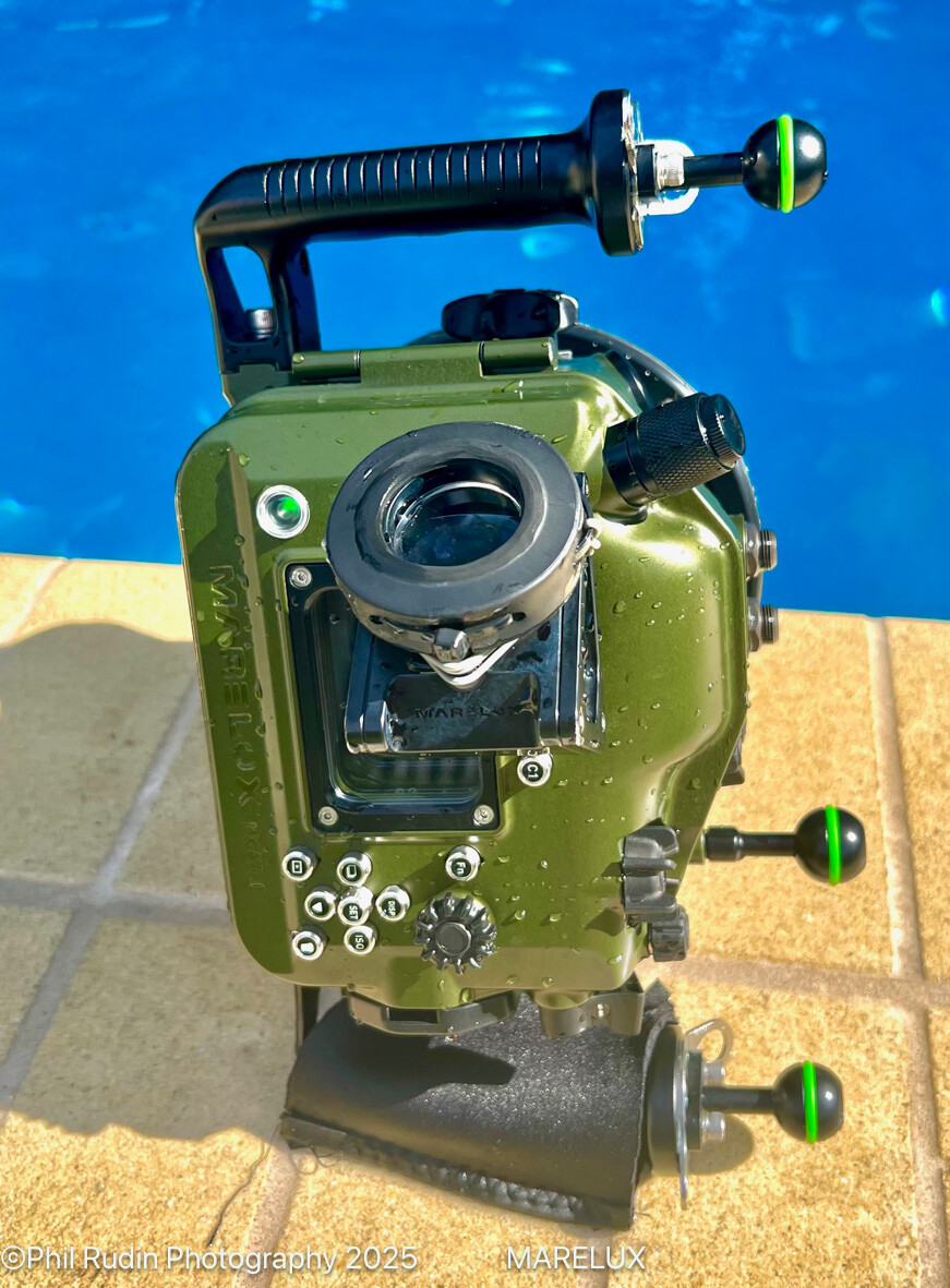

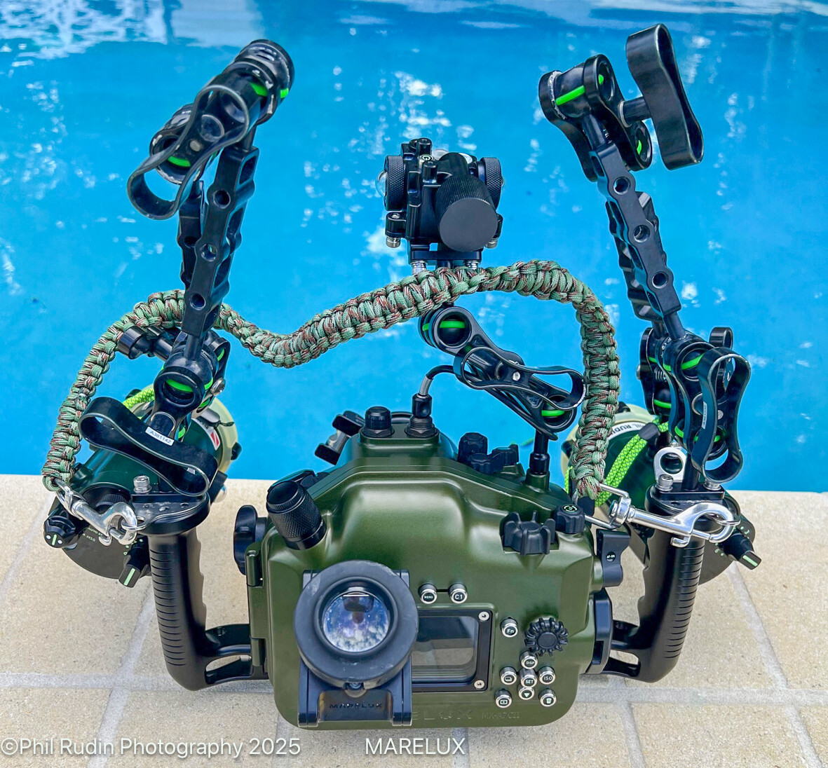

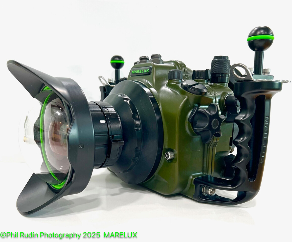

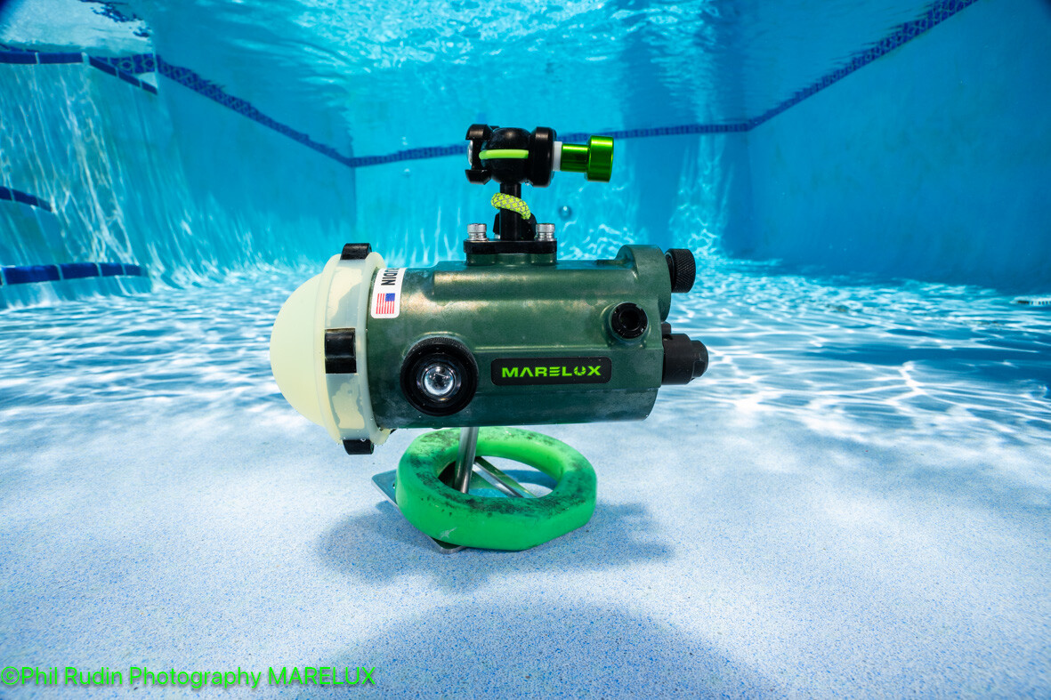

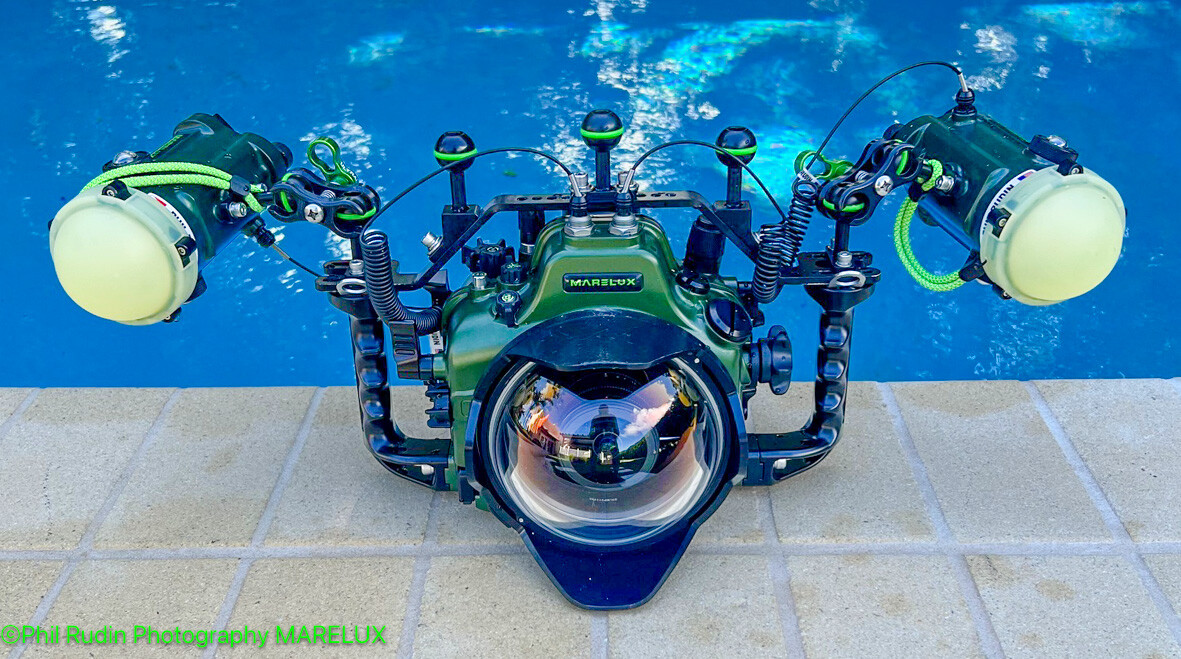

As you may or may not know the sunshade needs to be removed from ANY port to use the 8mm end of the lens. The photo shows the shade removed. The photo below shows how I take the system into the water. In the water cover is removed and slipped over my arm. If I want to shoot the 8mm circular fisheye end of the lens I then remove the shade.
New Sony Fish Eye

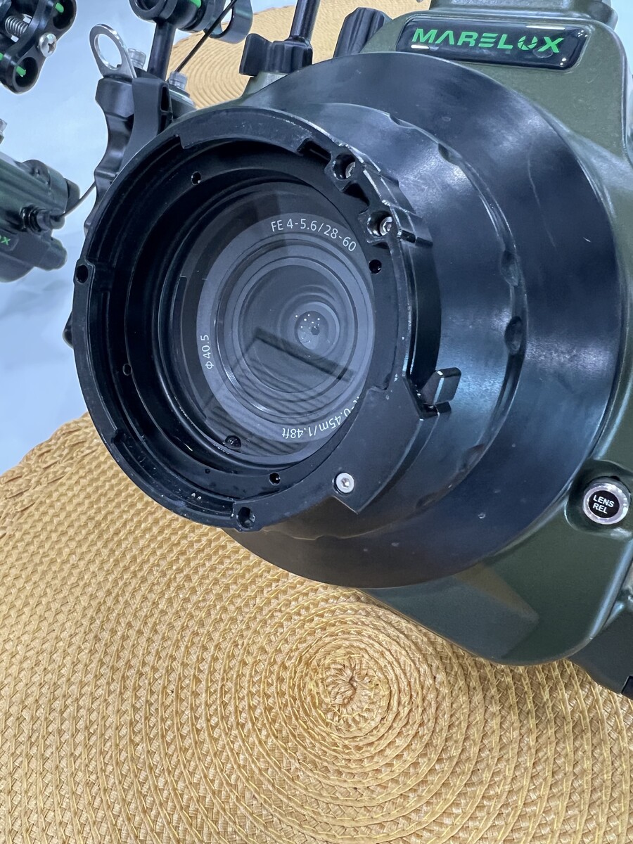

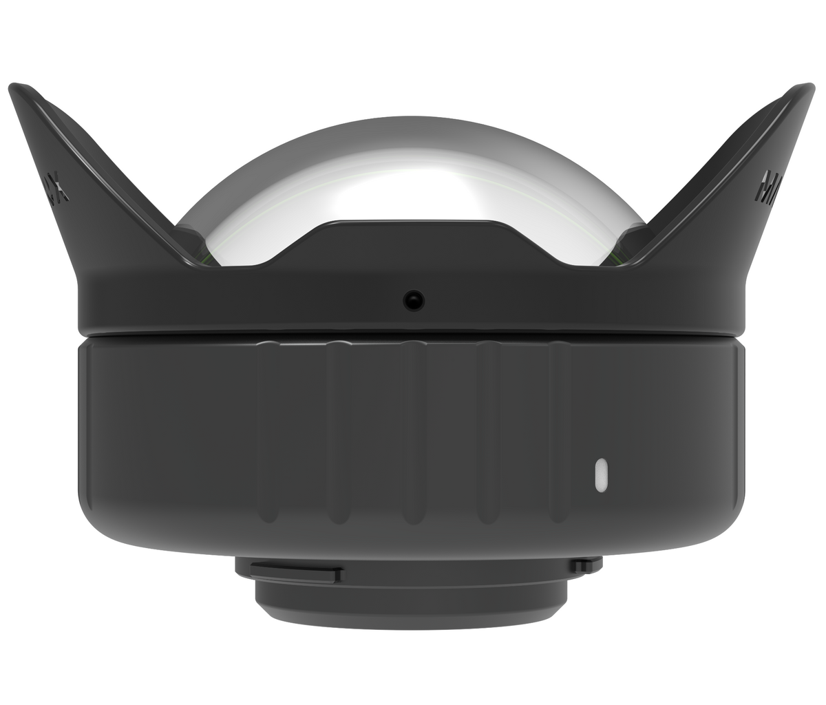

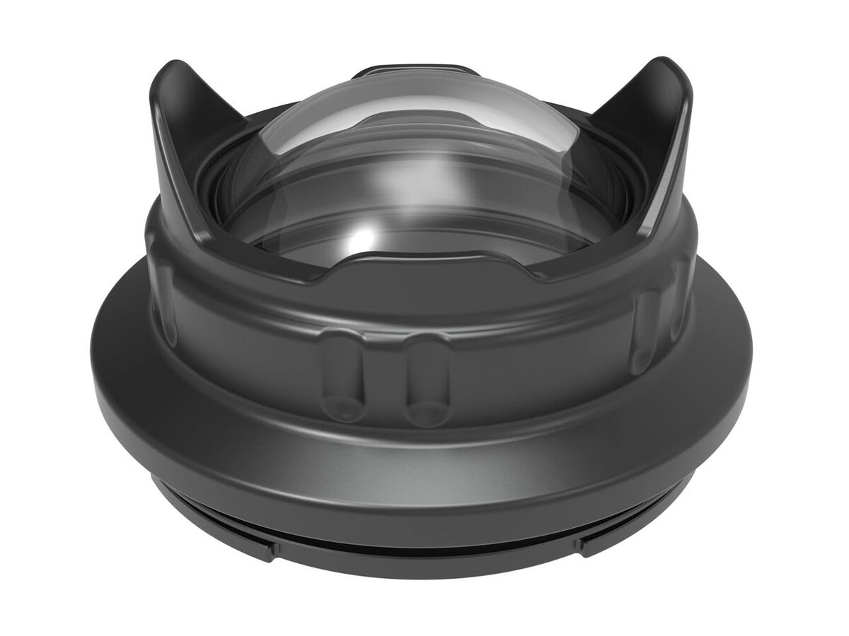

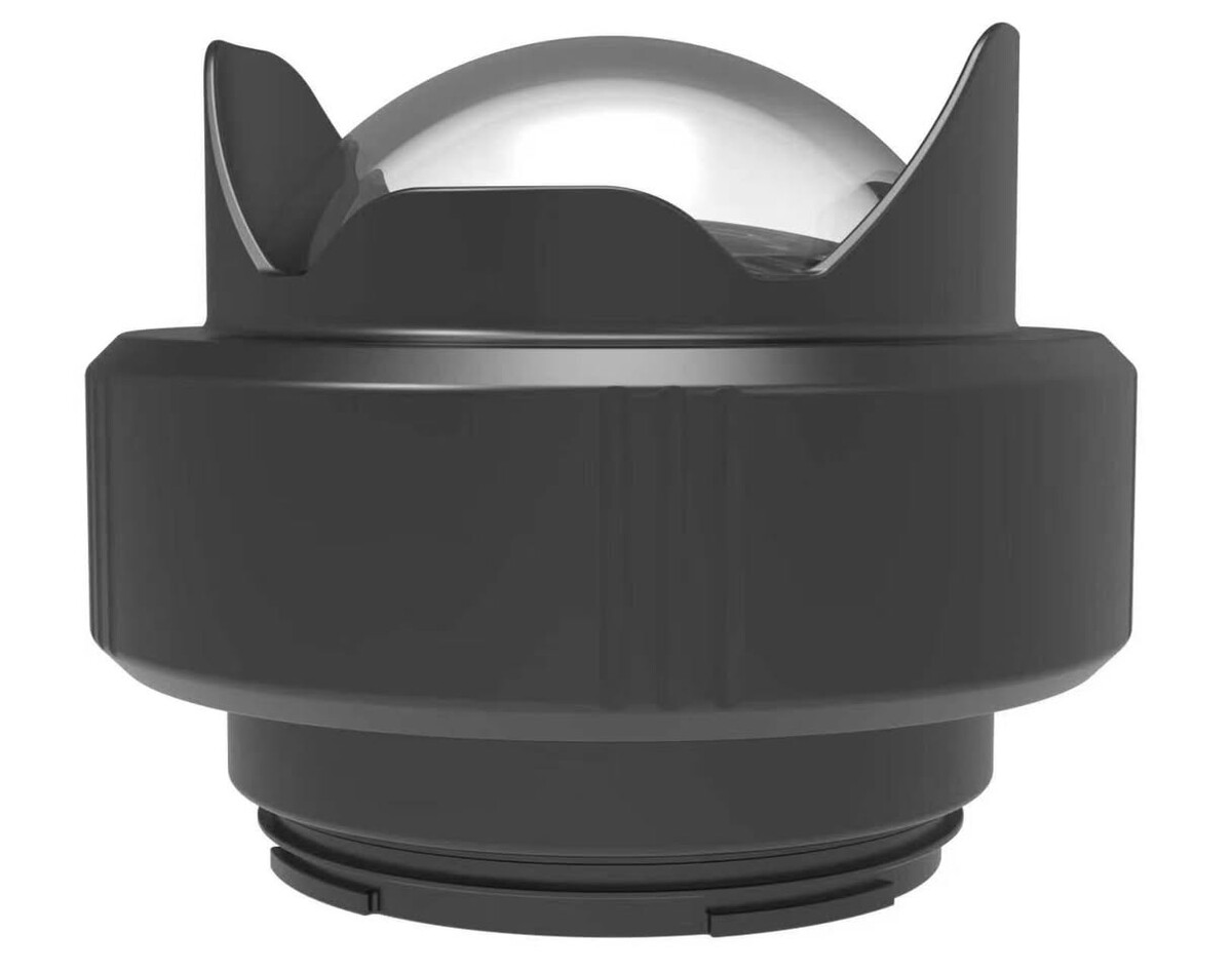

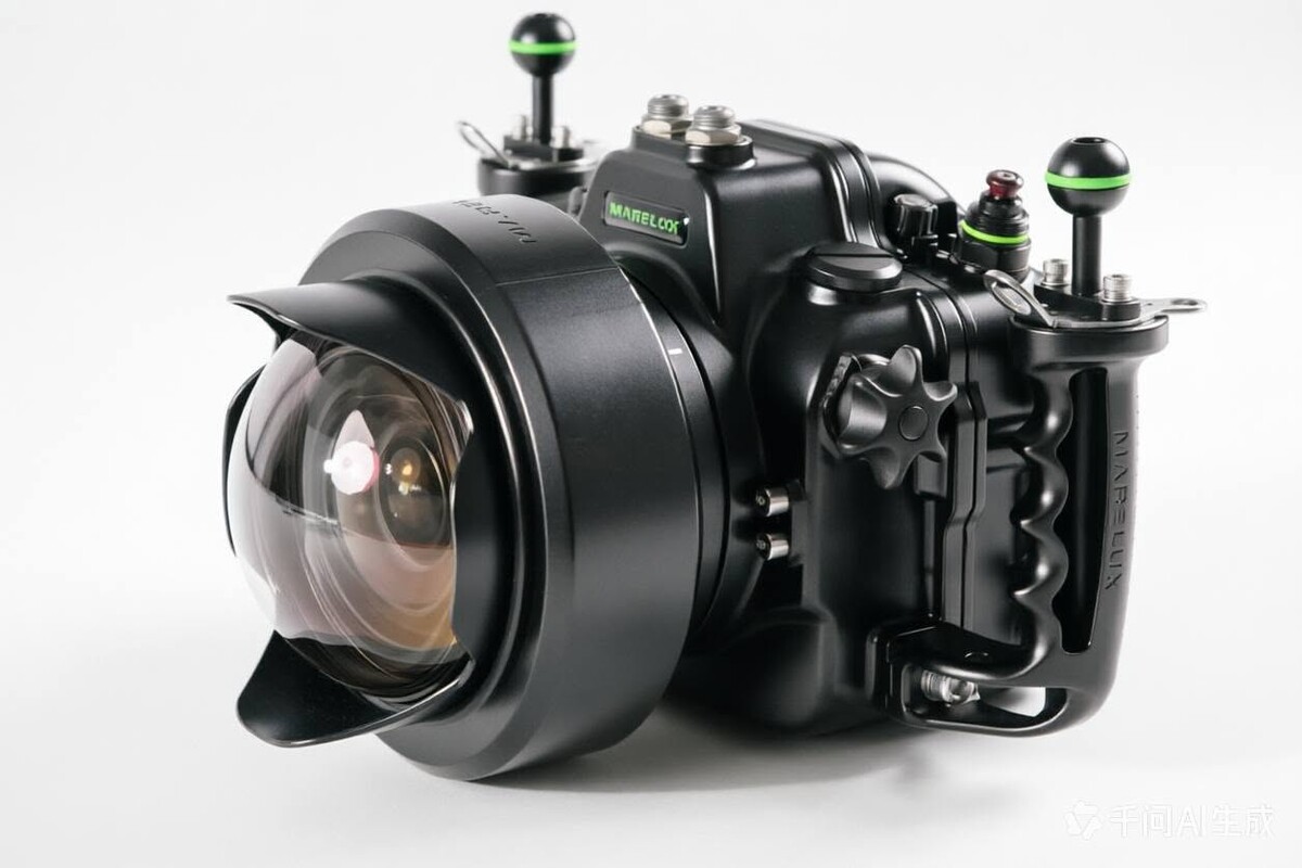

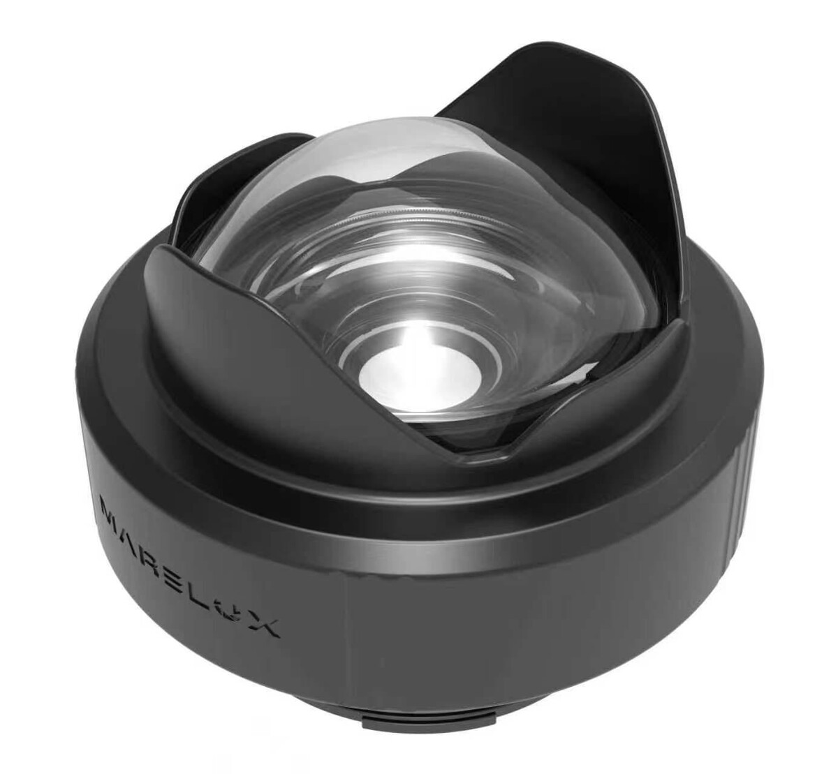

For Marelux system users the Sony FE 8-14mm zoom gear will be #51117. Used with a 20mm extension for 140, 210 and 230mm dome ports. The Marelux 140mm port already has the removable bayonetting sunshade introduced four years ago at DEMA with a retail price of $1180.00 in the US.

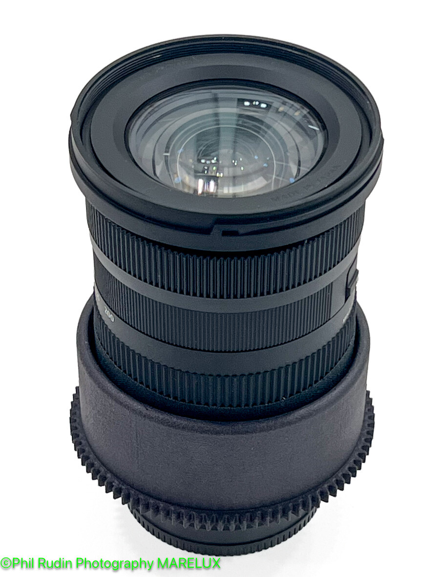

This lens is a hard pass for me, at 0.5 meters in AF you will be at or greater than 1:10 magnification. If you have a focus gear made (unlikely to be supported by most manufactures) at 1:1 you will be 49mm (1.9 inches) from the subject. Inside even the smallest dome my guess would be that you would be able to use lens at 1:2 but not 1:1 simply because of the space taken to use the lens inside a dome. If a realistic maximum magnification is more like 1:2 behind a very small port the much better choice would be the now over four year old $249.00 retail Tamron 35mm F/2.8 Di III OSD M 1:2 Macro. This is a lens that can be found in the used market for less than half the Laowa lens price. The lens is much smaller and lighter using the popular 67mm filters associated with many Tamron lenses and others. It requires no custom focus gear and has excellent AF. At 1:2 the lens minimum focus is a more manageable 15cm/6 inches. I would suggest that if you are considering a 35mm with macro capabilities you should checkout Christopher Frosts reviews for both these lenses. The Tamron is highly recommended and the Laowa not so much. The big issue for the Tamron 35mm macro is that it is only made for the Sony E mount in full frame. Laowa has some excellent lens choices for U/W use like the steller 12mm F/2.8 Lite Zero-D not sure the new 35mm is one of them. I have suggested several lenses for Marelux to test in the new 80mm dome port and the Tamron 35mm will be added to that list.

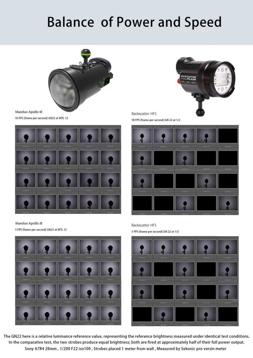

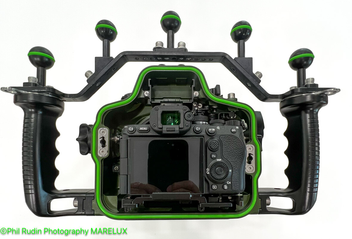

Custom battery Solutions For Our Housings

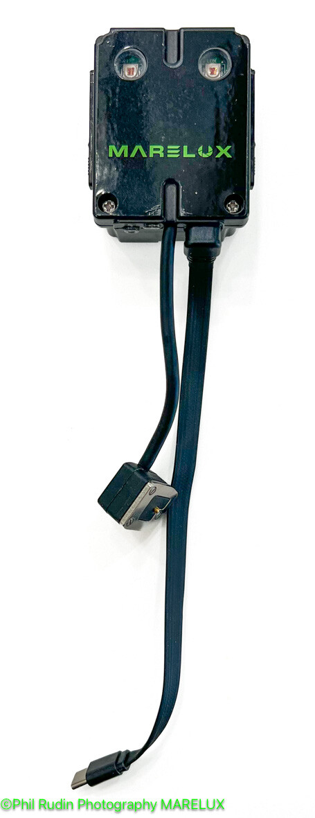

The Mini is 60 x 40 x 20mm. The FlashFuel 2100 is the current solution for stills and the RMT5 with be the video solution for now. As you have stated Marelux has many "brilliant" design ideas and I can only say stay tuned and we will all see what comes next. My understanding is one cable bundle.

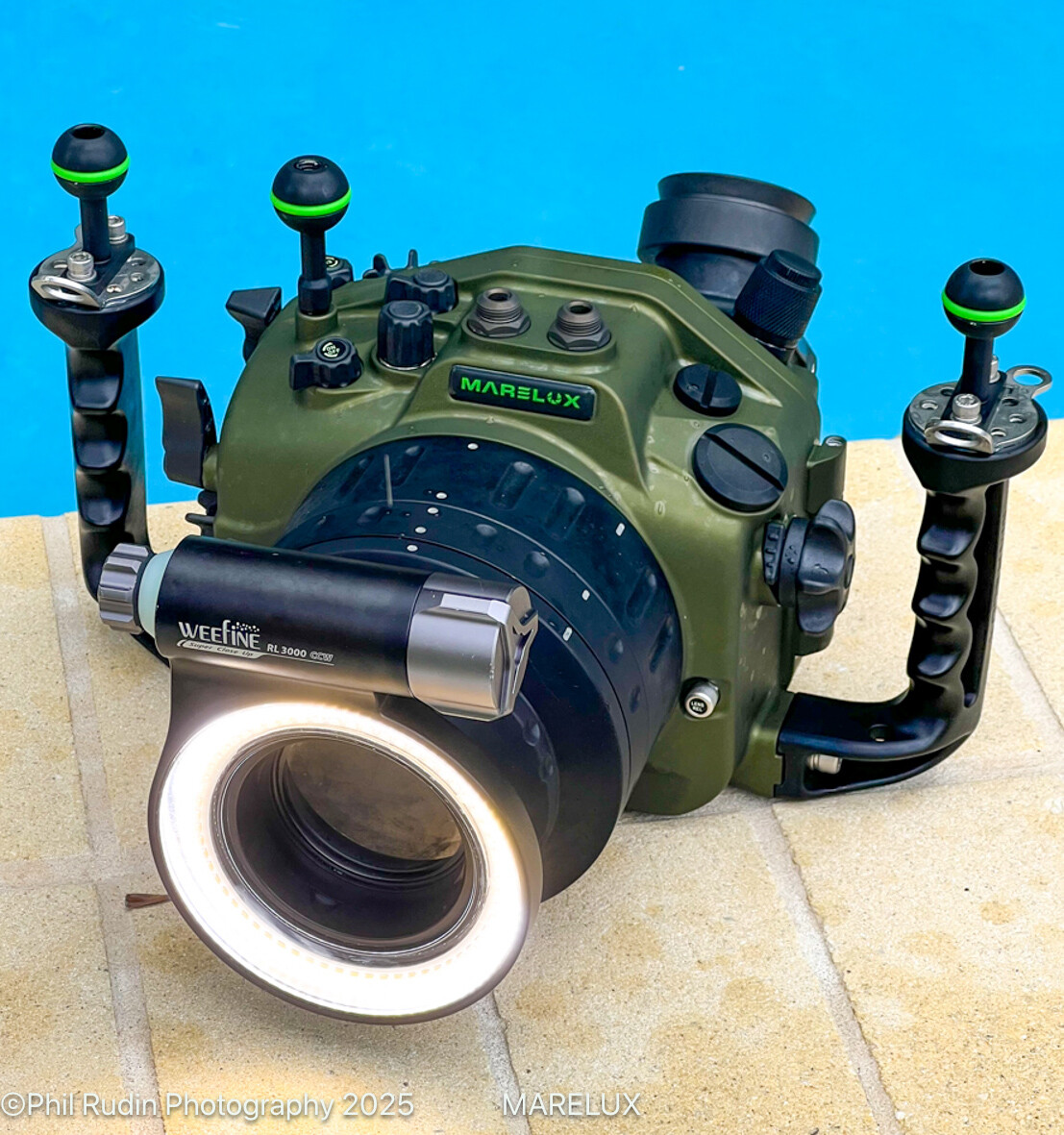

It will be interesting to see if it is #1 auto focus and # 2 for full frame or perhaps APS-C. In advance of the Laowa announcement Marelux has just released info on an 80mm acrylic dome port for the canon EF-S 35mm f2.8 is stm macro lens. This is an APS-C macro which will need a EF-S to RF adapter. The FF crop factor for Canon is X1.6 so a FF equivalent of 56mm. I believe this new port will be excellent for a verity of full frame, APS-C and M4/3 lenses macro lenses in the equivalent 35mm to 60mm range. At 80mm this would be the smallest dome that I am aware of (Zen has a 100mm). I suspect it may resolve some of the issues associated with shooting shorter macro lenses behind flat macro ports. Also keep in mind that lenses like the Tokina 10-17mm have been adapted to very small dome ports.

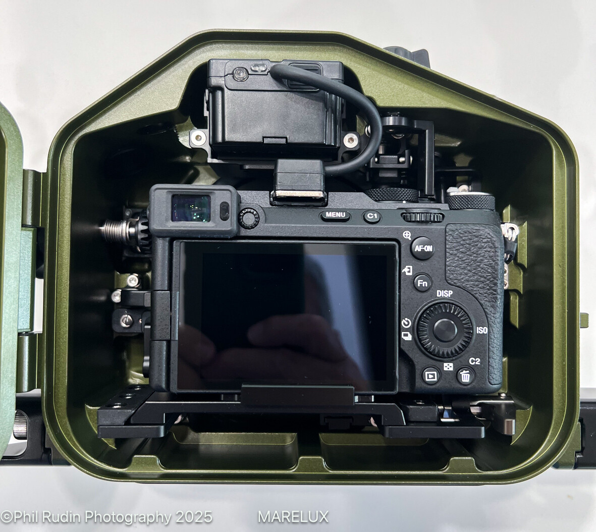

Several battery solutions that are not DIY from Marelux. Marelux first offered MiniBat 1500 for $128.00 While they came up with a better design not offered by anyone else. MiniBatt 1200 is a 1200 mAh battery pack designed to fit inside the housing under the tray and is 6X4X2cm and 61.5g. This is much like the design of others with a mini USB-C charge and camera connection. OK for multi brands where it will fit. Marelux then redesigned many of their new housings for use with FlashFuel 2100. The patented design serves two functions, first as a manual flash trigger and also as an additional power scorch for the camera. FF2100 has a 2100 mAh battery to power the camera via USB-C and a second CR123 lithium battery with a capacity of 1000 to 1200 mAh depending on the battery to power the manual flash trigger. Because the Marelux Apollo strobes in MTL mode can fire at up to twenty frames per second a power source was needed that could keep up with the flash. The original MX manual flash triggers with two CR2032 achieved around 100,000 to 140,000 flashed depending on the batteries being used and the FF2100 should achieve around three times that amount. FF2100 retails for $348.00 and because it is manual it works between all camera brands Marelux supports. Marelux also makes a TTL flash trigger that fits into the same housings listed below if you don't need the additional battery power. It has a manual or TTL mode switch, USB-C charging with realtime battery level indicator and retails for $348.00 in Sony, Canon, Nikon and Panasonic models. For video monitor users Marelux will soon introduce the Neptune RMT5 a 3000nit five inch LCD monitor which also adds to the battery supply. In addition to working as a video monitor it also provides a massive 6000 to 10,000 mAh of power. The RMT5 battery compartment can use 21700 or 18650 batteries (with the included adapters). The monitor also has a remote trigger port which allows it to be remotely triggered from 1 to 2 meters away using a waterproof cable. Vacuum-Safe, Zero-Leak Cable Engineering all three custom cables for the Neptune RMT5—HDMI, Power Supply, and Remote Trigger—are engineered with a specialized internal air-block barrier. Both the electrical wires and the connector assemblies are completely sealed internally. This prevents internal air migration, ensuring your housing maintains a perfect vacuum seal throughout the entire dive. RMT5 will retail for $1499.00. Compatible housing models: MX-R5II, MX-R6III, MX-A7V, MX-A1II, MX-A7CII, MX-A6700, MX-Z8, MX-Z6III, MX-GH6/7, MX-S1RII and the new MX-A7RVI. With more designed for new cameras going forward.
Nauticam/Sony with 140mm Dome and Native Sony Lenses
Correct GeckoSub, these are with the 140mm Marelux fisheye dome port.
