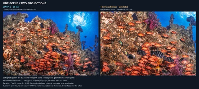

  4. I beg to differ. In my experience the difference is huge underwater and you cant really go by numbers. With WACP you can do sunbursts all of a sudden, almost anywhere, while with 16-35... not so much if at all. Because of a fisheye effect of WACP you get much more information and coverage in corners and areas leading to corners while with rectilinear lens - imagine that projection circle defined by horizontal FOV will just get stretched out to corners. Anyway to visualize what I mean I let AI engine to apply rectilinear adjustment on my WACP-C image and apply 16mm diagonal FOV. And no the argument "just step away" wont work, the sun would go elsewhere. Don't forget to book flight through Mexico City... you do not want to pay taxes on your camera in Cabo. While in Cozumel and maybe Cancun there seem to be awakening Cabo is still brutal. Friend of mine paid USD500 on his nauticam setup.

  14. If you want to save some money skip WWL and get WACP-C. You will end up there anyway... So very much sharper on both ends.
