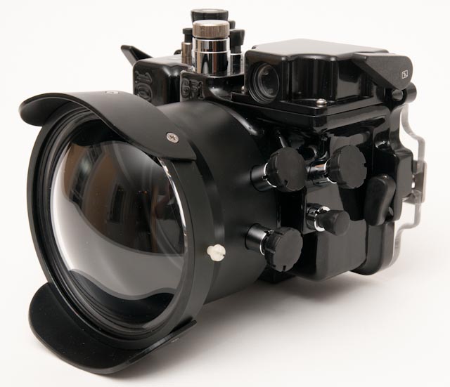

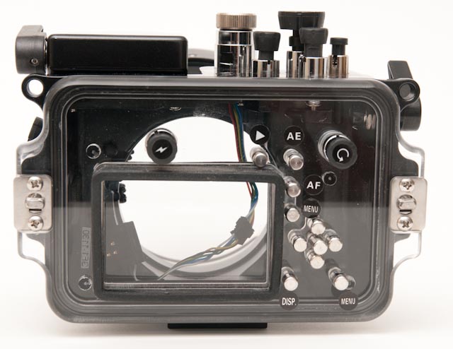

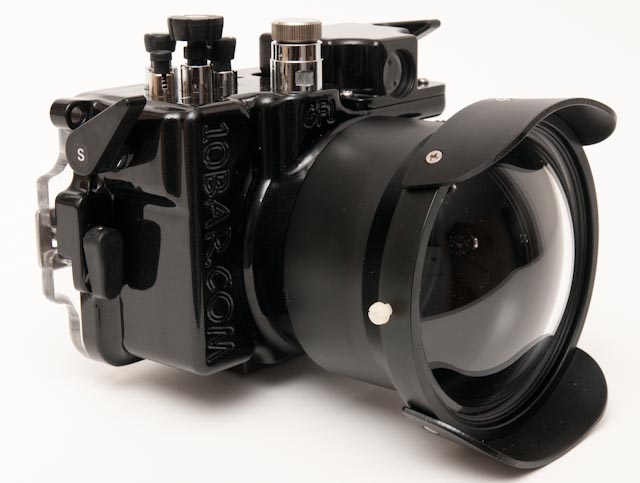

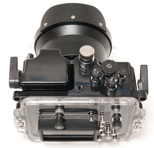

  11. Thank you very much for posting those, Marc - quite superb. I see your GF1 is housed in a Seatool. I'm looking at the 10-bar myself, as it is easier to get hold of in the UK, but I'm not aware that there is a port available yet for the 8mm....or does anyone know differently?
  12. Yes, a couple of new developments from 10Bar.
    They've revised the housing and now have dedicated controls and push buttons. The mode knob is bigger and higher, making it easier to work. Overall the controls have been tightened up and are smoother to work. He added a focus light screw mount hole (not sure why he skipped it to begin with...). Below is shown with the 7-14/14-45 port - it ships with gears for the 14-45, the 7-14 are extra.
    The 8mm port is in prototype and it should be available very soon, like a couple of weeks.
    BTW, they also now have a new housing for the GH-1.
    Jack
    Edited by JackConnick

  16. In the UK, one of our main distributors is selling the M77x100DZ as a port for the 10-Bar and it shows on the website as being suitable for the 7-14mm and 14-45mm lenses. The 8mm fisheye port is also shown and priced, but not yet in stock ( with this distributor ).
    I'm waiting for stock to arrive ( which includes the refurbished housing ), but am undecided between the 8mm fisheye vs. the 7-14mm. Obviously there is a price difference, and the 7-14mm is rectilinear, but I'd be interested to know anyone's thoughts on which would be the better of the two lenses to opt for, and why?
  17. In the UK, one of our main distributors is selling the M77x100DZ as a port for the 10-Bar and it shows on the website as being suitable for the 7-14mm and 14-45mm lenses. The 8mm fisheye port is also shown and priced, but not yet in stock ( with this distributor ).
    I would go for the fisheye lens first. It has better close-focus capability for CFWA shots, and has a wider angle than the rectilinear 7-14 (180 degrees for the 8mm vs. 114 degrees for the 7-14).
    On the other hand, I haven't used either of those lenses. My closest experience is with an E-P1 in a custom housing with a MFT-to-FT adapter and a Four-Thirds Olympus 8mm fisheye lens.
  18. The proper port for the Panasonic 8mm FE for the 10Bar is M77x125DZ. They have just come out.
    Jack
