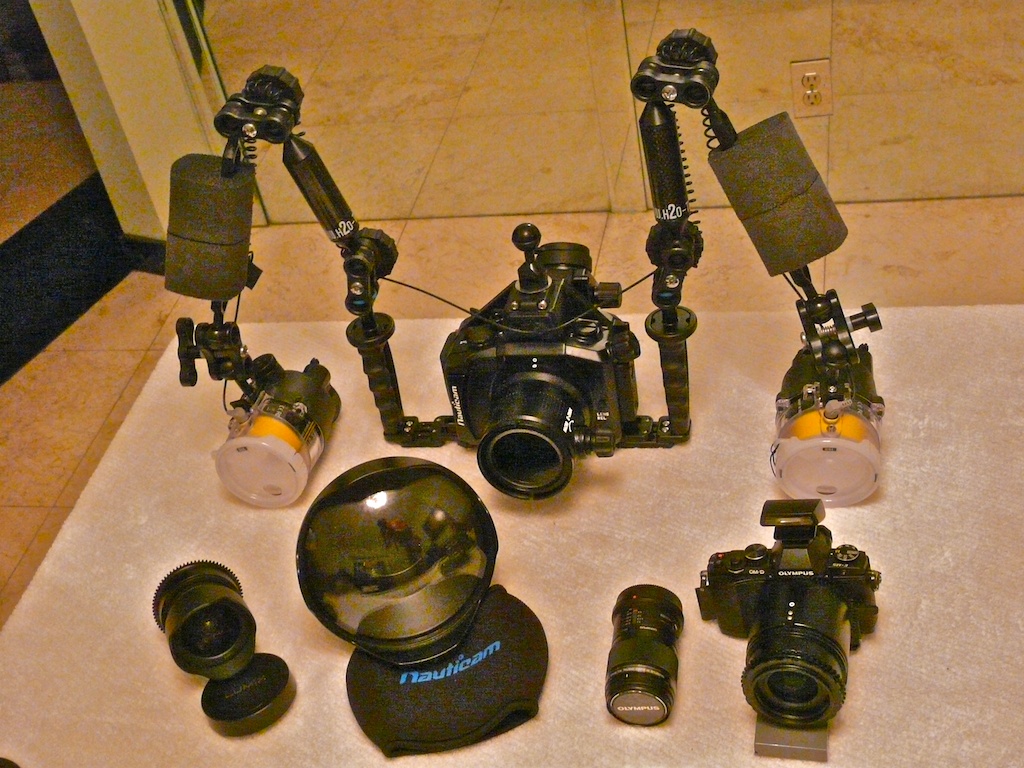

  1. Sorry just can't help posting this shot of my new baby! Now, can't wait to post shots FROM the new baby!
  2. Looking good. Which dome is that?
    Alex
  3. That's the Nauti 6" dome specifically for the 7-14.

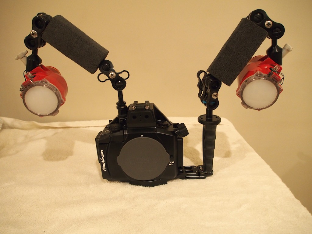

    Everything you see in the photo of my system above, plus a video light, fits perfectly in my roll-on pelican case. No checked bags or extra charges necessary.

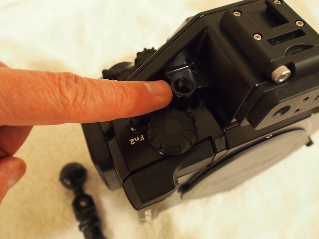

  6. Hi All,
    I'm curious what others are finding with their OMD-EM5/Nauticam setups in terms of tray-to-housing ergonomics. As you can see in the photo a few posts above (GuyHarrisonPhoto rig), that the flexitray is a little long for the housing. I have the same setup and even though I have quite large hands it is still a stretch to reach the shutter release. I played around with trying to bolt the flexitray pieces together in a different configuration but wasn't happy with any of the results. I know Alex M has shot with the Nauti Hand Strap and attached strobes to the center cold shoe slot...an economical configuration to be sure, but a little awkward to make strobe arm position adjustments. What are others doing, and have you found a similar lack of ergonomic comfort with this housing & tray, say compared to other Nauti housings and handles where the shutter release is more of a trigger pull?
    I'm wondering about just using the tray with the Left handle attached, and combining this with the hand strap on the Right. The housing has the thumb groove and place for fingers to wrap around the front, which seems to invite bare hand control on the right side for good positioning to work the shutter release. I'd probably put one strobe arm on the left handle and the other on the cold shoe center post. Thoughts?
    thanks
    Hugh
  7. I use an Ultralight tray. The position of the camera can be adjusted left/right.
  8. Hugh, I leave the right hand grip at home. I don't like the ergonomics with the right hand grip attached, instead i use the tray and left hand grip and i use the Nauticam M10 ball which screws into the housing -- it's very solid. The right arm attaches to the M10 ball, the left arm attaches to the left grip. The centre coldshoe can be used for a focus light. Perfect. I've not tried the right hand strap (yet), but it's probably a good idea as long as it doesn't constrain my hand from it's current ideal position :-)
    Edited by coroander
  9. Thank you, that's helpful and seems like it makes the most sense to me as well.

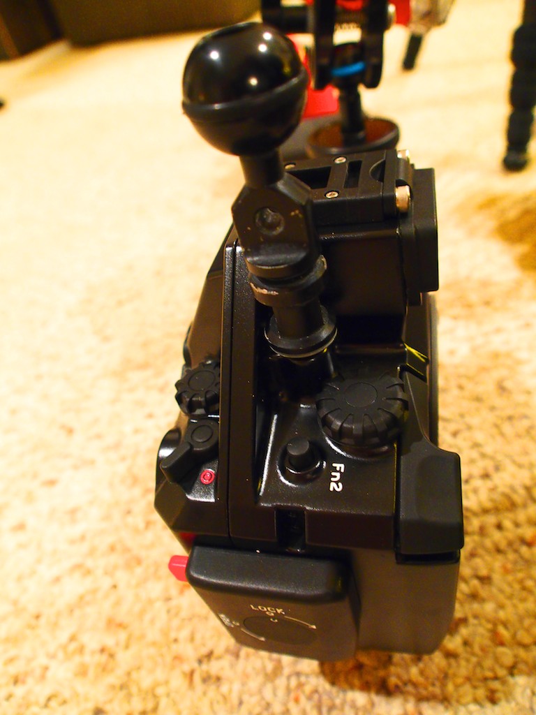

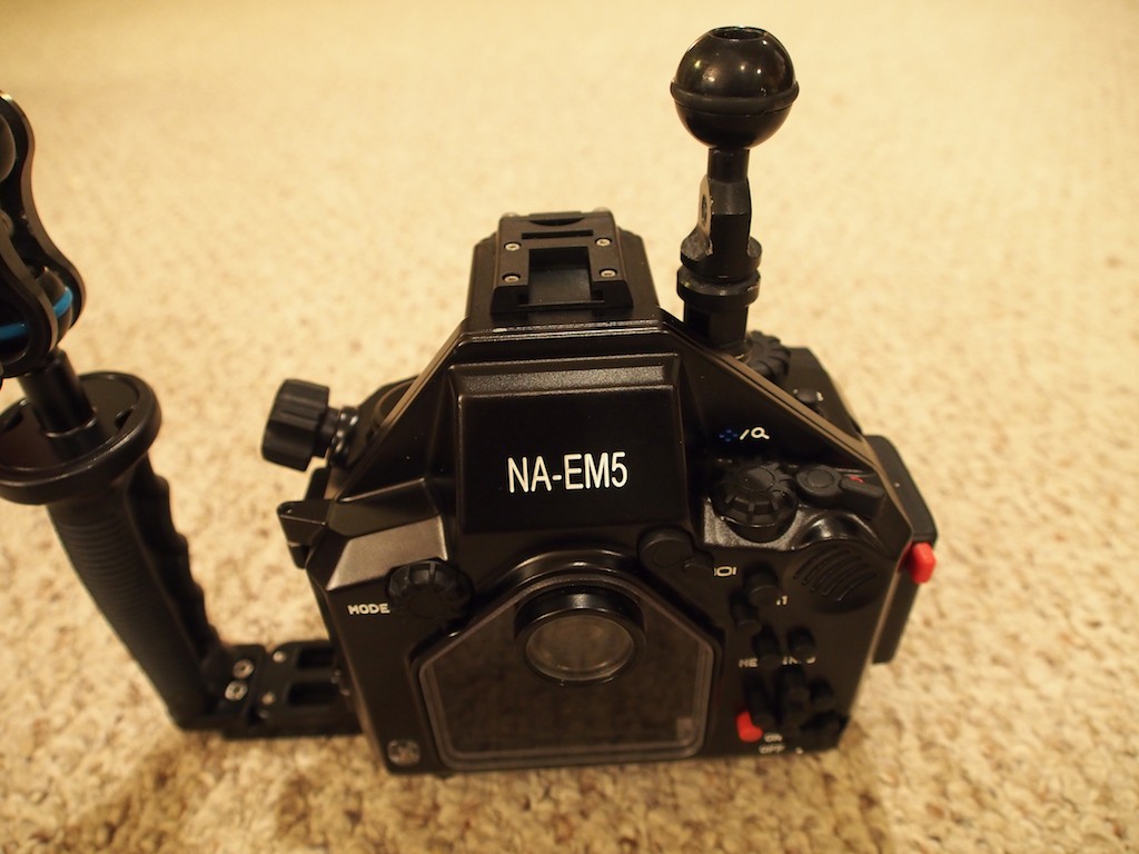

    I think the configuration being described above is illustrated in a few of the attached photos, minus the hand strap which simply attaches to the right hand side of the housing. An M10 Strobe mount (aka 10 mm or 1 cm diameter threaded ball mount adapter) fits into a threaded, reinforced slot at the top right side of the NA-EM5 housing near the Fn2 button and top control dial. I took a few photos of the stripped down system without a port or fiberoptic cables, just to show the Flexitray with single Left handle, and the M10 ball mount adapter, each with a single strobe arm. As mentioned previously, this allows you to have a better hand grip on the right side of the housing for shutter and button control, but allows right and left strobes to have separate attachments, and the cold shoe slot is free for a ball mount adapter for focus/video light. Here ya go:

  17. Thanks Hugh (deepbluemd), the photos show the way i have the rig set up.
