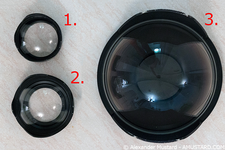

    And here is a comparison of the domes (1. Nauti 3.5", 2. Nauti 4.3" and 3. Zen 9", the 3.5" actually fits into the 9"):
    Alex
    Wow fantastic writeup, so it seems the 3.5" is a better choice for the 8mm lens providing more compact size and closer focusing flexibility !? Any reason to use the 4.33" dome then?
    Andrea
  10. I'm not sure I'd want to be that definitive, Andrea. The 4.3" is certainly going to be always equal and sometimes better than the 3.5" with the 8mm. I've not shot them both enough to really be sure of the differences for classic wide angle shooting.
