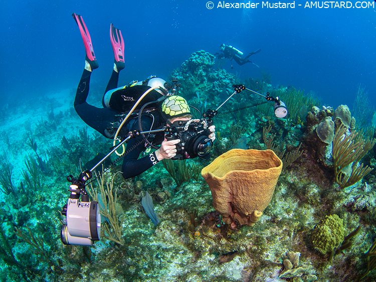

  5. I use the Nauticam NA-EM5 without a tray or handles, and to me, holding directly only the housing, it does remind me a little of my RS. It is quite similar in size. I'll try and take a photo of them side by side. Maybe I should cable tie a big chunk of lead to the bottom of the housing, so it feels more like the RS in the water too!

  10. I am happy shooting it that way. I like holding the housing directly (like a camera) and like the strap, which is makes one handed shooting very simple.
    However, I think the tray remains the better solution for most people, most of the time. Even though it greatly increases the size and weight of the rig,
    Alex
