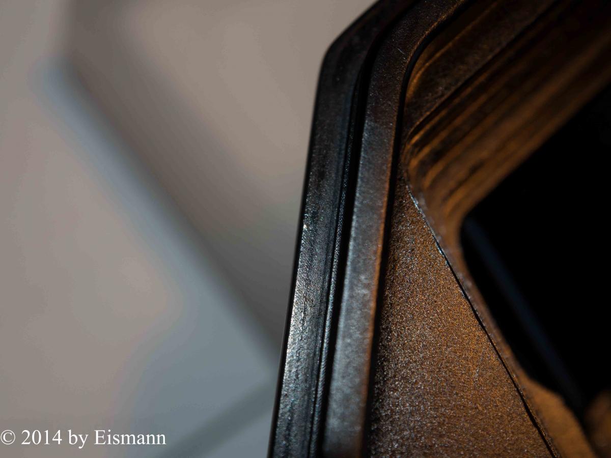

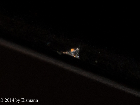

  7. Hello dear diving-colleagues,
    after one wonderful week of diving in Madeira I have recognized a tiny, almost unnoticable crack in the anodized surface of my new Nauticam housing. It is located at the inner side of the rear door just near the main O-ring and is continously in contact with saltwater while diving.
    Can anyone give me a hint if this is something to worry about in terms of corrosion of the aluminium body or just to forget, as ist does not affect functionality.
    Thanx in advance and have a nice weekend,
    Eismann
