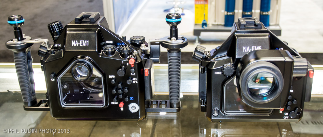

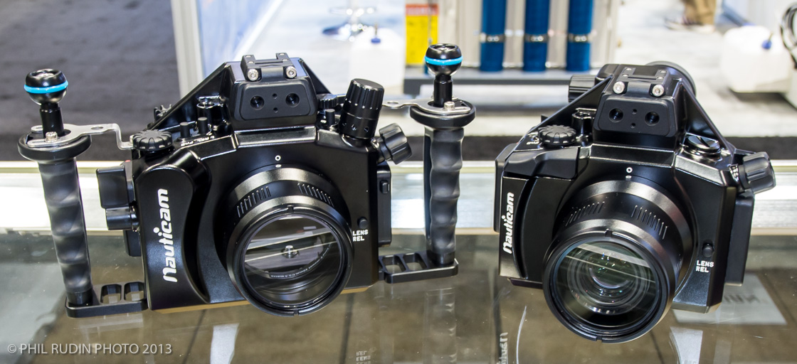

  3. Hey Phil,
    Since you now have both, could you post a photo of the two housing systems next to each other? Would really help appreciate the not so great size difference.

  5. Hi Mike,
    These photos were taken at DEMA and the E-M1 housing is a prototype. The final housing is the same size but there are differences in the control configurations.
    Some of the notable differences are that the aperture dial on the top left side of the housing has been moved to a dial under the shutter release so you can change stops without moving your finger of the shutter release. The Nikonos type port lock on the side of the housing has been replaced with the signature Nauticam DSLR port release and it has been moved to the front of the housing near the lens release. A great AEL/AFL vertical lever (like the shutter release) has been added to the rear door. I have set this up for auto focus so I focus with my thumb and then trip the shutter with my forefinger. This allows you to set focus once and then shoot as much as you like without the shutter release refocusing the camera, great for macro. I set the E-M5 housing the same way using a rear button but it made the camera lockup and I had to go back to shutter release focus. This is a well documented issue and it has never been fixed in all cameras that I am aware of. Go to Nauticamusa.com for photos of current housing.
    Edited by Phil Rudin

  7. Hi Phil,
    What is that optical thing on the M5 back?
    Bob
  8. Hi Bob,
    Both the E-M5 and the E-M1 have user replaceable rear LCD windows as an option to allow installation of the excellent Nauticam 45 and 180 degree accessory optical viewfinders. Both housings come with a pickup finder for those using the EVF, but the optical finders greatly inlayer the viewing area and are very popular with DSLR users. It is all about how much you are willing to spend to maximize results.
    Mike,
    Much larger size difference between 70D, D-7100 and other DSLR housings than between E-M1 and E-M5 housings. The DSLR housings have a larger port mount because of the much larger lenses so it is not really apples to apples. The Olympus 12-40 is without question a better lens than the 12-50 image quality wise, in fact it is at this time probably the best M43 zoom made. For underwater use it depends on how you intend to use these lenses. With the 12-50 behind a flat port you will get better results at the quasi macro end of the lens. The 12-40 needs a dome port for best results and is a shark/diver/reef/fish portrait/1:3 or 4 lens with better image quality. It requires Nauticam's seven inch dome for best results. I used it yesterday with the ZEN optical glass 170mm dome port using 20mm and 30mm extensions. Still trying to work out what extension length will give best results with both 7-14 and 12-40 zooms. For me it will be 60/50mm for macro, 8 fisheye and 7-14 for wide angle and the 12-40 for everything in between using the Nauticam 65 macro port, Athena 50 macro port for Olympus 43 50mm macro lens and the ZEN 170mm port for 7-14 and 12-40. I am sure other will be quite happy to shoot the 12-50 in the Nauticam port and a W/A lens of their choosing.
