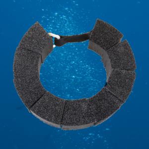

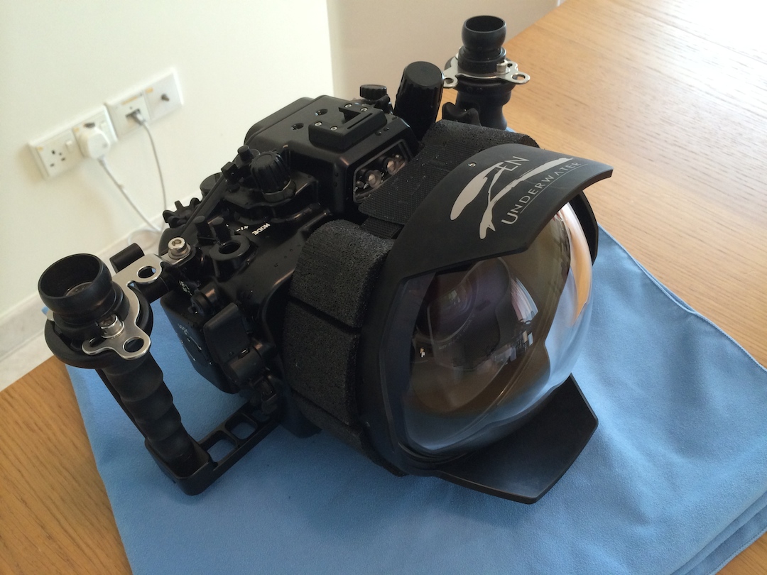

    I have solved the buoyancy / balance issue with the NA-GH4 and the Zen 170mm Port - with some help from David Cheung of ScubaCam, here in Singapore.
    A Stix float ring. I had to trim about 0.5cm off the side of three of the floats so that it tucks in behind the port on the right-hand side (the housing body has a bulge on the right for the control rods). The Stix ring locks down nice and tight.
    In a pool test this morning, with the Luma4 lights on 1" locline arms, the housing is still a little negative (good) but no longer excessively front heavy. In fact, if I move the lights into the right place for WA shooting, the whole rig becomes neatly balanced around the centre pitch line. In the sea, I think that it'll be slightly negative and well-balanced.
    Here is a photo:
    Regards
    Peter
