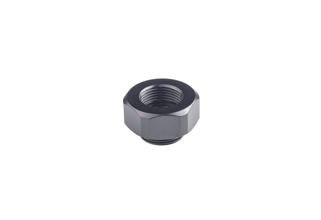

If you could find a Nauticam 26526 m14 offset vacuum valve you might have a chance but I think they are discontinued. With enough money Dive and see might be able to do something custom??
We really should move this thread to a new forum regarding custom battery solutions, but oh well here we are... This might work (as the 16mm isn't discontinued yet). And actually they still might be able to make the M14 one as the description says they are manufactured on demand.

We really should move this thread to a new forum regarding custom battery solutions, but oh well here we are... This might work (as the 16mm isn't discontinued yet):
It would be "clunkly-ish" but you could do a this
No image preview
M16 to M14 Step-Down Adapter ~for Electrical Bulkhead
Allows for the use of M14 electrical bulkheads in M16 housing sockets.
and this
No image preview
M16 Offset Connector with Dual Activation Vacuum Valve ~C...
This dual-activation offset vacuum valve supports creating a vacuum with either the hand pump or via a low pressure inflator. The offset allows the bulkhead to be used for another purpose such as an e
I thought the same but he would need the other way around. He has an M14 threaded hole on the housing.
Anyway, as Chris suggested, this should be ok:
https://www.backscatter.com/Nauticam-M14-Offset-Connector-w-Vacuum-Valve-II-Pu
Once we have an M16 thread hole, what kind of connector do we need on the cable?

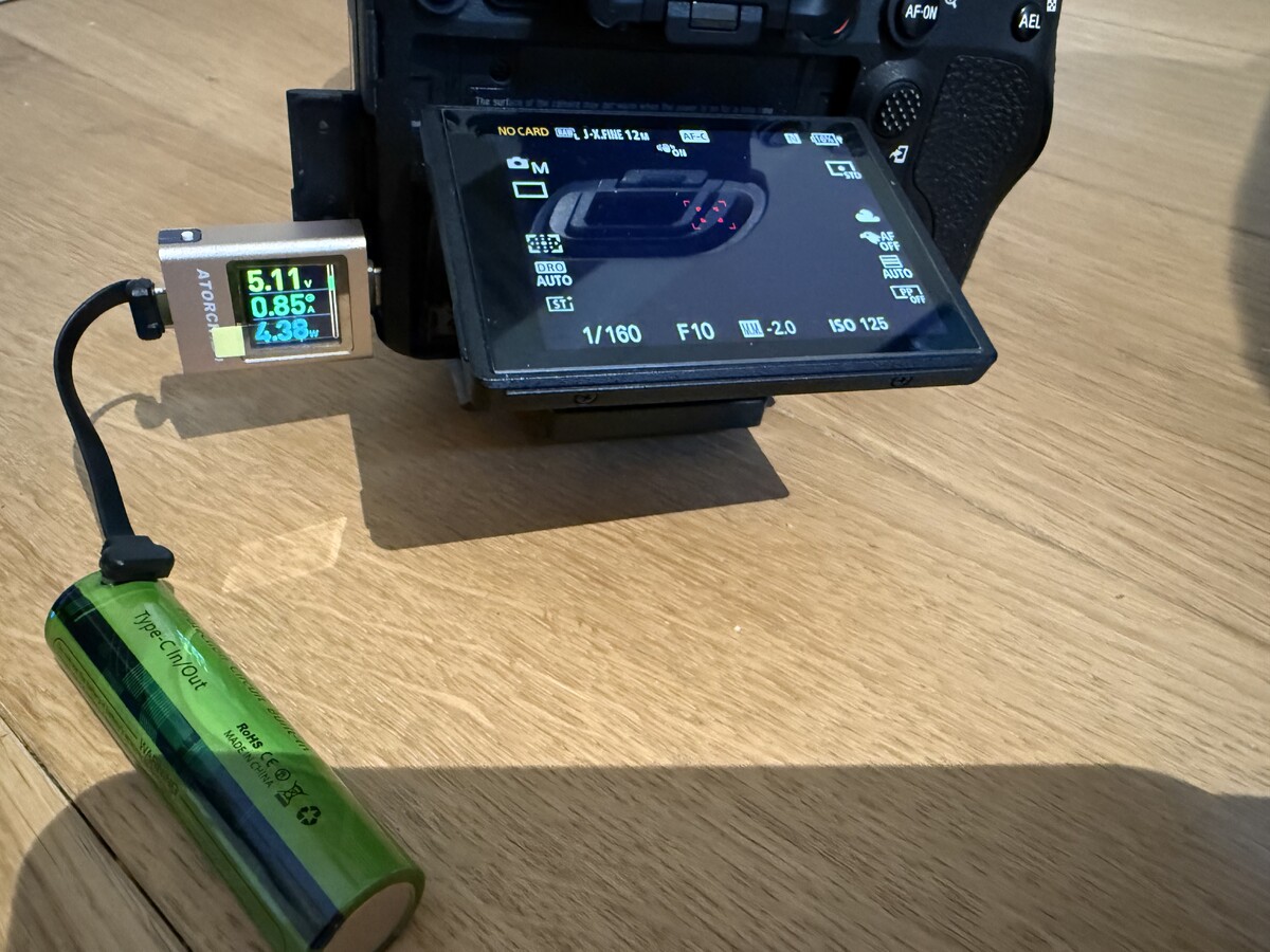

I'm super happy; while building the custom battery for my wives housing I starting thinking if I could do something similar in my Nauticam Sony A1 housing. My solution is exponentially easier, and anyone with a similar housing can do this with no electronic knowledge required!
A bit of background, I noticed you can buy 21700 batteries with bi-directional USB-C circuit charging built into the battery itself; I was wondering if something might exist for 18650's as well; and it took some digging but I found some (and I was order #1001 AKA#1) so I don't think anyone else knows about them:
LBF Battery
No image preview
Button Top Protected 18650 3500mAh Flashlight Battery Typ...
【Battery Specification】Battery type: 18650 Button Top PCB Proctected, Capacity: 3500mAh, Wh Rating: 12.95Wh, Voltage: 3.7V, Size: 18.5*70.5mm(0.72*2.77 inches), Feature: Type-C Input/Output, Quantity:
That combined with this from Amazon:
https://www.amazon.com/dp/B0F8HW858S
And it fits perfect in the housing. Just put a little electrical tape over the positive/negative ends for safety; plug it in and you are good to go. If my math is right this should add about 70% capacity to an existing Sony battery (aka 1-2 more dives).
Here it is installed:

I don't understand, do those batteries provide output voltage even through the USB charging port? Can you take a photo of what you've assembled? 1 or 2 batteries? A 18650 doesn't fit in my housing. The only free space is the space for the strobe trigger, but even there there are only 5 cm.
The last photo shows the 1x 18650 battery in the housing (green thing on left) with it plugged into camera and the camera charging. This battery has a built in bi-directional USB-C port (most batteries this size only have support for charging the battery, not charging a device - but this one does).
As you can see in the upper right screen shot, it's charging my battery via USB-C.

USB-C delivers 5V, I believe it just ups the V and drops the amperage using a micro boost converter.
Update: Just confirmed (see below)
**I'll keep this thread updated in case my camera starts on fire; you never really know with some of this stuff....
Edited by insomniac
Not sure if I love this solution so far, the battery is getting pretty hot during the charging process. It would probably be ideal to run two batteries at 7.2V for this solution; but that requires "work." I'll keep an eye on the max temp of the battery with a thermal camera and report back.
Edited by insomniac
Wow nearly 4A, really too much
Yeah, the charging circuit on this battery is not safe at all... My custom solution earlier in this thread is exponentially safer. Can't say I'm surprised #china.
So let this be a warning of what not to do or you could start a fire.
AKA: Only buy batteries from reputable sources; and if it's hard to find something there's likely a good reason for that.
These batteries are immediately getting disposed of. But the "silver lining" is these things did start "rebooting" on their own when max temp was achieved.
Edited by insomniac
