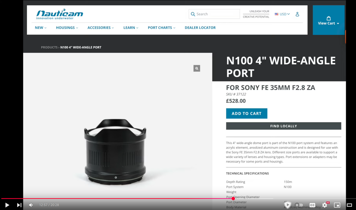

Finally catching up on Underwater Photography Show episodes and got to the one about curved ports for wider macro shots.
In the comments, @Alex_Mustard mentions using the Sony 50mm with the Nauticam 4" port and a custom 16mm port extension.
Unfortunately the one he mentions has been discontinued. There is a N85 version available which should still work with the 50mm macro, but Nauticam's N100 to N85 adapter (which would have been perfect as its 20mm) has also been discontinued.
Are there any other options other than going fully custom?

I believe you can still get the port but they are special order.
Have a look on UWVisions (Nauticam UK distributor) run by Dr Alex Tattershall and he maybe able to help.

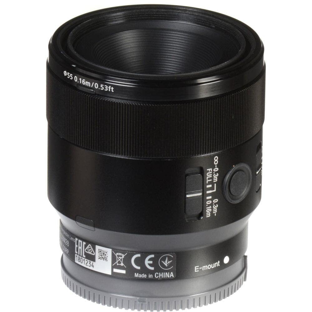

My #36137 N85 4"wide angle dome port finally came in and big disappointment for Sony shooters - the 50mm macro can't fit in the N85 opening. Annoyingly, that's quite a bit of money down the drain.
EDIT: actually on closer inspection, I only need maybe less than a millimeter extra diameter for it to fit.... I'm wondering if I could widen it with something like a dremel...

I'm actually on a N100 system, but I'm using the N85 4"wide angle port as Nauticam no longer make it in the N100 version.
On even further inspection, there's I think the focus ring is just a bit too wide, and there's also a small bump on the lens which is preventing the lens from going in.
You can see the little nub just underneath the label about the minimum focus distance.

The Zeiss 50mm Touit is a better lens for APS-C than Sony 50 macro. Faster focusing, but you need A6400 or newer to get the best out of it. Make sure you get the updated firmware thru Zeiss (FOC) if you have the original V1. Otherwise it won't work properly with flash.
It also has internal focus and is narrower so will easy fit inside N85 accessories, so better in every way. Buy used (too expensive new).
Second point: I opened up a 36125 N85 port by approx 0.5mm to fit a Samyang 12mm. I used a cheap rotary sanding attachment in a drill press (has flip up bits of sanding paper, so good for sanding inside a tube). I packed the inside of the dome first with a rag. When finished, wash the dome carefully. Don't wipe with tissues!

I'm considering doing either this, or taking apart the lens and removing the focus ring. Not sure which would be the easier solution!
