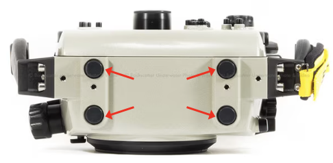

My housing is an Aquatica, for Canon 7D MkII.
I do not have the housing with me so I am not able to share the picture, but I found a picture at internet of a Sub housing where I pointed the rubber protection pads on the bottom I am talking about.
One of them got loose. How do I glue/attach it properly to the housing?
