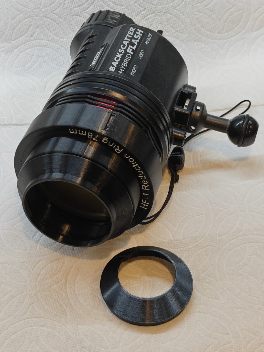

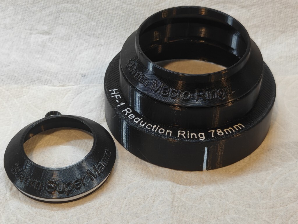

When I shoot macro I typically pair an MF-2 with the HF-1. I add a macro restrictor ring to the HF-1 for a bit more control of the light. I rarely shoot the HF-1 above 1/4 power and will go down to 1/8th when using it for fill light in additional the primary MF-2 snooted strobe on full power.
