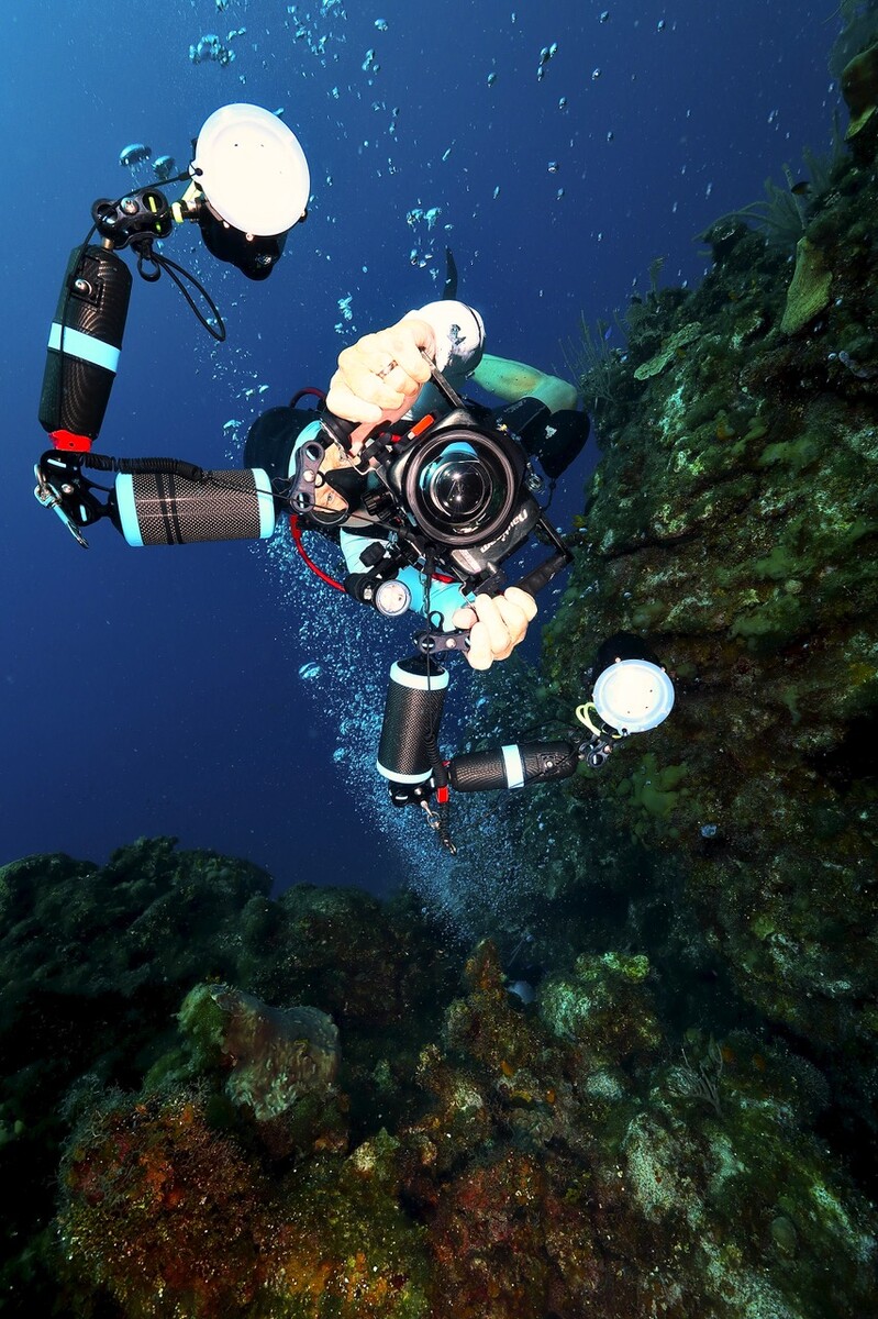

This wide angle photo (of me) taken with the Ikelite Echo strobes, Ikelite housed R100, TTL (D.Haas), clearly they suffice!

Thanks for the response. Definitely selling the Eckos with that photo and the Roatan pics.
