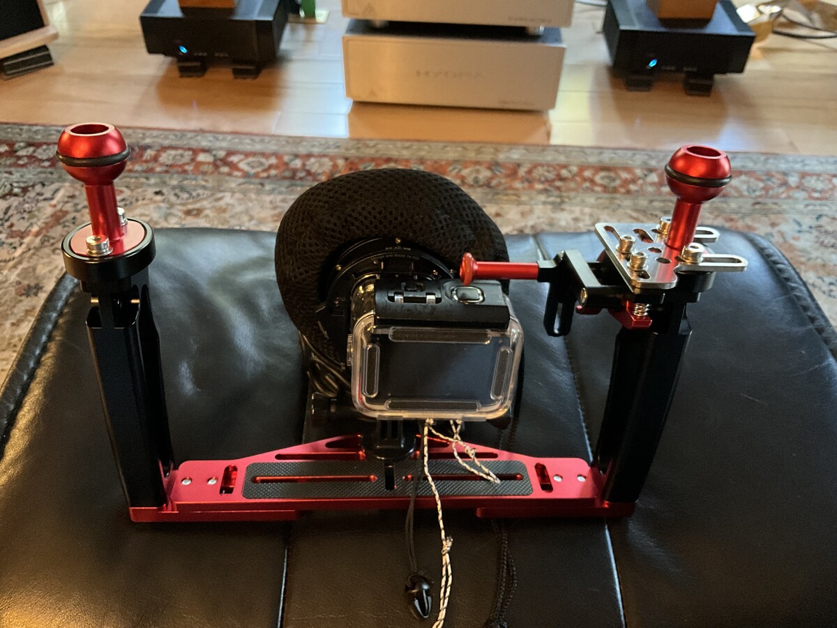

This is my fully pimped up GoPro with an extra shutter release mechanism from AliExpress. I rarely use it this way but it was OK with gloves

Nikolausz,
Thanks!
This is similar to what I found (leaning toward Amazon rather than AliExpress for the trigger, but there are several "brands" and prices that all look the same).
Are you happy with the interface between the trigger, tray, and GoPro? Which tray did you use?

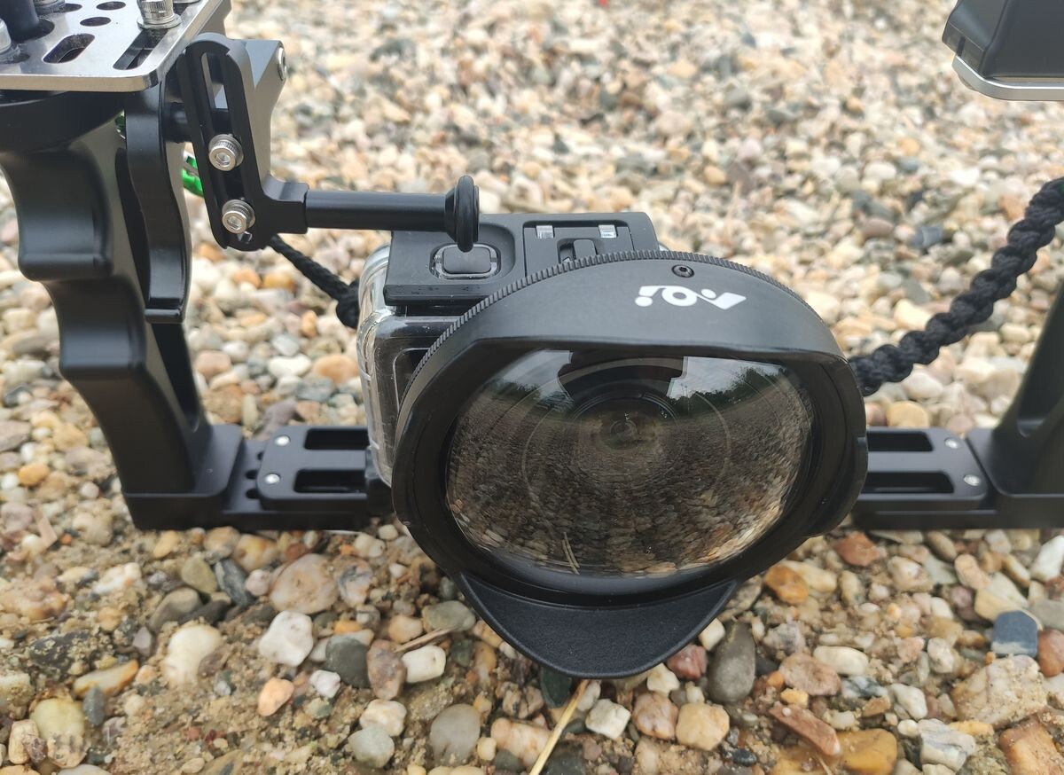

I received the tray and trigger this morning. It works quite well with my thick gloves. Good value for $100 I think. The weakest point is the AOI wet lens mount, which is flexing than I’d like. Also, I’d prefer a two bolt GoPro attachment as the single bolt will likely loosen and allow the GoPro to twist.
