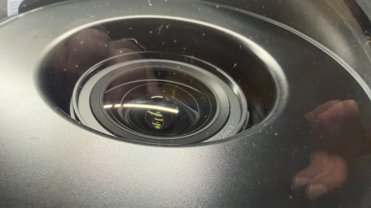

I just got this lens to use with the Dome Port #18414. I have the recommended extension #48457 (54.5mm). Something is off the lens at 14mm with about 1/4 inside the dome port opening causing serious vignetting not seen with other wide angles lens with this port.

Looking at the specs for the 14-30 vs 14-24 lens the total length with lens extended (for the 14-30) is 114mm vs 125mm for the 14-24, this says that the 14-30 should use approximately 11mm less extension than the 14-24 as a first pass guess, however the port charts show the same extension for both lenses, which seems to be an error. A starting point would likely be the 48462 extension at 39.5mm long which is the next smaller extension at least on their extension length chart:
https://www.bluewaterphotostore.com/content/portchart/Aquatica/aquaticaextensionchart.pdf
a 48455 plus 48456 (25.5 + 16.5) for a total of 42mm is another possible combo. If you had some other extensions already for other lenses you could try them yourself.
If Aquatica are working on it probably best to wait for them as this assumes the same position for the entrance pupil in both lenses. They are probably close but may vary a bit in how far they are from the front of the lens.

That’s the conclusion we came up with. I did order the 39.5mm since have a trip scheduled in 2 weeks.
I provide the measurement numbers that Aquatica would need to calculate what extension to use yesterday. Since it’s the weekend I figured I just reproduced a 39.5mm extension in Fusion and that is printing now. I’ll also print a 42mm version that you just pointed out. It’s a crude test to see which one will not vignette but I don't have the numbers of the dome port to find the Nodal point of this dome.

I can confirm that Extension #48462 (39.5mm) is the correct extension for the Nikon Z 14-30mm f/4 using Port #18414 on an Aquatica AZ8.
The sharpness was as expected at the edges at f4 and f8 with no vignette.
