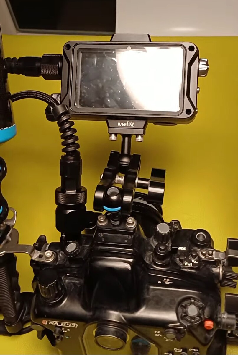

I have recently bought a Weefine WED 5 Pro from Alex Tattershall - UWvisions (excellent service) and I'm looking for ideas of the best way to attach it to my housing.
I have a cross bar, which I bought ages ago but it's too big and doesn't fit. Can anyone recommend a cross bar that would allow me to fit it to the housing but still use the nauticam fabric handle?
The photo attached is just for illitration and I won't be attaching like this in future.
I have thought either a cross bar or 2 small arms with a triple ball mount.
John

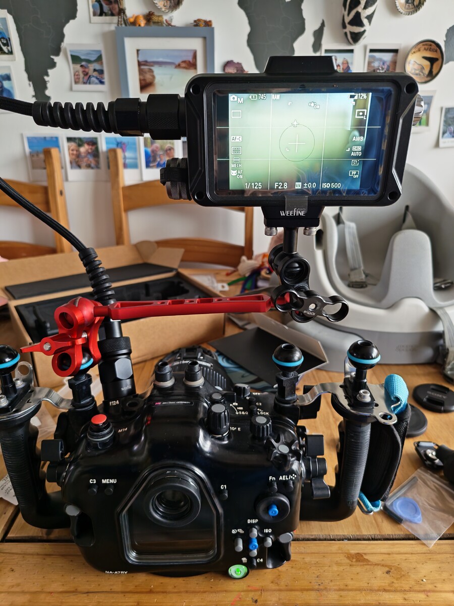

I just use a single standard clamp to the third ball mount on my housing, but it looks as if yours has two "inner" ball mounts. I have a braided handle that attaches via shackles to the holes on the back of that upper plate.
I've used one of these with triple clamps on both ends and then a ball in the center to mount. It works just fine.
https://ulcs.com/product/db-cb10-double-ball-crossbar-arm/
I replaced it with a marelux cross bar which is more rigid and I like it more, but likely won't work with your hand strap. The CB10 was very flexible on how it was used.
It does look like your red arm is threaded - so you could just mount a 1" ball in the center and put two (maybe longer) clamps on either side and you would be golden.
