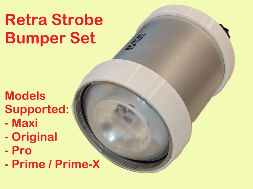

I've made bumpers, reduction rings, and improved knobs for the Retra Maxi strobes. You can find these and other UW photography accessories I've made here:
https://makerworld.com/en/collections/16165730-uw-photography-by-dave-hicks

I got my bumpers and knobs! Super Nice!!
About the standard Retra knobs. They have a cavity inside that could hold water and fit so close to the case that blowing out the water completely might be difficult. In replacing my knobs with the 3D printed Super Nice knobs, (1) I discovered that the shaft itself is Nylon, not stainless! Hmmm, I did not expect that on $XXXX strobes! (2) The cavity seems to serve no purpose and I took a 1/8 drill and put a hole in them into the cavity in exact alignment with the set screw hole such that it intersected the cavity at mid depth. (3) JFYI, the set screw goes deep into the plastic shaft and must be nearly completely backed out before the knobs will slip off the plastic shafts.
I am quite certain that the added hole would allow complete rinsing and removal of any water and since all the parts are plastic I am not sure it matters. But who wants salt water left in their expensive gear, so add the "blow" hole or get some printed knobs that do not have the cavity and have a small gap at the interface to the back plate to properly drain.

About those original knobs. I shared with Retra the feedback about salt constantly forming around the knobs even after an overnight soak. That hollow cavity and tight fitting to the base means they just can't be rinsed out.
I designed the replacement knobs to eliminate the cavity and provide a slightly bigger gap at the bottom to allow for drainage. The mode switch gets a different shape to make it easy to distinguish with gloves on.
