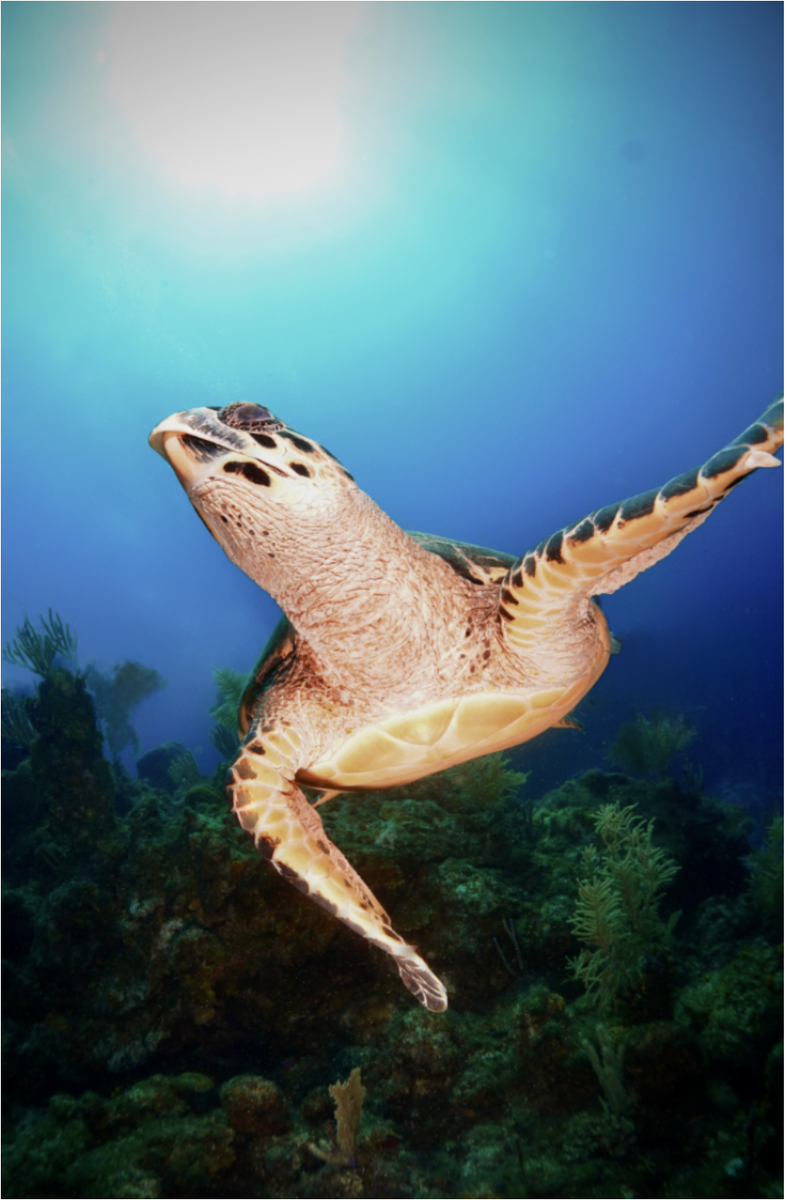

Never used a WACP and understanding that people can have strong opinions and varied experiences, but I cannot recall ever having a flare issue with the WWL-1. I do not think it prone to flare. Less so than my dome. But my dome is acrylic, not one of those high dollars Zen glass domes ;). And I like to shoot back into the sun. Photos with WWL-1 and either a Nauticam NA-R50 or NA-6400.

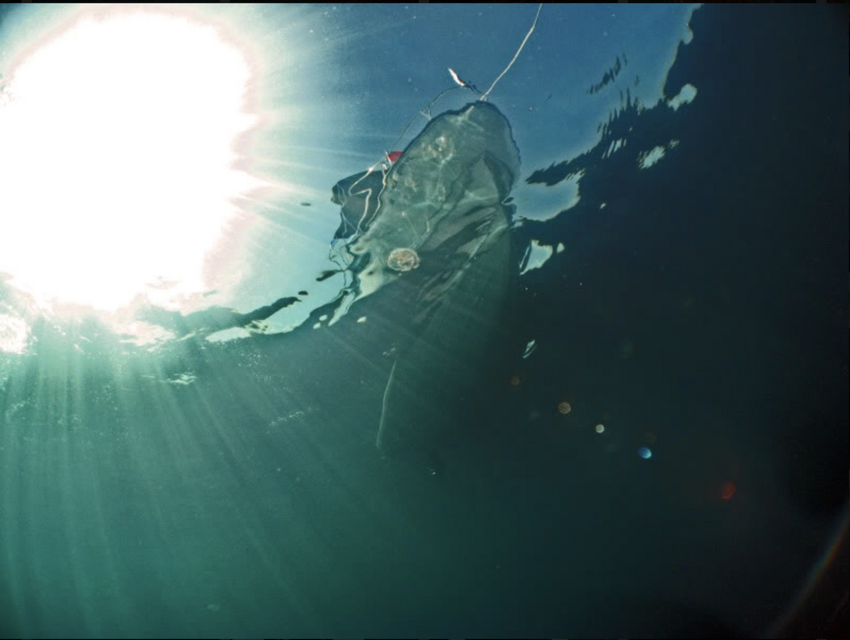

For laughs, Canon A570 P&S, Ikelite case, Inon WAL with glass dome, shot right into the sun with some cool lens reflections that look like planets. Photo sucks, lol, what do you expect for a 5MP antique! Darn thing had manual aperture, iso and shutter! Shallow and bright, a little flare in the lower right corner. Surely the WACP could do as well!
