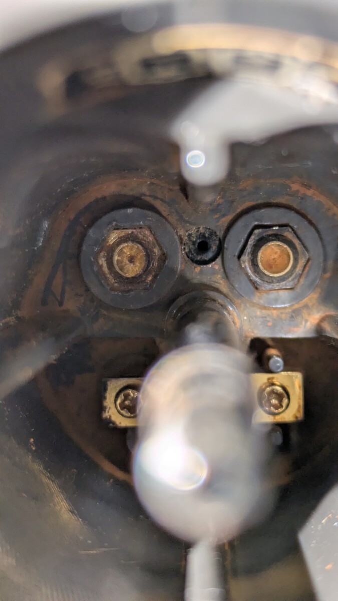

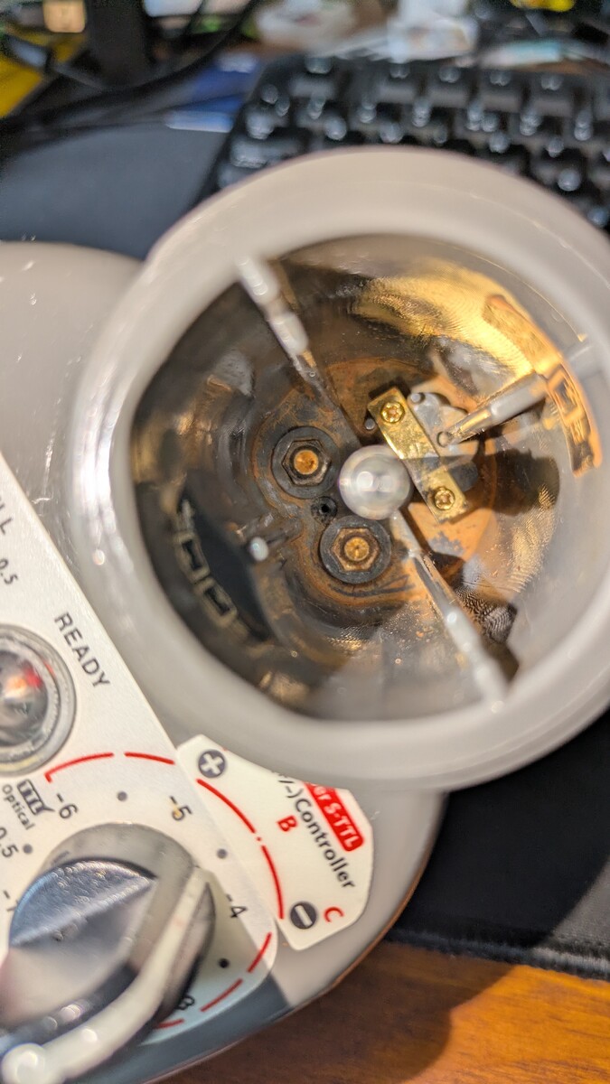

I recently picked up a cheap, "untested", Z-330 and it didn't work on arrival (no surprise!) - but I fancied a project anyway.
I tightened up the "bar" terminal in the battery box and checked for continuity on the inside part of the bolt/nut terminals (behind the glass dome) and it seemed to work after that.
Just wondering if anyone knows whether there is a way to remove the hexagonal terminals to give them a good clean and polish, or even better, get replacement terminals to fit. They seem exactly the same as my D-2000 terminals so I could possibly cannibalize that - but that works fine so I'd prefer to get replacement parts.....if anyone even sells them.
Also......I think it's missing something round in between the 2 terminals - is that something that's essential? Maybe it's a gas release port for if the battery exploded or something? Hopefully it isn't what keeps it waterproof 😁
This battery box is filthy so it definitely had a leak and I guess the previous owner just stripped it for parts like the shade and caps, then got rid of it.
Cheers!
PS. I will clean the battery compartment.....once it's confirmed to be worth keeping!

Thanks Chris!
Sounds like the terminals might be a hassle to replace, assuming they can be obtained.
I cleaned it up today with some vinegar and a brush, think it came out ok, just a bit of corrosion on the terminals but doesn't look too bad. Might just leave them as they are now - I think taking it apart too many times might strip the screw heads or the holes for them!
I didn't notice any obvious cracks but I'll probably get one of the sync port covers (as it's missing) then take it for a dive without batteries or something as a test for leaks - whenever I get out again that is!
I'd try some Deoxit, it's pretty much magical on all terminals.
Frequently carried in music instrument stores or else easy to find online. I use it for rebreather maintenance.
