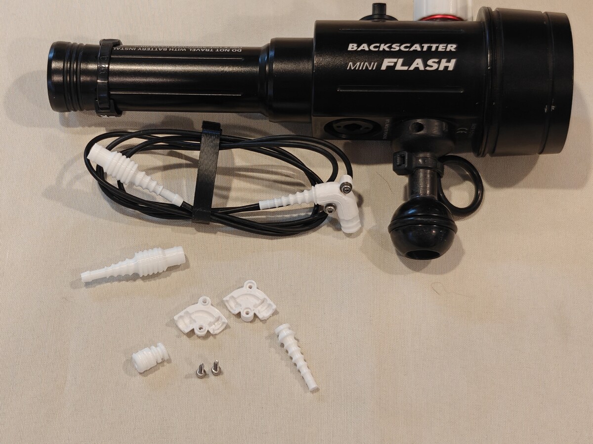

Share a picture of the connectors you want, the terminology is sort of fluid.
This is an Inon/S&S 7mm connector which is the lowest common denominator.

Hi Dave,
interested in the new designed connectors. It would be great if you shared the print files.
Br Markus
They thread on like a cap. I can thread a 1/4 compression fitting on there. But I'm guessing something in TPU could thread on without actually having to print threads.

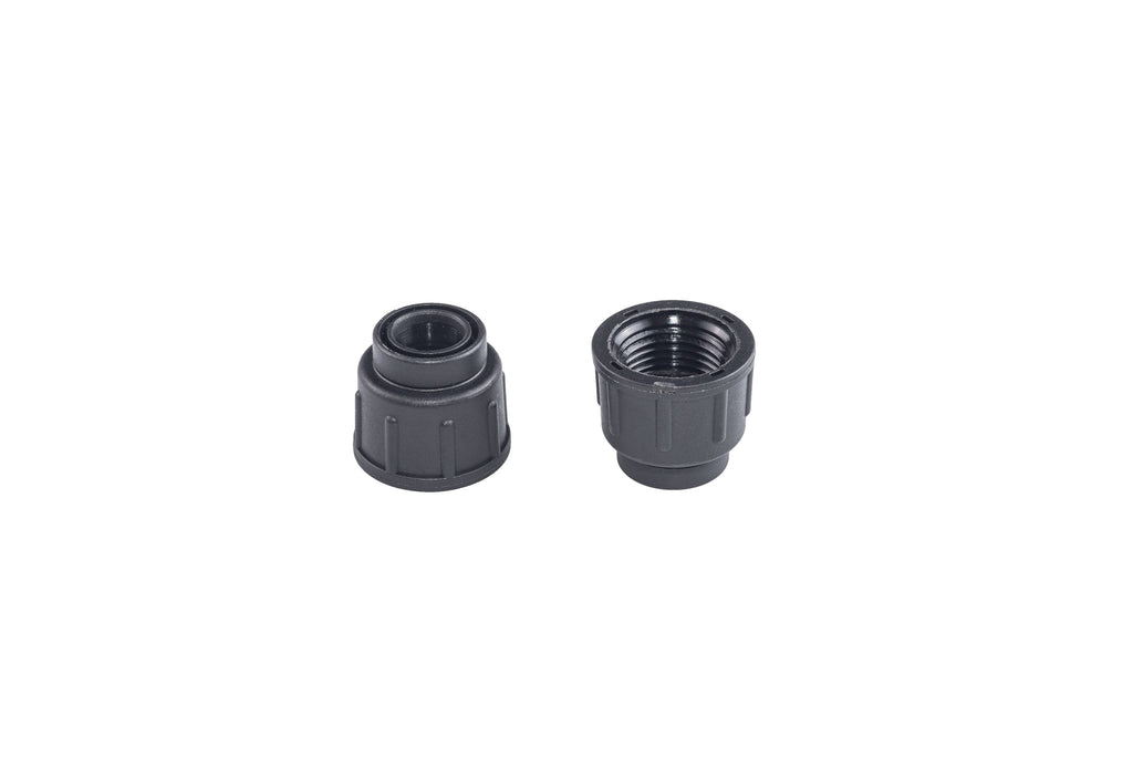

No image preview
Optical Fiber Connector for Nauticam (to use with 26216)(...
For use with the Nauticam Universal Fiber Optic Cable.  Provides connection to Nauticam housings with threaded optical cable bulkhead.
I have been meaning to make one of those. Someone asked me for some of those... I will see if i can knock that out.
