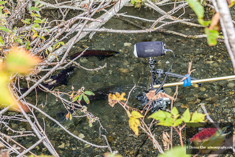

    There is nothing like actually using a product! Even with the round flash tube of Seacam strobes I find that a diffuser is useful when shooting a fisheye lens. The Seacam 250D however did not have a diffuser so I improvised. I used a white almost transparent grocery bag tucked under the neoprene cover. It is in use in the attached pic.
    The main disadvantage of Seacam strobes, except for the latest model, IMHO is that they use proprietary batteries. These batteries might be described as anti-Eneloop because of their short shelf life and rapid self-discharge, basically most unlike Eneloops.
