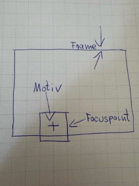

It's not only underwater, its also when I work with a stativ on land (A7R5). I set the Focus point on a not moving object with cont autofocus, and get a larger frame around but not exactly where my focus point is, even when it is something like a intersection of a cross, which is easy to focus. I'm sure this was not the case when I started with the camera in 2023. The example is a 0,5 cm fruitfly, with the focus (hand hold) direct on the eye. I dont know if its depending on the focus point, but the continious autofocus is not aligned with my focus point.

Now I understand exactly what is your problem...👍
When you describe it now, I remember that with my MFT cameras (subject recognition was not working in practice on them) I was always using a very tiny focus point for macro. AF-S with EM5II (which did not have PDAF and tracking was unusable UW) and AF-C&tracking with EM1II.
With A7R5 I use now spot (small/middle/large depending on motif; small or medium mostly for macro) with AF-C&tracking&animal recognition (eye). Sometimes, when AI recognizes an eye, it works very well, but sometimes the AI is even in error, goes to nowhere, and I have to switch it off (easily done with "record" lever). Then I also wished I had a spot, smaller than the S-spot, available for AF-C&tracking, that I can put directly on the eye (or another part of the critter). Probably a very small spot that works reliable in AF-C&tracking is everything one needs for macro...
For me personally, this is a flaw, but not enough to make me change systems (maybe other Sony FF cameras, e.g. A1, have such a very small spot for AF available?).
I cannot remember whether a smaller spot had existed in a previous firmware version, but Olympus certainly had it...
On the positive side, AF-C&tracking&animal recognition (eye) using large area, is a godsend when WA and e.g. snorkeling with dolphins or whalesharks. Especially when it is difficult to carefully look through the viewfinder (sunshine; fast moving animals) and the time for putting the animal (preferentially the eye) in the focus area does not exist. Then I just can aim the camera towards the motifs and press the dumb focus lever (last time I got useful photos from whalesharks, despite the subject recognition was set erroneously to "train"... 😄)...

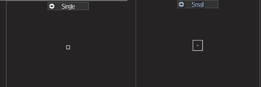

Sony says.. "For [Spot], the subject should be large enough to cover the whole Focus Area (as a guideline). Having the subject at this size avoids the focus drifting to the background."

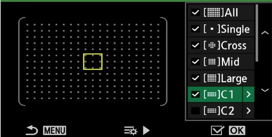

On OM1 the smallest focus point can be adjusted to a smaller area... looks like down to a single autofocus dot on the screen? My understanding (moving from Olympus OMD EM 1ii to Sony) is that OM System has the best in camera focus stacking which is why it is popular for land macro, but I don't know if the stacking is usable underwater, and without it the big advantage of OM System is lost compared to a high resolution camera. Maybe the autofocus has an advantage because of the small spot customisation? wonder if Canon or Nikon have that? The pixel size on the Sony A7Rv is similar to the OM1, so if I crop to MFT size I get the same magnification with a 90mm Sony lens as I would with 90mm OM system and no loss of image quality by comparison, yet I have the extra versality of the large sensor too.
I have not had an issue with my Sony A7Rv and also have custom button and lever set to adjust the focus area (C2) and tracking on and off (record button) (Isotta housing).
Picture below is from the OM1
I'm not sure that's the only reason it's so popular for macro, in addition there's a complete range of macro lenses including the 90mm macro which goes to 2x by itself and at that magnification has the equivalent framing of a FF at 4x. The in-body IS is also highly regarded, the smaller sensor is easier to accelerate to compensate for shake. I have taken shots with the 300mm f4 lens at 1/13 and they have come out tack sharp and can use ridiculously low shutter speeds with the 90mm macro. It's also what allows hand held focus stacking and super resolution shots. Probably not so useful UW, but it does compensate for any movement except for in and outwards and helps hold the AF point on your target.
In addition the smallest AF point in the OM-1 is smaller still and uses a single AF point, while the small option uses a group of points and the camera selects which to use in that area. You can set the number of points the AF point will move with each click of the controls, here is the relative size of the targets:
The OM-1 has 1053 covering the frame quite effectively and they are closely spaced. The only issue with such a small point is it needs to be placed over some contrast, though often a small movement is enough for the AF system to grab. The AF system also works quite well in low light, I found with my old EM-1 MkII it could gab focus on mandarin fish at dusk without a focus light.
