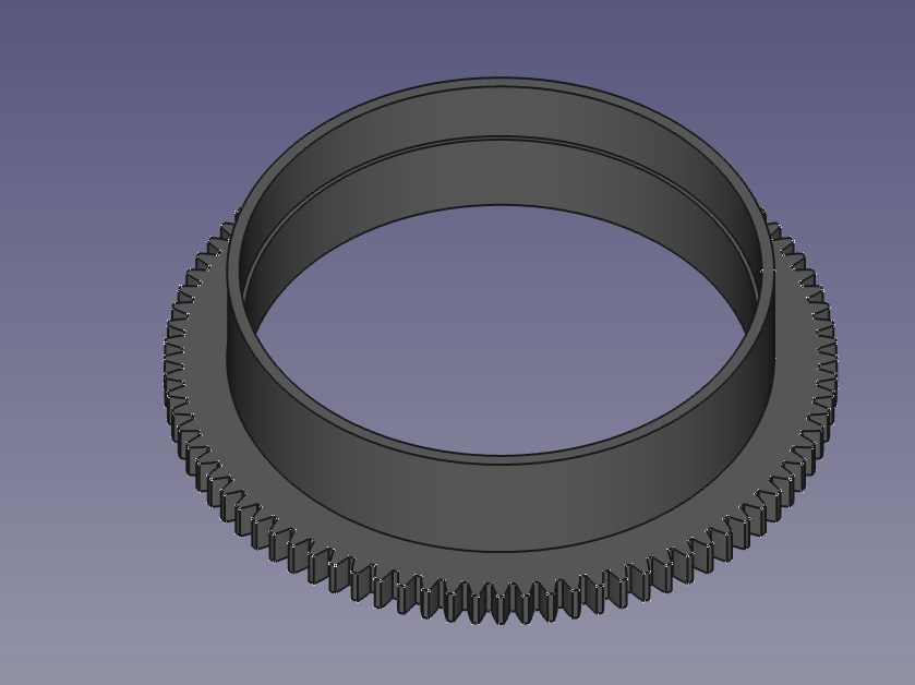

I'm planning to 3D print a zoom gear for the Sony 28-60mm lens. Does anyone know how many teeth the Nauticam N100 port system uses for zoom gear?
It should be 84.
Edit: Or maybe 85? The design I use has 84, but the one linked to below has 85. I can't remember what I based my design on, but it might have been from someone else's design who had potentially miscounted. Either way will likely work.

Thank you all so much for the replies! I was in a bit of a rush and went ahead with my own design after @Isaac Szabo shared the tooth count. It's a single-piece gear and seems to be working well so far. I haven’t tested it underwater yet, but I’ve made similar designs before for my m4/3 lenses, and those worked great.Screenshot 2025-06-13 at 15.03.46.pngZoom2860.stl
