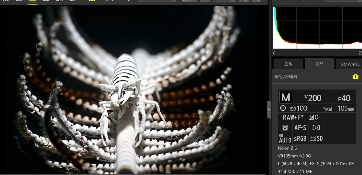

I also use an MF2. I've never felt the MF2 lacks power for macro photography.
Even at f/40 and ISO 100, the MF2's power is not lacking.화면 캡처 2025-11-02 142357.jpg

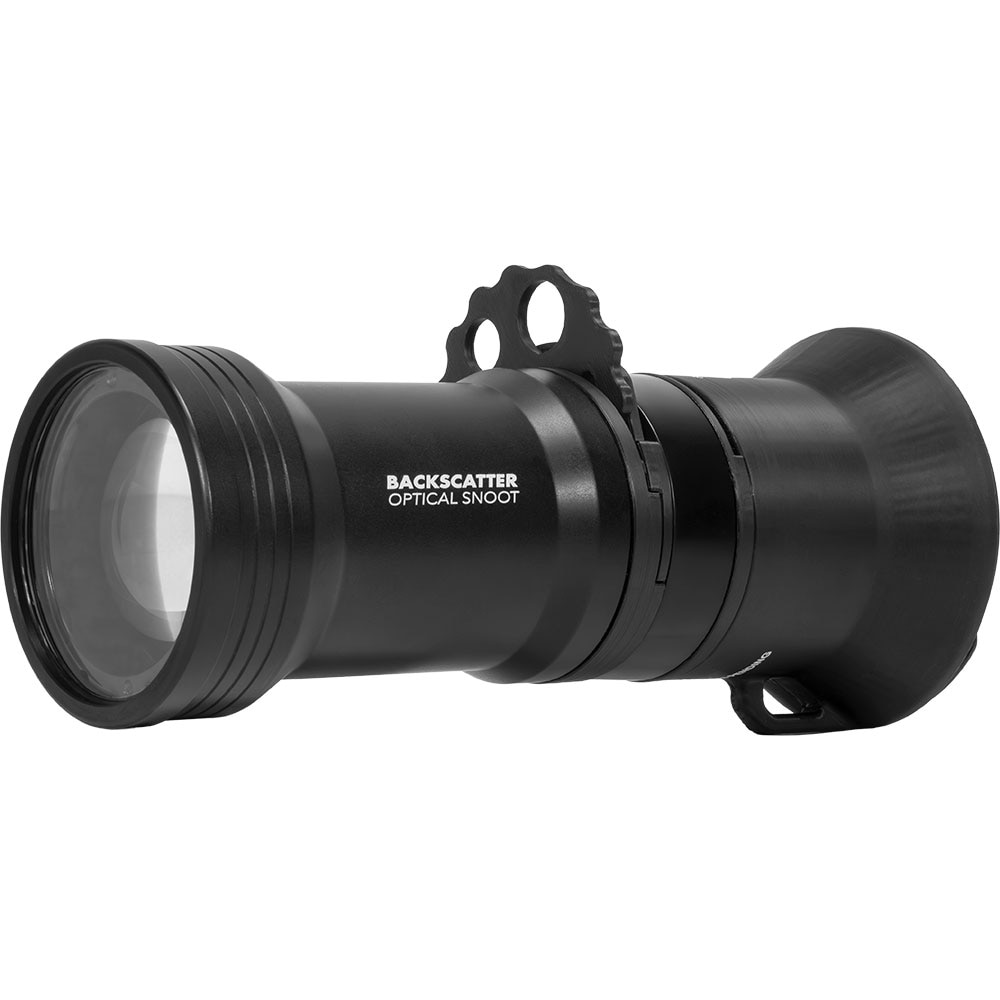

Hi everyone, the day is here! The Backscatter Hybrid Snoot (Optical Snoot 3)
Backscatter.com
No image preview
Backscatter Optical Snoot OS-3
Backscatter Optical Snoot OS-3 for Backscatter Hybrid Flash
