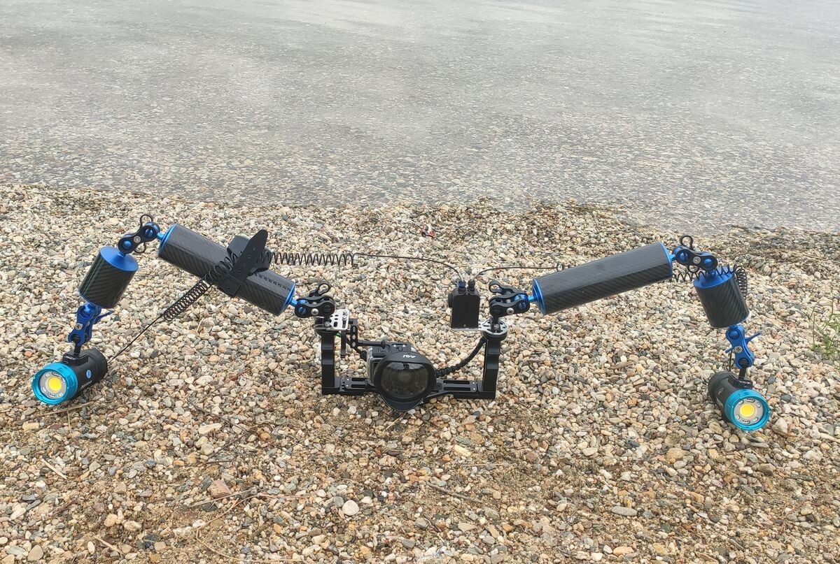

I find my video way more stabilized now, that I have more structure around the GoPro, but I added floaters also to compensate the weight of the torches and wet lenses.
Here is a photo:

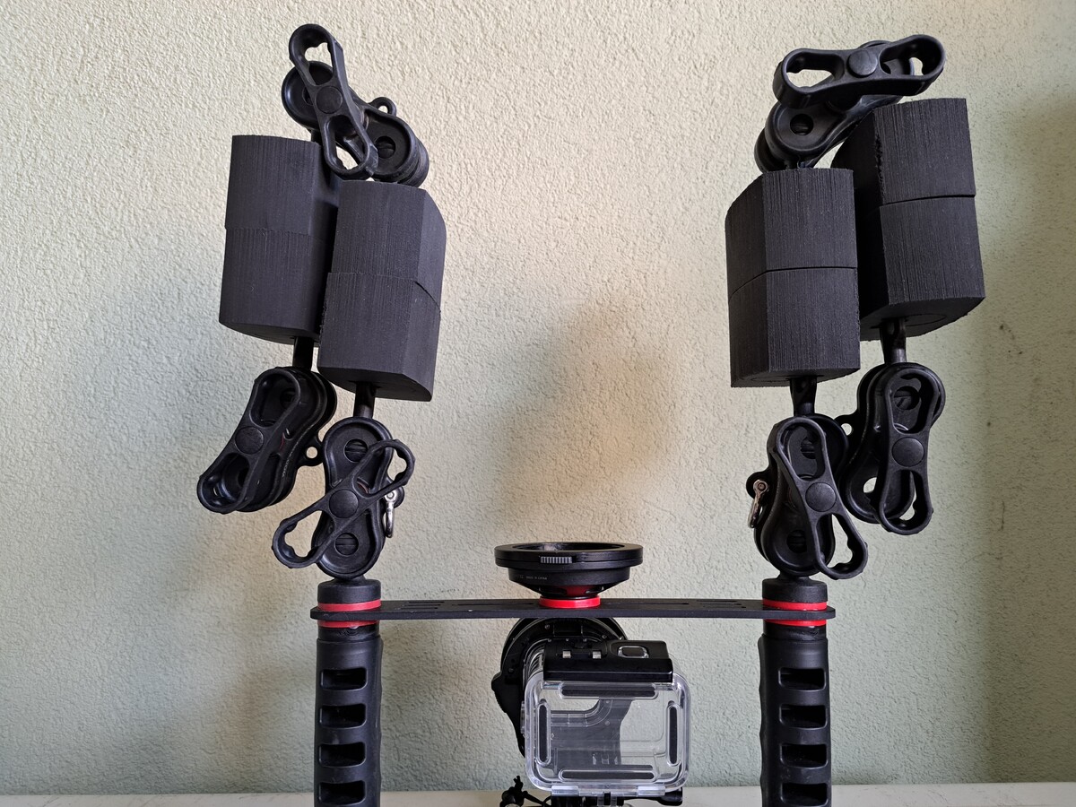

I usually use my action camera on the top of my mirrorless housing, but time to time I use action camera alone. As soon as you add lights it's recommended to use a tray and floating arms. It makes the handling and moving the camera without small handshakes, which results better footage. Here, you can see my maxed out GoPro set up.

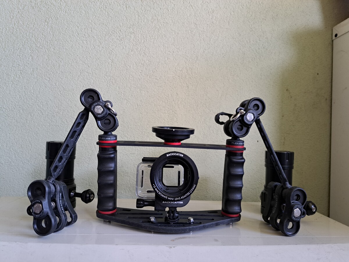

P.s. here is a picture of my rig. 18 cm arms and a couple of chinese lights.

2 hours ago, Gmsalterego said:
Thank you everybody.
I was looking for something not too expensive, such as float foam for arms.
In your opinion which lenght I should choose for arms? 2 or 4 arms? 12 or 18 or 24 cm or wich combination of them?
Thanks. Giacomo

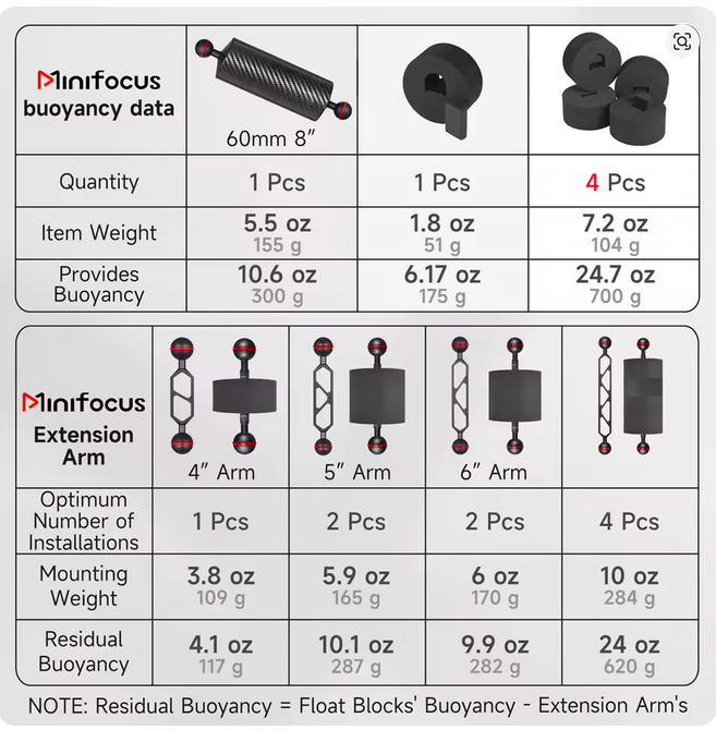

You would need 7 1/2 Stix jumbo floats at 180 gr each, so if your arms are short you might need 2 each side to fit them. 4 STIX jumbo floats are 57 Euro at one store in Europe I saw while the INON mega float is 70 Euro, You might be up for another arm with STIX potentially but the INON float arm is an arm so you won't need another one, so very little difference in cost.

10 hours ago, Gmsalterego said:
I found 1 piece of INON mega float 70 €, 4 pieces STIX jumbo float at 50 €. I found 4 pieces FLEX-ARM float at 30 €. By the way I wonder which is the best setti g in arms I.e. number, lenght and so on.
To solve my doubts I wrote the post.
120g and 175g stix-like foam floats are now sold real cheap on Aliexpress, and they're fine for rec depths.

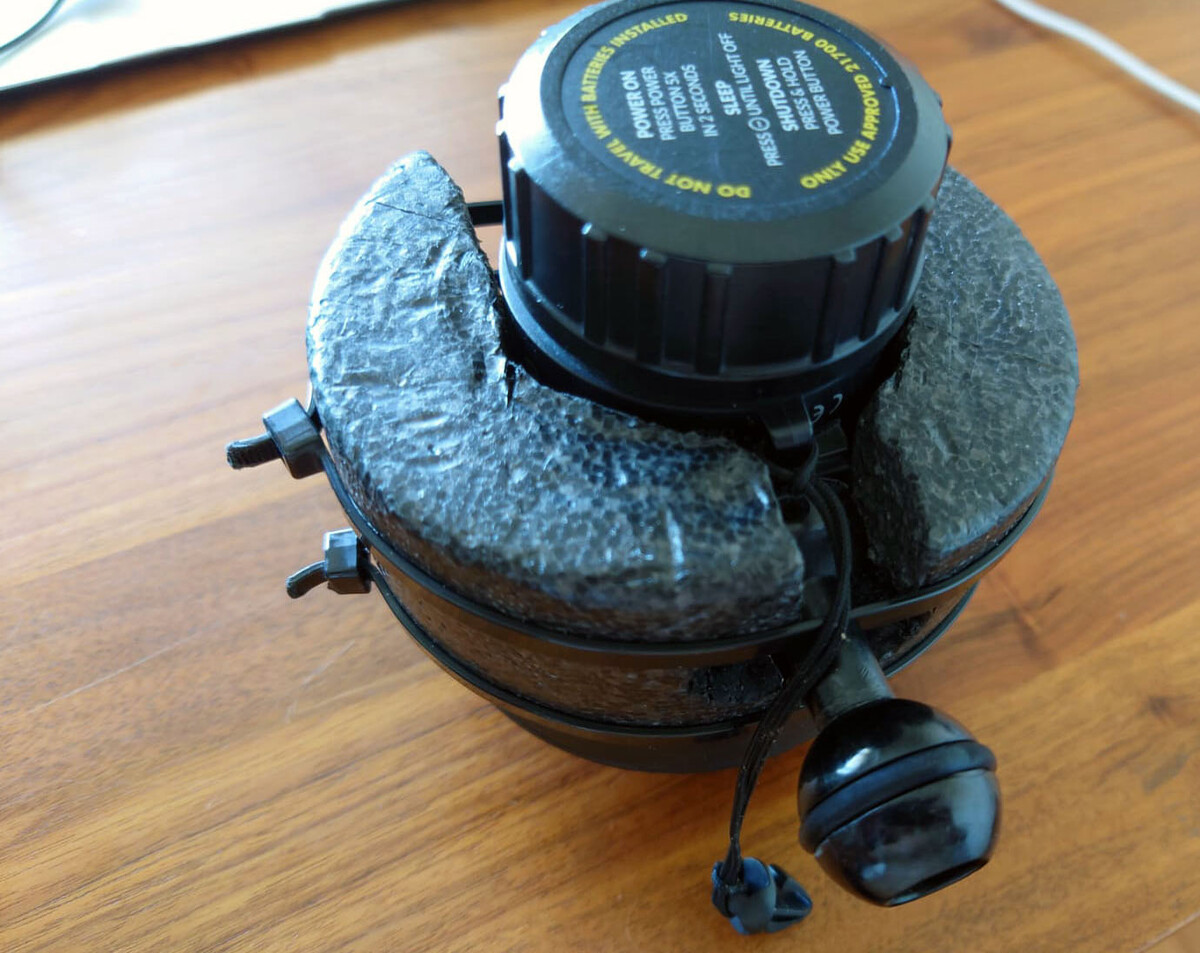

with a bit of DIY you can also make the light itself neutral - this an MW4300 light (-250g in water) with an adapted 10-bar float - not the prettiest but does the job:
Not bad
I make in 3D Printing 2 Float for my wifes lights.same result but only a little bit nicer (with pink color ;) )
