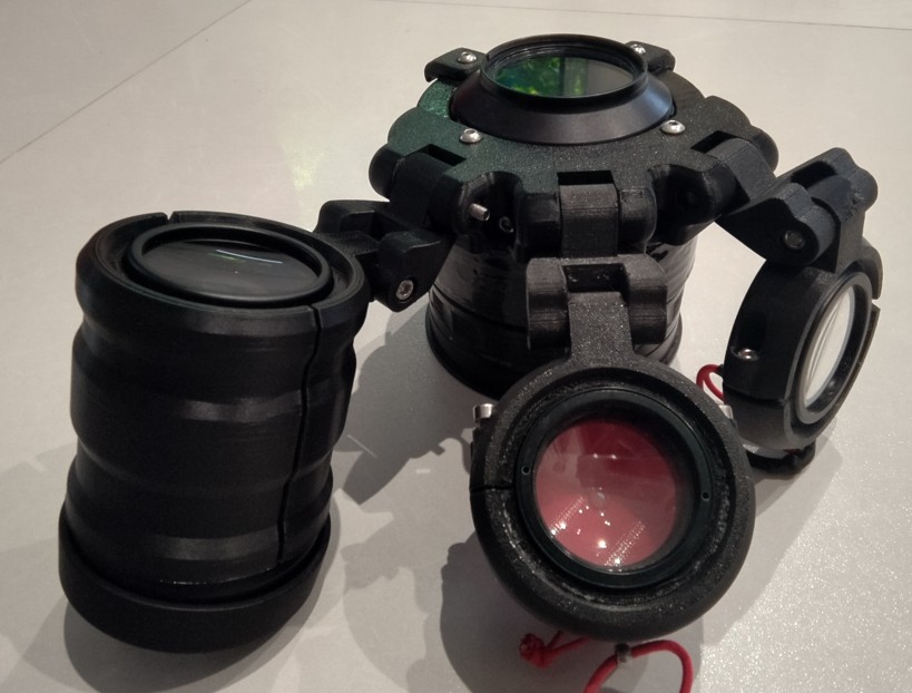

I took the decission to change/modify my double flip into a triple flip
First the H117
Some picture from the build of the first version
Edited by CaolIla
  • Author
Since the first version I made a second in black and a second arm for the MFO-1 and a little bit bigger ring to have more buoyancy

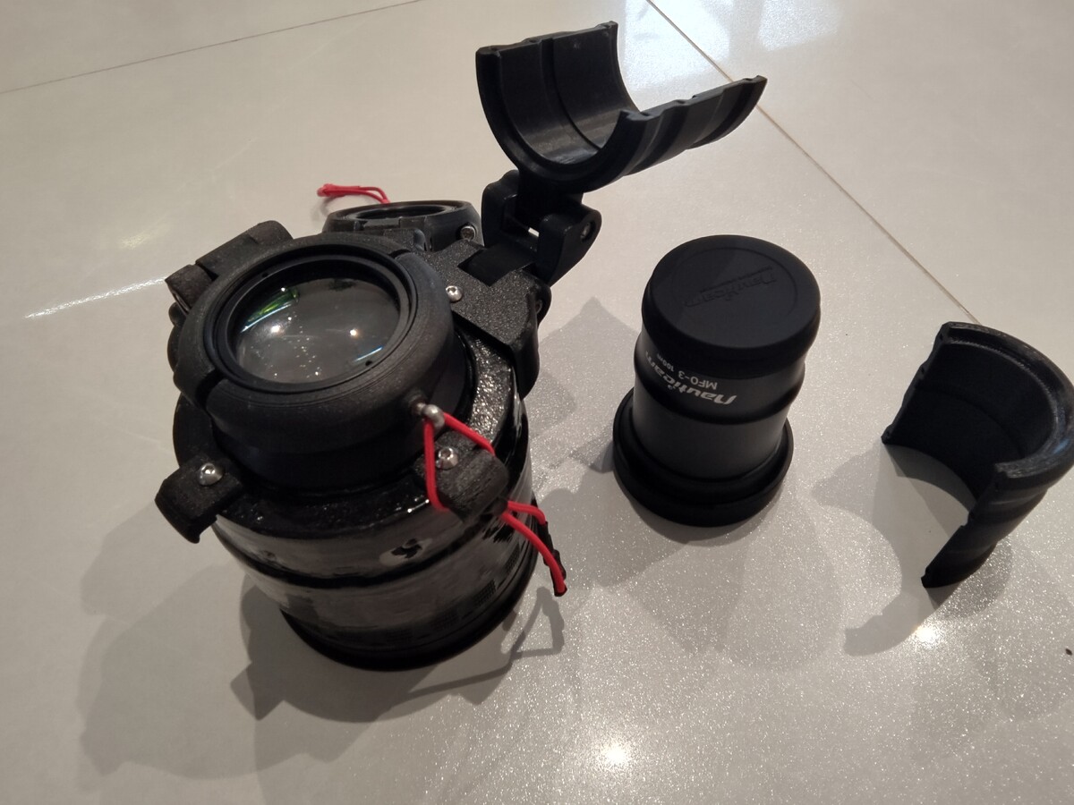

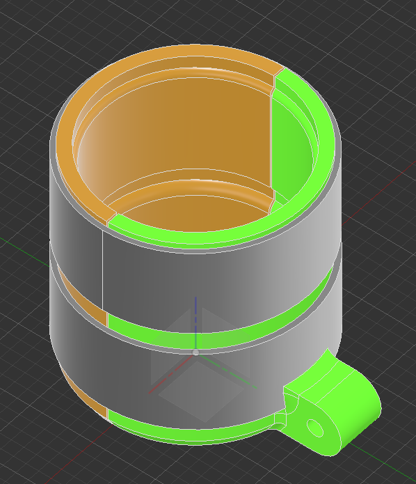

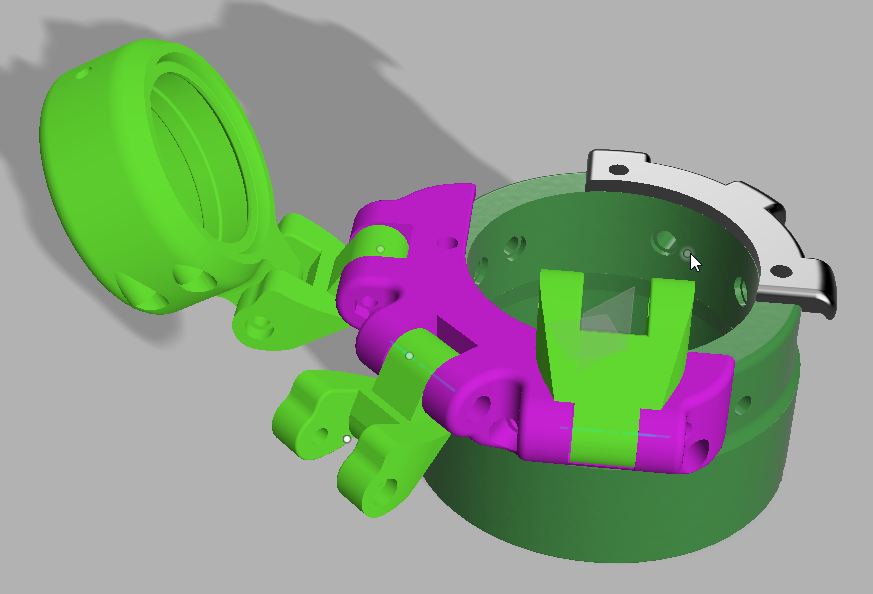

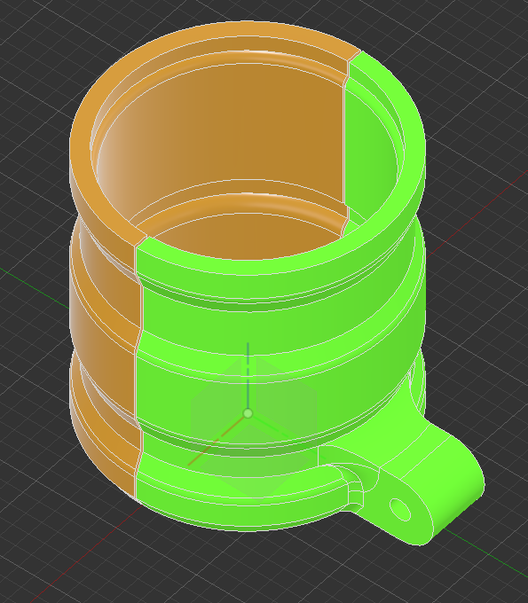

first I need a holder for the MFO-3
The other part I build in the past I put the 2 pieces together with screw. thi time I try something else
  • Author

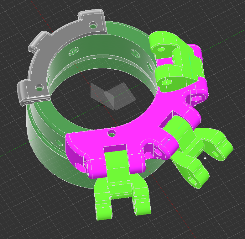

The idea is to put 2 rings (in gray on the picture) printed with TPU the only risk ist to lost the MFO-3 ...
  • Author

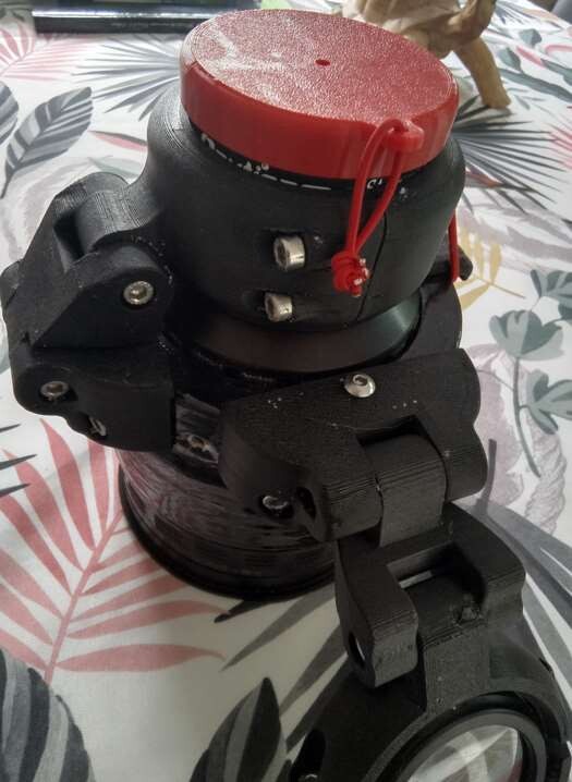

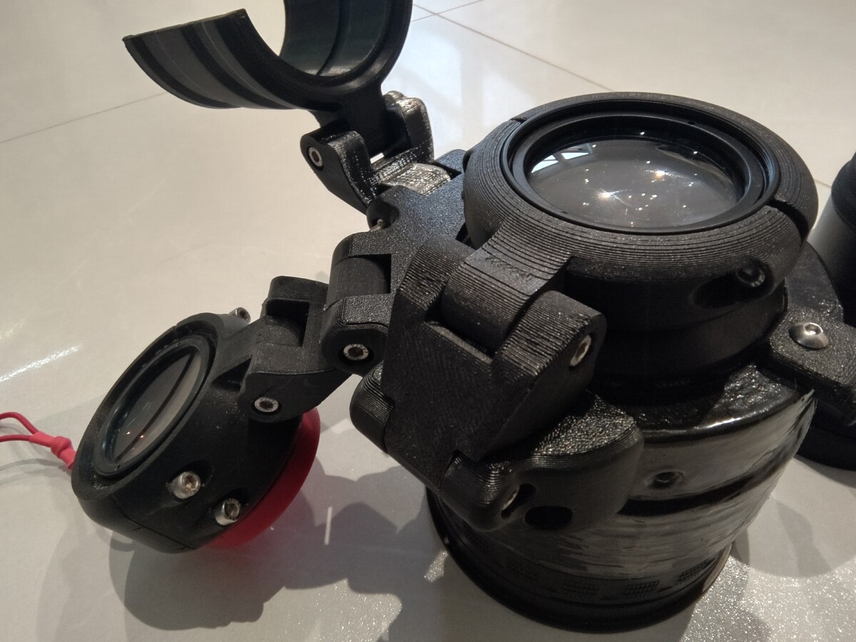

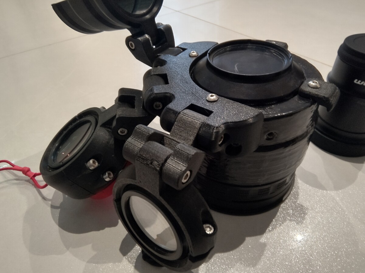

I was lucky with the first solution... then the two hinge was perfectly positionned on the ring to give me the possibilty to put a third in the middle
I build a part with 3 hinge. and on the opposite 3 hooks
All lenses can be put where I want. The idea is SMC on the left MFO-1 in the middle and the MFO-3 on the right.
Ich it's no ok I will switch the MFO depending on the result underwater.

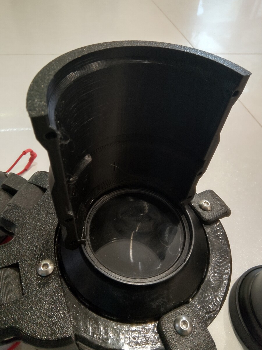

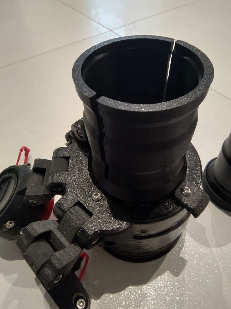

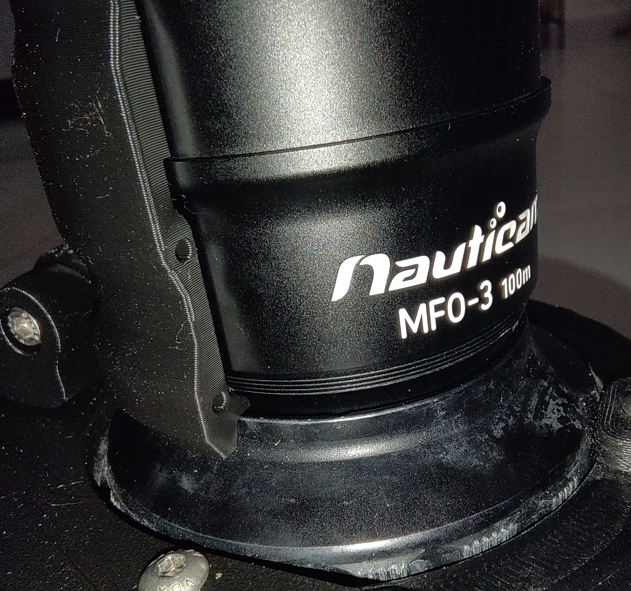

Details of the lens/port jonction.
The thead is protected. The lense didn't touch the glas of the port, it is the holder who touch the port, but not the glas.
  • Author
I forgot a point, I removed the rubber on the MFO-3 (like I made on the MFO-1 and SMC-1) to block firmly the lens beetween the to PTEG parts.

With this setup I'll be able to use my RF100 make some super macro with the SMC-1 If needed put the MFO-1 (80 % of the macros shoots during the last trip) or if there is a bigger subject switch on the MFO-3....

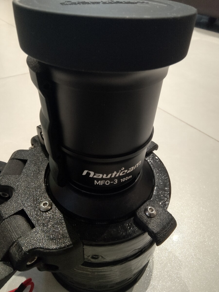

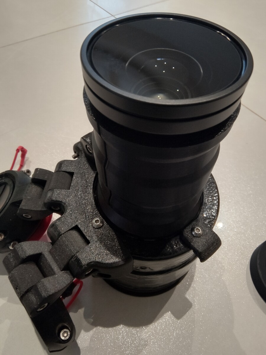

and now the MFO-3
No screw only 2 TPU to maintain the to part in PETG who maintain fermly the lens.
Why in red. because the rest is red AND I have TPU in red AND ist one of this piece starting to break It will be easier visible than black on black.
