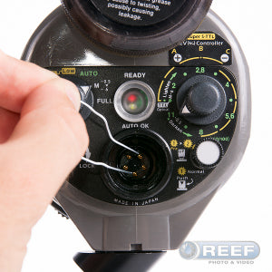

The link above also shows the connectors for other systems, but only follow it if you really need to. It‘s more to cite my source than to invite you to click it.
Shorting out the triggering contacts should trigger the strobe. This trick can also be used on topside strobes. Some (mostly older and studio) models will generate a significant arc. Make sure to have the strobe power,on for a while to reform the capacitors - 30 minutes should work.

Last resort is to trigger the strobe directly on the 5-pin connector. You connect X with Gnd. I found this info on an obscure site:
https://impulsite.ru/viewtopic.php?t=1245
However this site from Reef photo suggests it may not work for a YS-D1, see item 3) :
No image preview
Troubleshooting Strobes With Electrical Sync
Few things can be more frustrating on a trip than when your usually reliable electrically triggered strobes suddenly stop working.
Ikelite has a similar page for their strobes.
