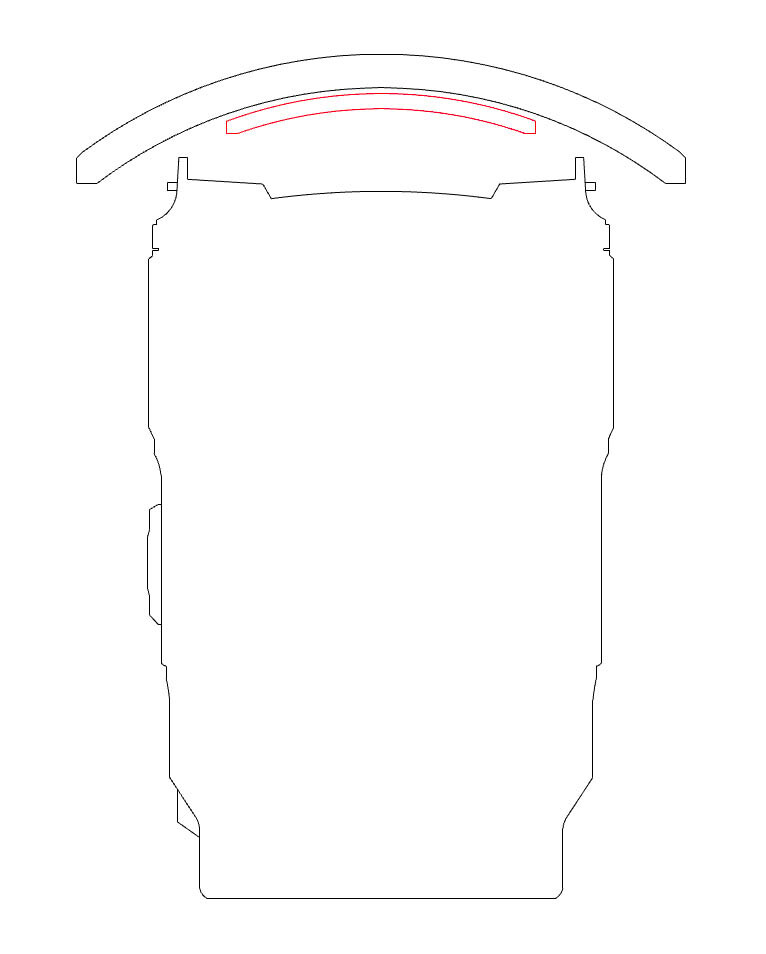

    @Dave_Hicks Yes, shorter is generally better in this case. If the entrance pupil is too far back, the dome's center of curvature cannot be positioned there because the dome will hit the front of the l

Is shorter better in this application?
@Dave_Hicks Yes, shorter is generally better in this case. If the entrance pupil is too far back, the dome's center of curvature cannot be positioned there because the dome will hit the front of the lens first. Hopefully this illustration helps. With the Tamron 90mm, the dome's center of curvature can be positioned over the entrance pupil. However, with the Sony 90mm, the entrance pupil is located way too far back. The dome hits the front of the lens well before the center of curvature can reach the entrance pupil. This lens would require a dome with a much larger curvature.
Edited by Isaac Szabo
Thanks for the explanation! That would
Just now, Isaac Szabo said:
@Dave_Hicks May I ask how you are getting the entrance pupil locations? Your numbers for the Tamron 90mm differ substantially from my measurements.
Internets. There are some tests and a database that puports to list this for various lenses. I will double check in a little while.

This doesn't necessarily have to be the case. Most dome sections are much larger than they need to be to cover the narrow FOV of macro lenses. For example, today I am testing a small (~50mm) section I cut from a 150mm diameter acrylic dome (shown in red) with the Tamron 90mm. So far, the results are looking very good (on par with the Zen dome shown in black):

Ah, yeah that site doesn't have most of the lenses I'm working with. It does have the Sony 90mm, but I'm not sure I trust what it says since it differs from what I measured. I also don't think it gives any info on how the entrance pupil changes with focus (unless I'm missing something).
One interesting thing to note when using domes for macros is that the plane of focus changes from being straight with a flat port to curving a little bit away from the camera with a dome port.
