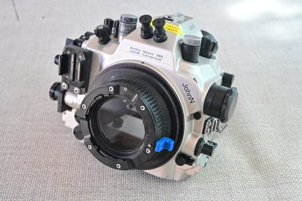

Pic-1 Housing with the 3rd version of the Z24050 port with Nauticam bayonet mount - enouigh is enough!

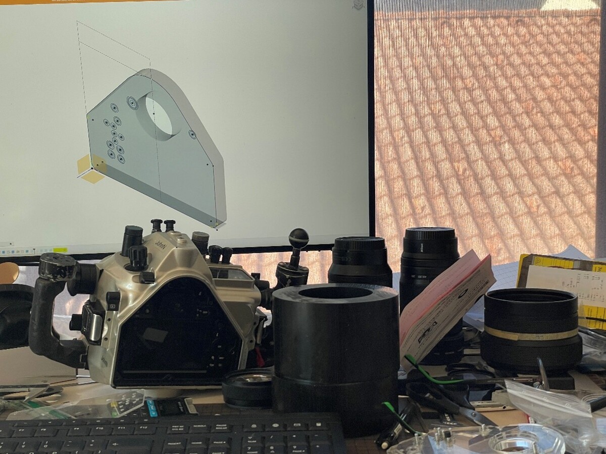

• Learning Fusion 360 CAD software to design the components and CNC work flow to a new level.

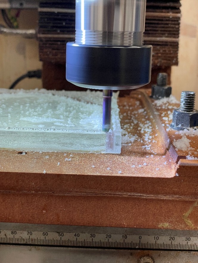

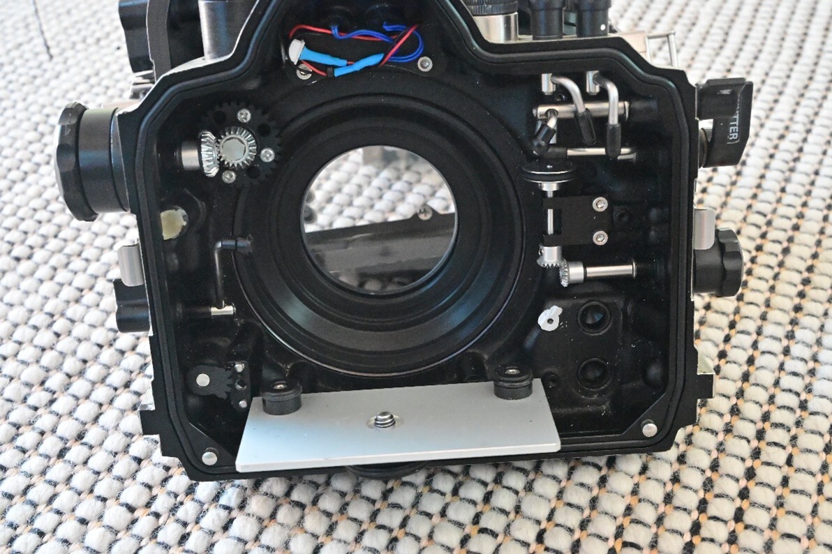

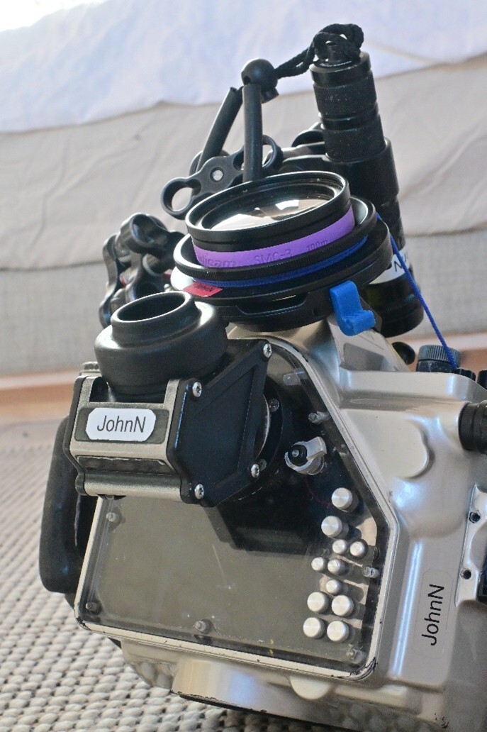

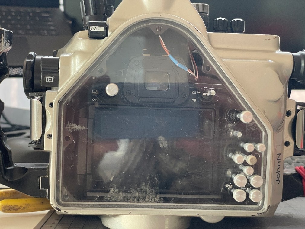

• Learning Fusion 360 CAD software to design the components and CNC work flow to a new level. (See Pic-1 computer screen)  An all new rear plexiglass rear port involving about 85 individual machining operations in 12mm plexiglass. The port has 13 o-ring sealed penetrations, one of which has 5 different diameters over a 12mm depth. Don’t ask how many times I machined that port before getting it right.
Pic-3 Early test of the rear port to get the button positions right
Pic-4 Making chips for the 12mm plexiglass rear port Pic-5 The current rear port after 100 dives

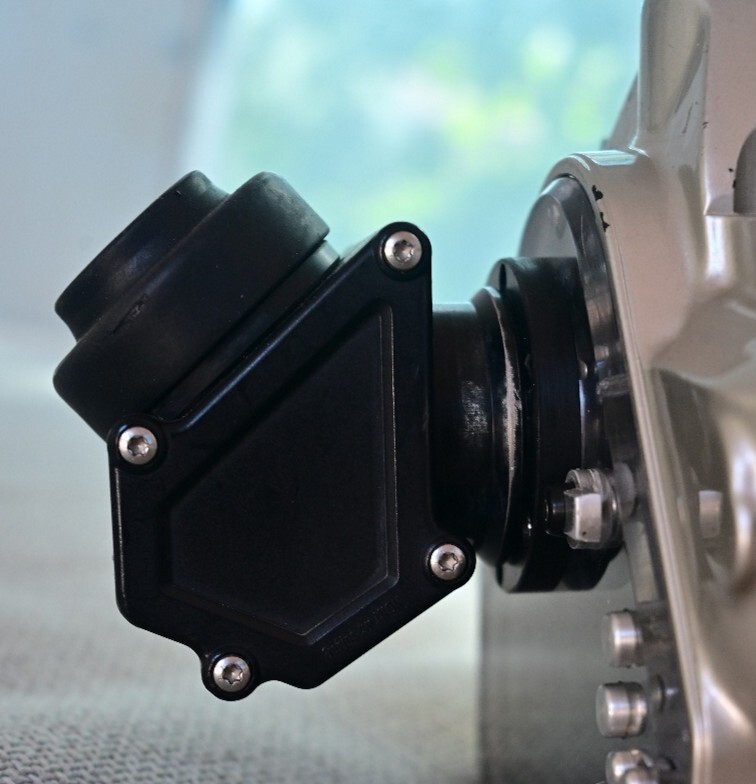

Making an eccentric extension boss for my existing Inon 45 degree viewfinder as the camera viewfinder sits farther back and slightly higher in the housing.
Pic-6 The 45 degree viewfinder with eccentric mount boss

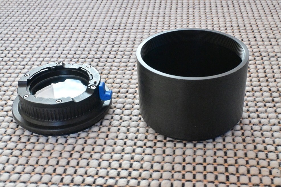

Making several new lens ports, initially using an existing (scratched) port glass taken for an old port. This was OK but too wide to accept the Nauticam WWL-C Bayonet mount without using a complex interface adapter.
Pic-8 Z24-50 Port with bayonet mount and 70mm extension
I then switched to a new port glass, firstly a  65mm diameter x 8mm from Anthis Nexus which was not quite large enough and caused slight vignetting issues at the 24mm end of the zoom range.  I actually bough a whole new port (for a Canon housing) but it was about 4mm too long and there was no way that I could shorten it that much.  So another lump of expensive anodised Japanese CNC machined aluminium hit the scrap bin.
Then a further progression to a Sea Frogs 70mm diameter x 5mm port glass.  The thinner glass removed the vignetting problem and also made fitting the bayonet mount much easier. As you can see from Pic-1 and 8, the port is quite short at 32mm.
I also made a series of port extensions so that I can use the Z105mm and AF-S 60mm macro lens with the same port.  After the first trip with the system I simplified this to a single 70mm one.  If I decide to play with other lenses in the future I can easily make new extensions.

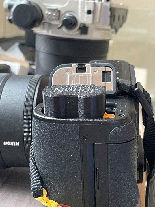

Making a Usb-C bulkhead connector so that I can charge the battery and download pictures without removing the camera from the housing. I love htis addition.
Building a battery module for the camera with double the capacity so that I can do a busy 3/4 dive day without having to change the battery – I was initially shocked by how power hungry a mirrorless camera is compared to a DSLR.
