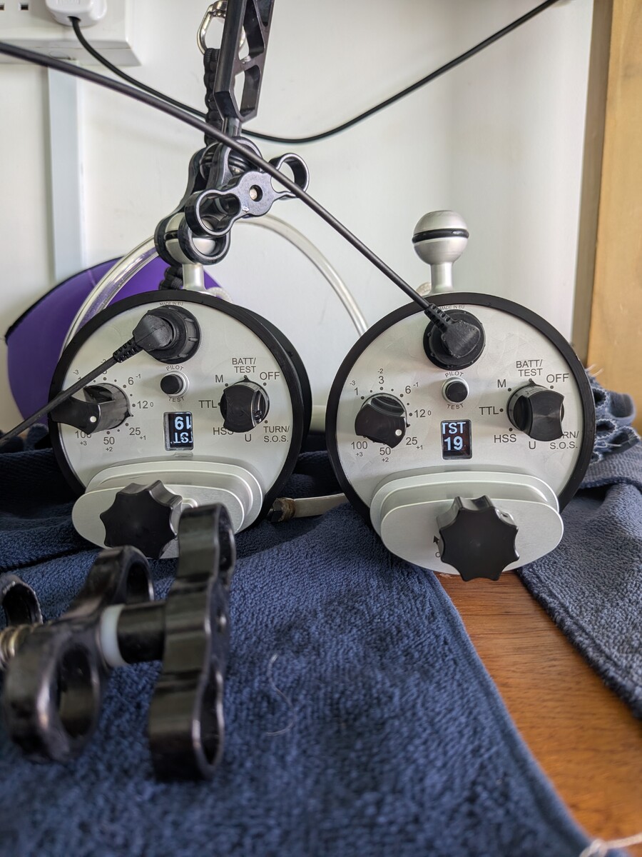

I'm on a dive trip at the moment. Prior to leaving, I did the firmware update at home on my pair of Pro Max 1.
I just noticed on the camera bench that the displays are opposite on each strobe.
I do not feel there are strobe "issues" - just wondered if other folks had experienced similar and what might be the reason.

Hi
I do not feel there are strobe "issues" - just wondered if other's had experienced similar and what might be the reason.
I had the same "problem"
They are a way to change the orientation but... humm I can't remember how I did that...
I've found the mail I received from the Retra support last november
For the rotated display, simply turn the dial to the SOS/TURN position. This will turn (rotate) the display, and the strobe will remember the orientation even after being powered off.
Best regards
Matija S.
