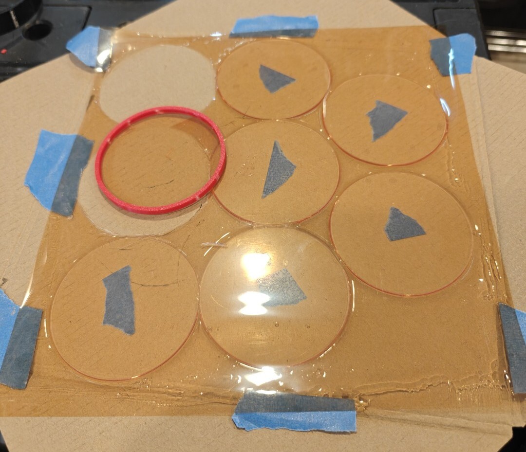

Recently I decided to take another stab at a better and cleaner process to create the filter disks. I laid out a single sheet of gel filter and taped it down to a slab of cardboard. I set aside 8 acrylic disks and peeled the protective film from one side and put a bit of tape on the other, still protected side, so I didn't flip them accidentally. Then I painted the entire gel sheet with a 2-part clear epoxy resin. I placed 8 of the disks on the epoxy-gel surface and pressed hard to get out most of the bubbles.
24 hours later, they are fully set and dry. Using an X-Acto knife I cut out each disk and then had to "shave" the dried epoxy from the edge of the disk. This is more tedious part of the operation. Finally, I peel off the top layer's protective film and slip on the TPU ring.

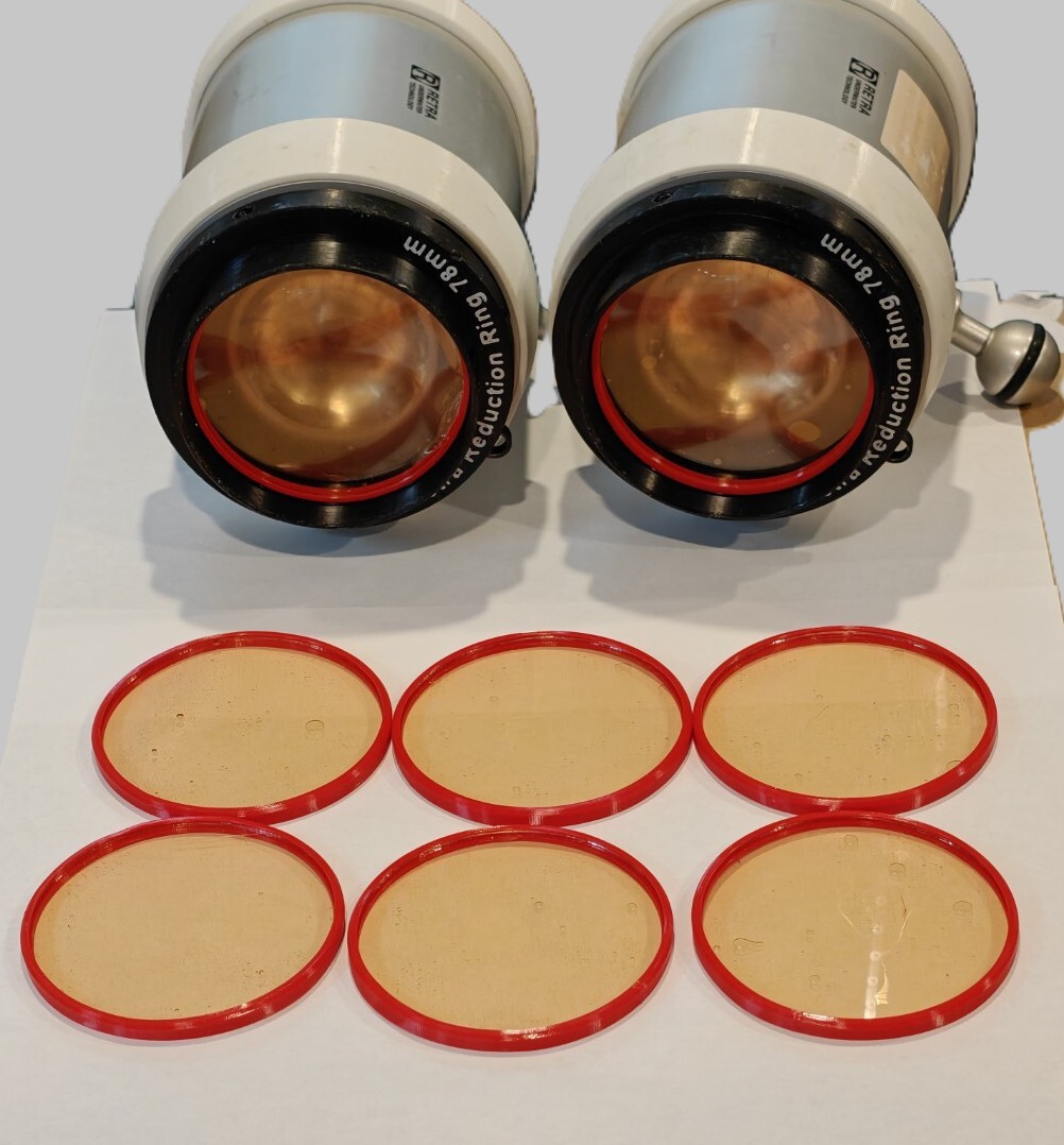

The filter can then be popped into the reduction rings as seen here:
The disks are very durable, and this version is much cleaner that what I managed to make with superglue back in December. My custom Retra and Backscatter Atom reduction rings fully support the filters. My Backscatter HF-1 reduction rings were designed to sit on top of the Backscatter filters, but now I can redesign them to use the bayonet mount rather than the bulkier slip over design I currently have. That will be my next project in the next few days.

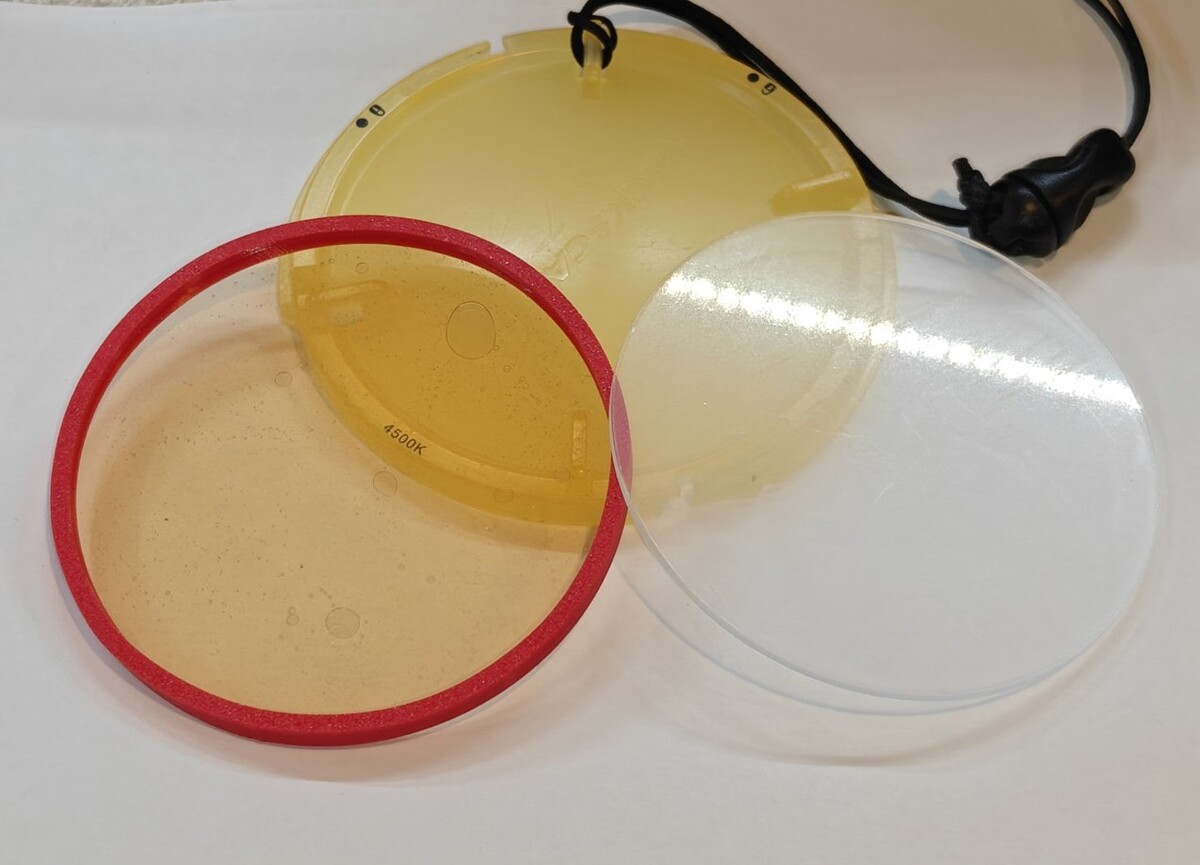

Here is a close-up image of the HF-1 filter, the clear disks, and the final Artisanal filter. Many other filter gels are available if other color casts are desired, even Blue Floro gels.
