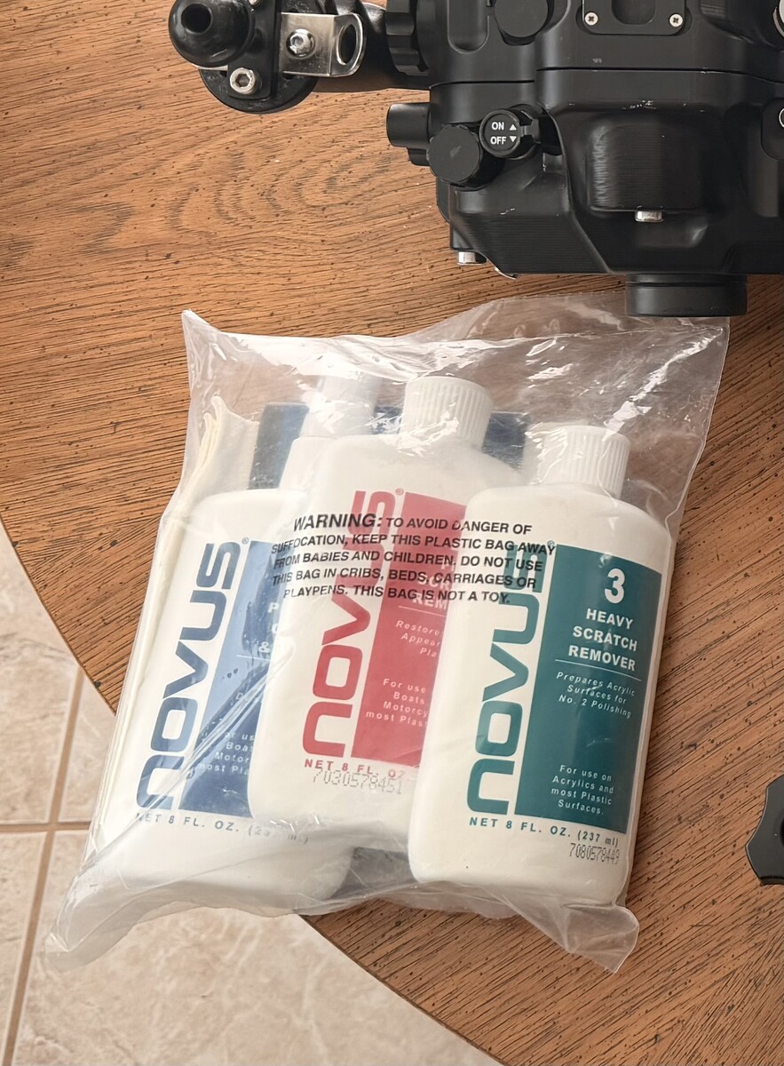

Anyone have experience buffing out scratches on an acrylic dome? The kit I bought used came with some buffing pastes but am curious if anyone has seen good results with this.

I have used the Novus fine product (#2 red) a number of times on my Fantasea WWL. It works OK for fine scratches and buff marks. I have tried the heavy product (#3 green) once on a deeper scratch and it took a good bit of time with the fine product to get back to a polished condition.
