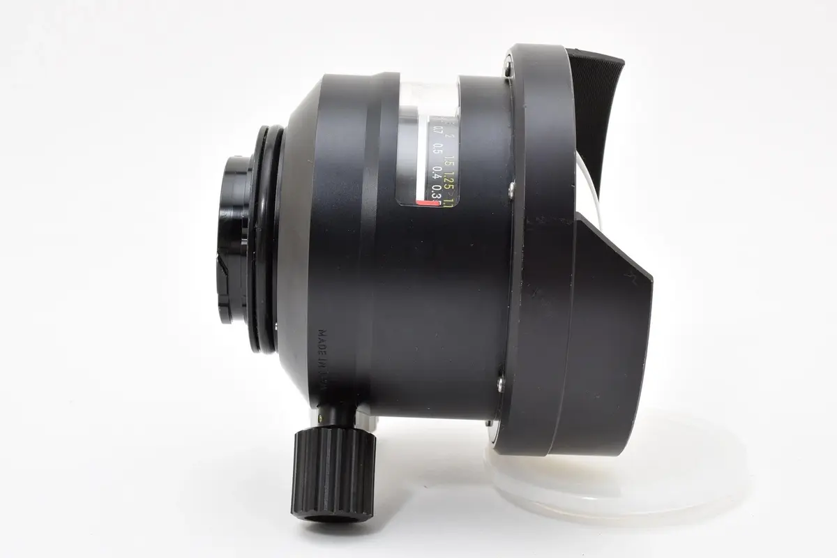

One thing is close to my heart: Nikon Water contact optics. The two most important of these are:
Nikonos 15mm mechanical - can still be used with Sony Mirrorless and a Nauticam port adapter
Nikonos RS 13mm autofocus
As many old timers know, the Nikonos RS 13mm lens died a slow death at the end of the film era, but due to work by dedicated individuals (Andrej Belic, Borut Furlan/Seacam), was brought back to life in the 2010's. The lens was state of the art at the time, and in many ways, still is. Conversion was carried out to adapt the lens to work with Nikon DSLRs, as well as (independently) Red Cinema cameras in Gates housings. This required both electronic conversion for the autofocus and mechanical conversion to mate the lens to the camera/housing system. Andrej and Borut came up with different ways of accomplishing this magic, but both systems work very well. The only hitch is with the aperture linkage, which is mechanical. This does not convert 1:1 with Nikon DSLRs and requires a fudge-factor to set and read aperture values.
As Nauticam introduced its line of water contact optics, the status of this lens came into question, and went from being the only water contact game in town, to a player in an expanding field. It's key feature remains it's very small footprint, which the Nauticam products do not possess.
With the advent of mirrorless cameras, the lens is again threatened with extinction, as the autofocus is based on the Nikon D lenses, which use mechanical autofocus.
I currently own a Nikonos RS 13mm which was modified by Seacam in 2015. I used it with a Seacam housing originally, but never really liked the housing ergonomics. I switched back to Nauticam with a D800, and then a D850 housing and Seacam/Nauticam port adapter (no longer available) which has worked brilliantly.
I have been thinking about a switch to mirrorless, but to be honest, the reason I haven’t is this lens.
 At this point, I would like to invite discussion on this lens, and specifically the recent development by Isaac Szabo (www.isaacszabo.com) of converting this lens to work with Sony Mirrorless. This was recently highlighted by Alex Mustard and Matt Sullivan on their new Youtube platform, the Underwater Photography Show.

Nauticam now has info and photos of their new FCP on their website -https://www.nauticam.com/collections/water-contact-optics-for-nav/products/n120-n100-fisheye-conversion-port-with-integrated-float-collar-fcp-170-deg-fov-with-compatible-28mm-lenses
Looking at the specifications for it:
Size - Outer Diameter x Length (port mount to front) 198 x 136mm / 7.7953 x 5.3543 in.
Weight in air - 3.2kg/ 7.1-lbs.
This is a horse of lens compared to my R-UW 13 setup (main lens body and port) weigh a mere .9kg/2-lbs. Fortunately, the FCP does not require an extension ring with the NIKKOR Z 24-50mm f/4-6.3 Lens.
While it might be something to consider if / when I should decide to go to a Z8; if you are O.K. with dropping $ 6,941.00 USD on it. For me, the option of having my R-UW F mount converted to a Sony E mount and adding a Sony E-Mount Lens to Nikon Z-Mount Autofocus Adapter is looking better and better.
Edited by Walt Stearns
The FCP looks like a great option for those wanting the added versatility of a zoom and circular fisheye. But yes the 13mm offers advantages in image quality, size/weight, and price.
A few measurements of my 13mm port (including hood):
Diameter: 108.6mm/4.28in
Length: 108.3mm/4.26in
Weight: 519g/18.3oz
Note that the weight might be slightly different since I weighed a prototype and the final version has a few minor changes.
