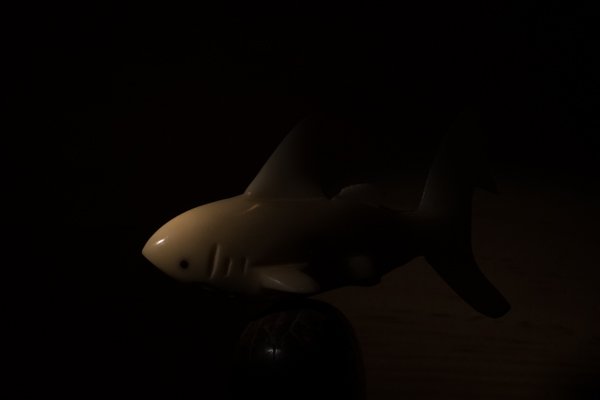

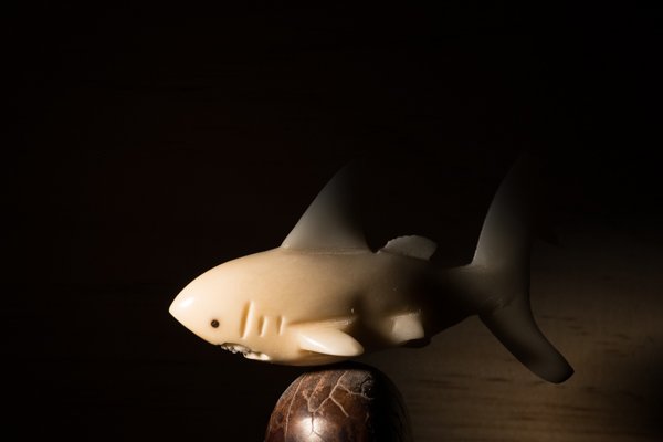

    I've now used the Pro for about 10 dives - all with the LSD. Sint Maarten, where I dive, is usually pretty clear and well-light water and, truth be told, I was struggling a bit to see whether the extra power of the Pro made that much difference. So I ran some tests at home and will post side by side images of the Pro and the Prime and the same power settings:
    All images are shot at 125/f18 ISO 100.
    Top image is always with a Pro-X with LSD - the bottom image is exactly the same with a Prime
    My take: if you are using the small holes on the masks, the Pro version is definitely better. Maybe not so much difference for the wider mask holes.
    And one final thought: shooting at +3 really chews through the batteries. I'd suggest a Supercharger is almost an essential accessory for snoot shooting.
    So first pair of images: Strobes set at +3 and using the smallest, single round hole  of the Retra mask set -
    Edited by TimG
  16. Next two are shot with a +0 setting
  17. Next two at +0 but with the largest mask circle
    Edited by TimG
  18. And finally both at +3
  19. Interesting Tim, cheers for those - coming from  a soon to be Retra owner!
    Mike
  20. No probs, Mike.
    I really rate them highly. Just keep an eye on the batteries! With the Inon Z240s I could reckon on 3 dives a day between charges. Not with the Retras. Two at most.
    I think the Supercharger is a Must-Have if you are using a snoot.
