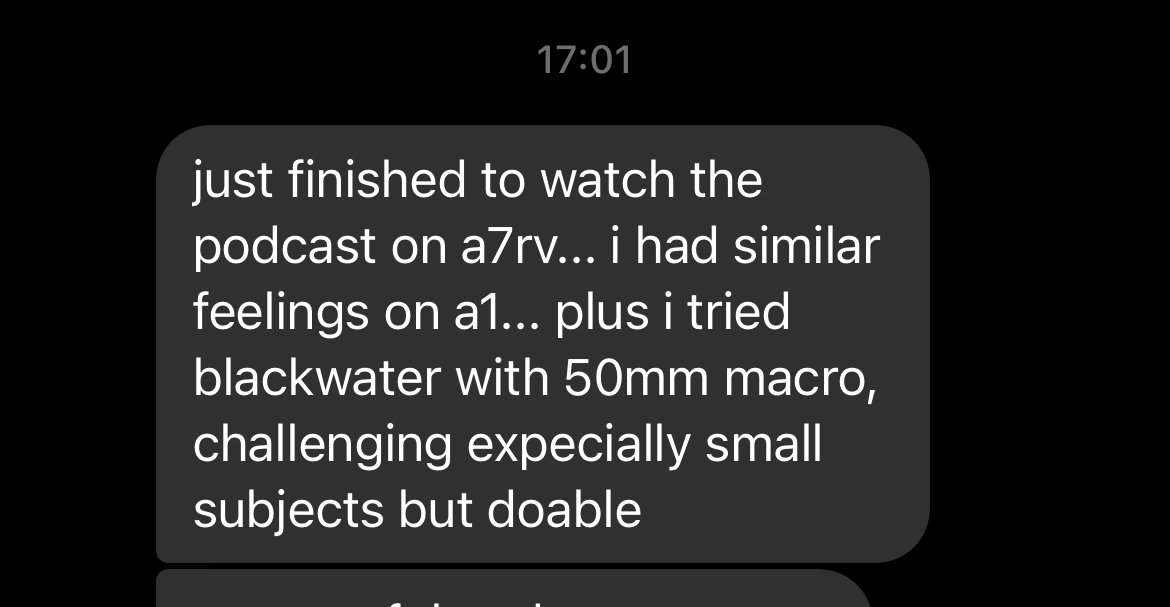

  1. Coincidentally a friend (A1 Marelux ambassador, which kind of erodes his anonymity) sent this about the 50mm
  2. I felt the same way about the Sony A7R III when I first tried BW with the 90mm macro, challenging but doable.

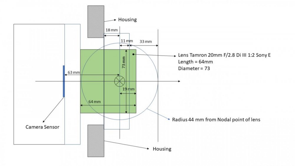

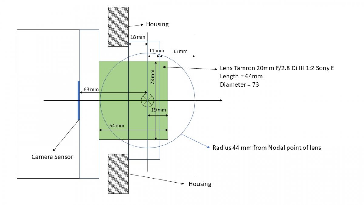

    Re the Tamron lenses, (i have and use the 20mm), i use it only when i want to do Macro with Wide angle. For pure wide angle, the 20mm F1.8G performs way much better, so does the 16-35 or the 12-24.
    But for Macro 1:2 with 95° field of view it is a different story... as long as your dome permits to get close to the subjects, what the 180 dome (and i believe, a N120, with the N100-N120 adaptor?) does not allow.
    Again, we spent some time with Jose at SagaDive to calculate the exact port base length based on specs from the lens. Jose has made for me a N100 100mm Domeport which ensures perfect sharpness with still being able to reach the minimal focusing distance of the lens (12cm) to allow 1:2 Macro. And still being able to light the scene (usually 2x Z-330 and/or MF-1 if snoot)
    The same dome port could be used with the Tamron 24 and the Tamron 35mm because the 3 lenses have exact same dimension and nodal point. The 35 would give you more minimal focusing distance (you gain 4 cm) but at the price of less Angle of View

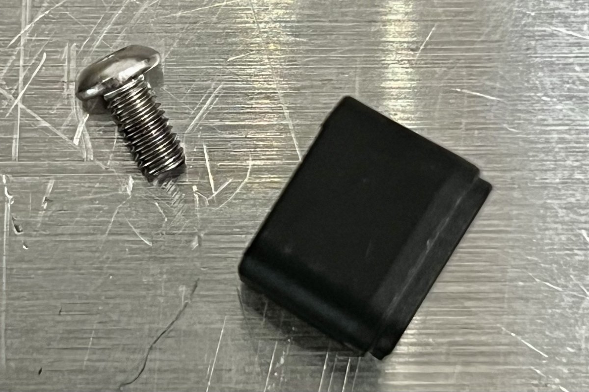

  5. Fun fact for those who own the Nauticam NA-A1 housing for Sony A1 if you remove the small stop on the camera tray (pictured) the A7R V fits perfectly into the housing and the back closes without the chance of damage to the new thicker LCD screen. All of the controls I use for the A1 seem to work on the A7R V as well. Resolves my dilemma about needing a second A1 as a backup.
    I guess this would also mean that you can easily fit the A1 in the A7RV housing - which, when I checked was a bit cheaper than the A1 housing. Could you comment on what controls are compromised, if any?
  7. I guess this would also mean that you can easily fit the A1 in the A7RV housing - which, when I checked was a bit cheaper than the A1 housing. Could you comment on what controls are compromised, if any?
    I think the A1 has a dial more so the reverse is not possible with full functionality
    Well my housing can take 3 cameras now
    So as already pointed out some of the extra cost is the very iffy control for the AF setting bottom and the frame rate control top. None of the A1 housings I have tested do this well and I make those changes with others controls. Also the Mode dial on the A1 while the same 21mm as A7R V has the video and S&Q all on the same dial while on the V they have the still, video and S&Q on the separate dial under the mode dial. As a result they don't quite lineup correctly but also things that can be set by other controls. Also the top control dial for moving the focus point manually does not always work. I can recenter the box with the KO button but getting it to move where you want it is iffy at best. Again this is another control I hardly ever use because the tracking is so much better. Everything else lines up well and as a backup to the A1 I would not miss the the shortcomings at all. Since the A7R V has the larger more complex LCD the housing should have a bit more room so the A1 LCD should not be a problem fitting in NA-A7RV housing on the supplied tray.
    Just as a footnote I think the A7 IV will most likely fit the A7R V housing perhaps better than the A1 and It would be the more likely backup camera to a V.
